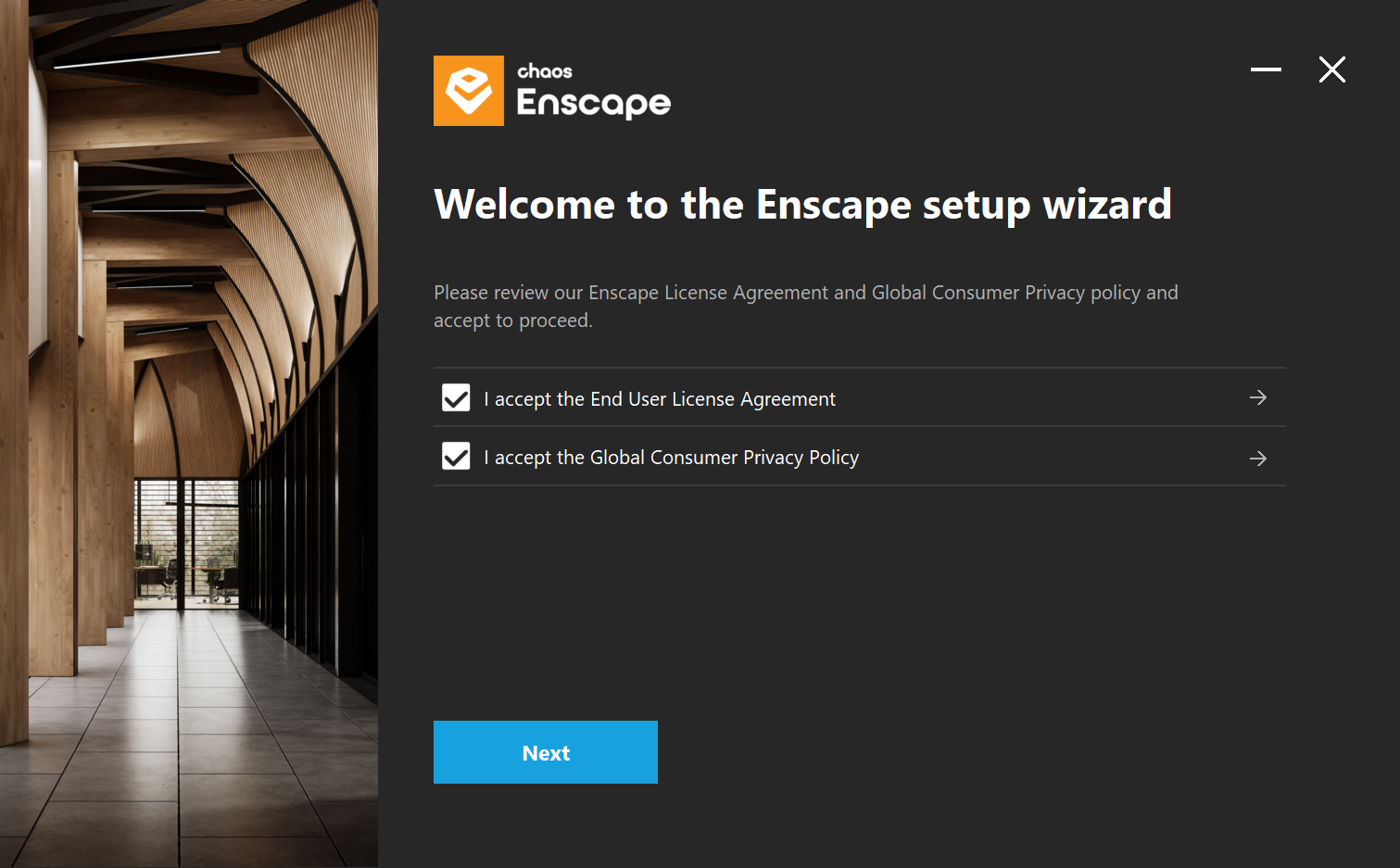

Download the Enscape installation file from download.chaos.com and run it. Accept the agreements, and click Next.
Enscape EULA and GCPP

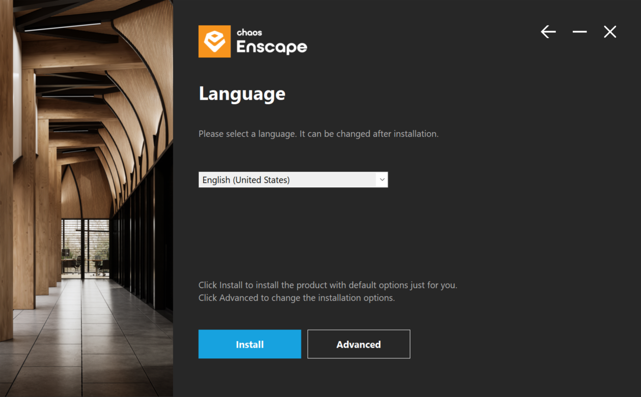

Choose which language you wish to use Enscape with and click Install. The wizard will perform the installation.
Language options

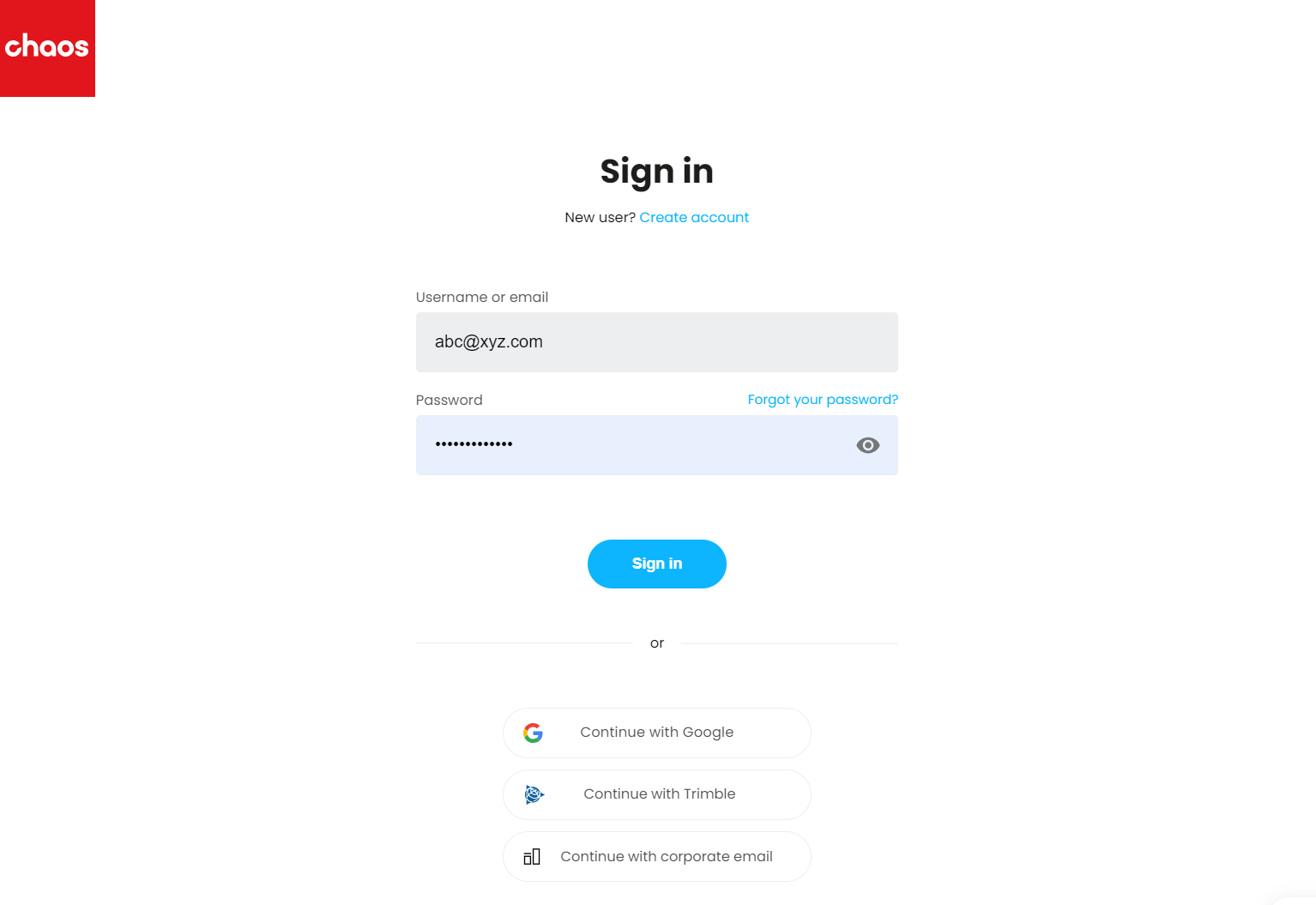

2. Sign in to the Chaos Account that Holds the Enscape Licenses
The installation wizard will prompt you to sign in to your Chaos account.
Click Sign in to be redirected to the Chaos Single Sign-on webpage.
Sign in prompt
Make sure to enter the credentials for the Chaos account holding the Enscape license. You can use an existing Enscape login if you already have one.
Once you’ve signed in, you can close the webpage.

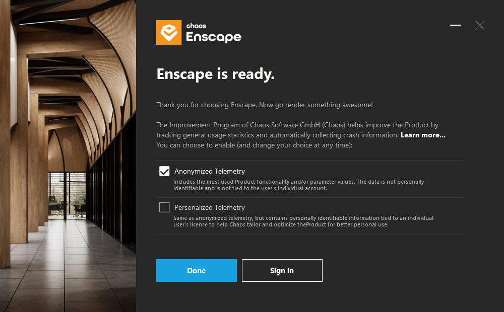

Go back to the Enscape installer and choose your telemetry options. The Enscape installation is complete once you click Done.
Once the Enscape installation is complete and you have signed into your Chaos account, your license is active and can be shared with others if you wish. Keep in mind that only one person can use one license at a time. If you wish to have multiple people working simultaneously, you will need to add more licenses to your account.

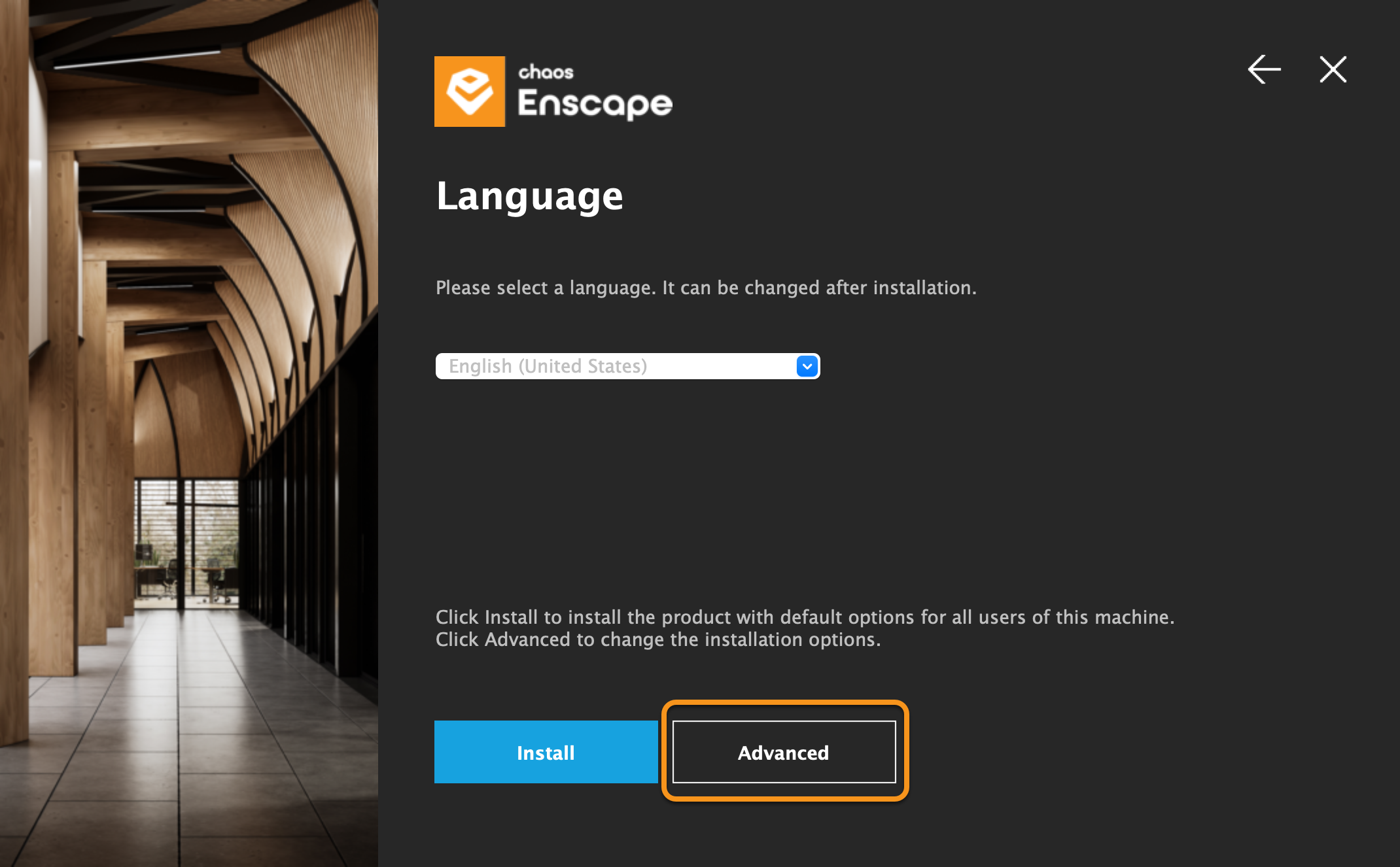

Connecting to an already active Floating license also happens through the Enscape installation wizard. Instead of running a default installation, click Advanced at the Language step.
Advanced Settings

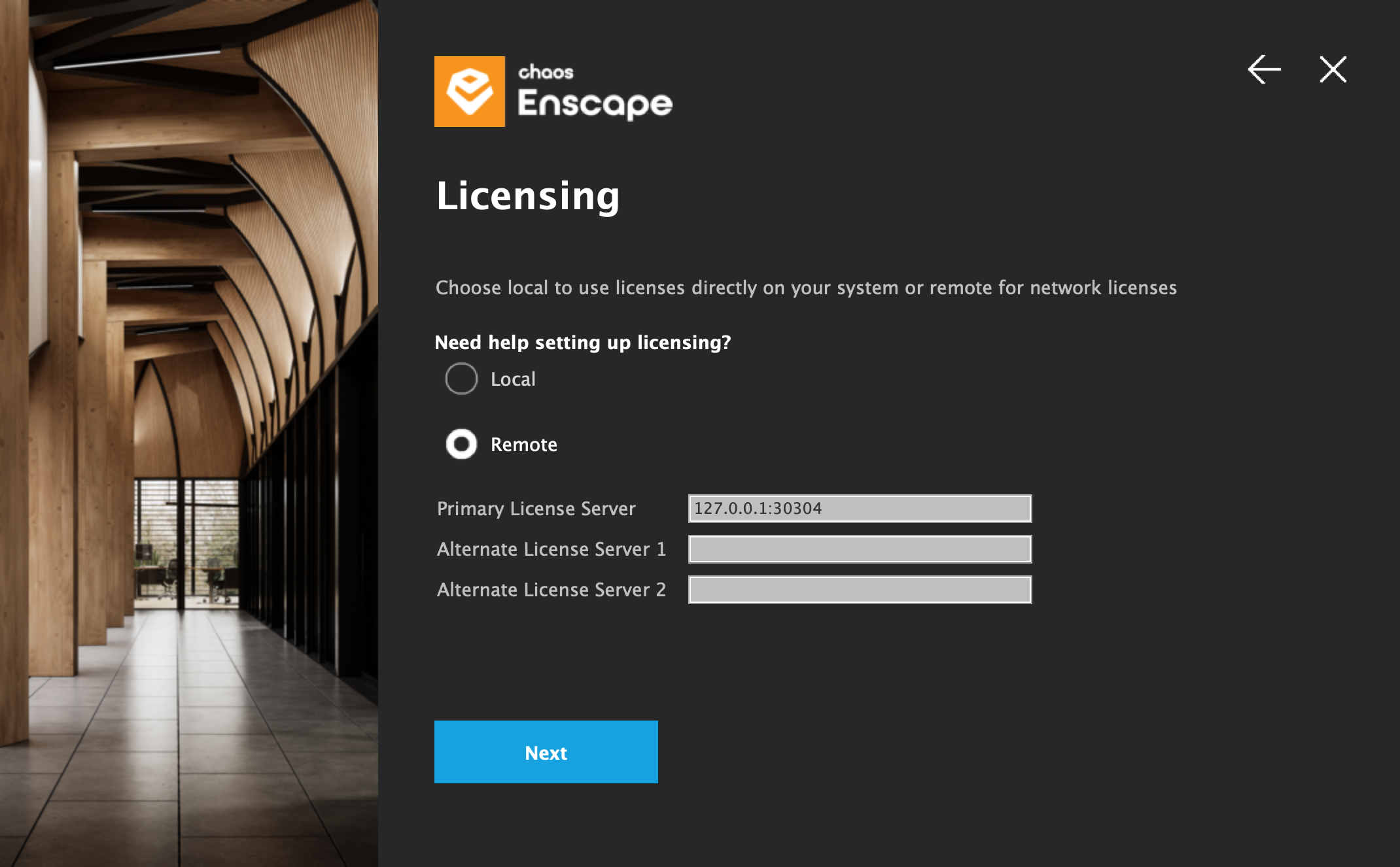

At the Licensing step, select Remote. In the Primary License Server field, enter the IP address of the machine that holds the active Enscape license, followed by the port :30304. See the image for an example. Click Next.
Remote license with definition of License Servers
If your organization is larger and owns more than one active licensed account, you can use the Alternate License Server fields with the IP addresses of the alternative license-holder machines. In case the first one does not respond, the second (or third) provides a backup, avoiding any downtime.

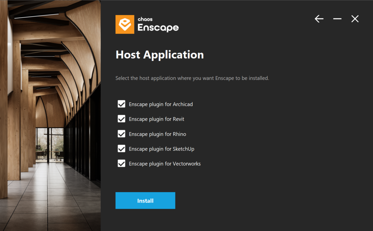

3. Choose your CAD Software
In the next step, choose the CADs you wish to install Enscape for. Click Install and leave the wizard to do the rest.
Choose your CAD(s)

At the end of the installation, choose your telemetry settings and click Done.
You do not need to sign in, as you are already connected to an active license.
You can now use a Floating Chaos Enscape license. You can check its status by selecting the Manage License link in the Chaos Account window within Enscape’s interface. Alternatively, you can type the host’s IP address followed by :30304 in any web browser.
Enscape is ready
