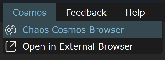

||Menu|| > Cosmos > Chaos Cosmos Browser
||Toolbar|| > Chaos Cosmos icon

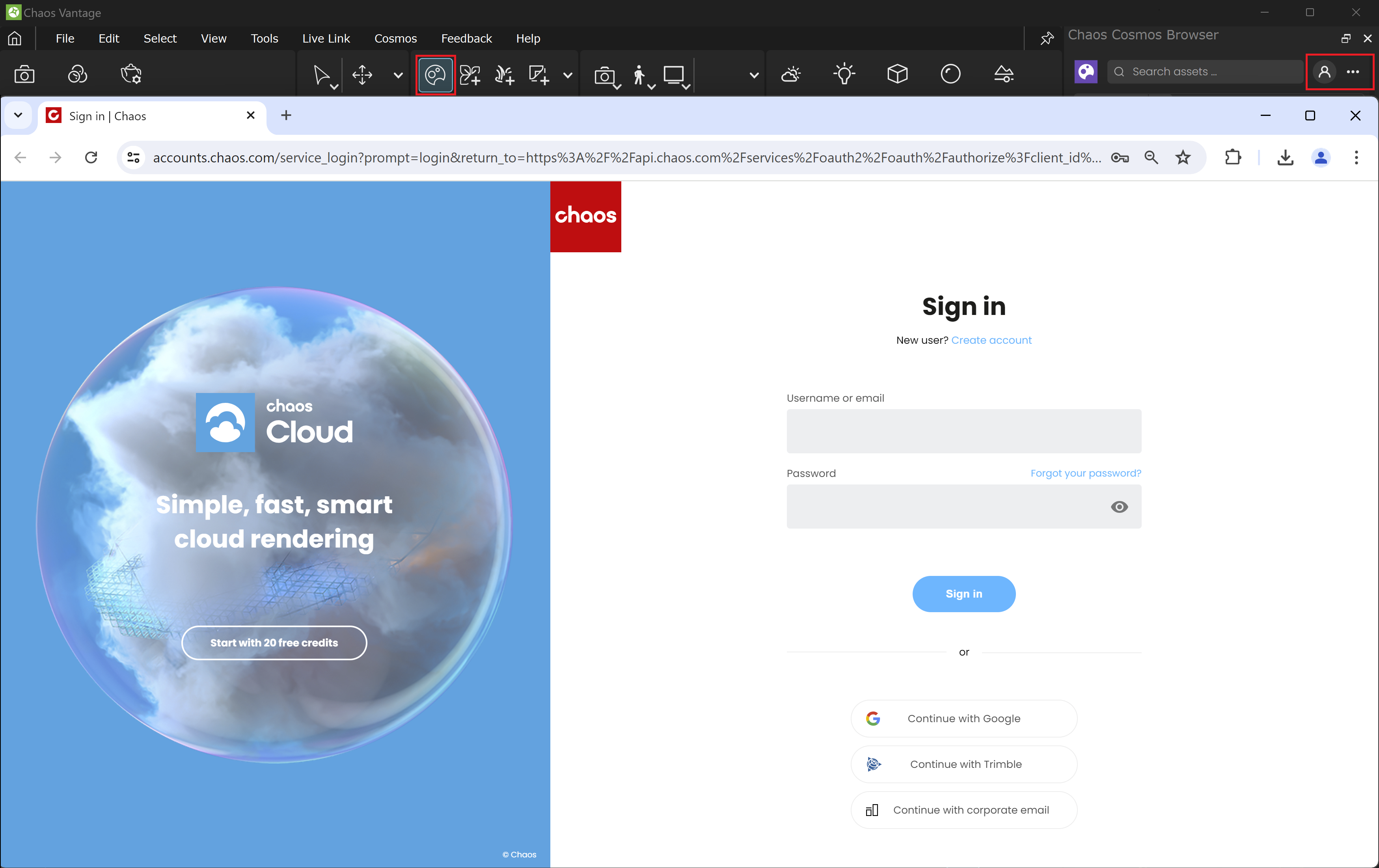

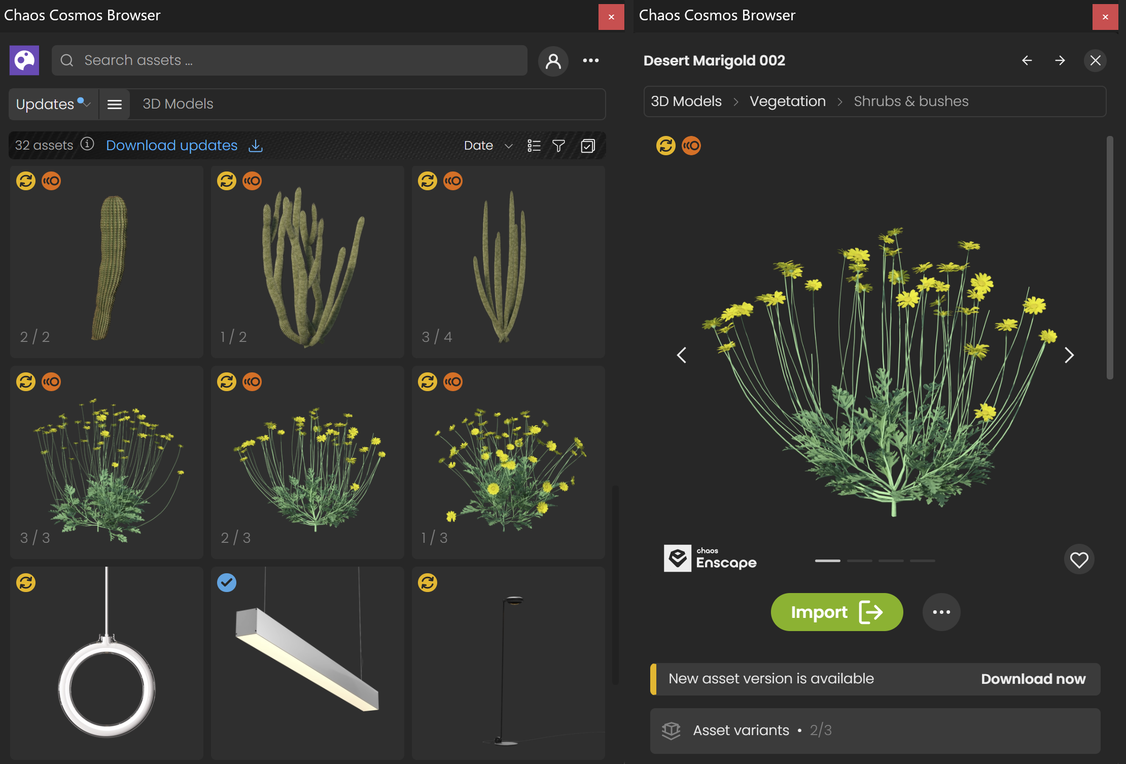

1. Open the Chaos Cosmos Browser and sign in.
2. Press the Sign in button at the top-right corner and enter your Chaos credentials.

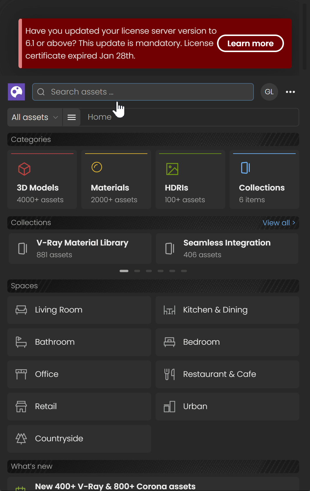

3. Use the buttons at the top or use the search tab to find assets. If you press one of the 3D Models, HDRIs, and Creators buttons, you can additionally choose between different categories and filters for date, popularity, color, and space. The option to Show downloaded only is also available.

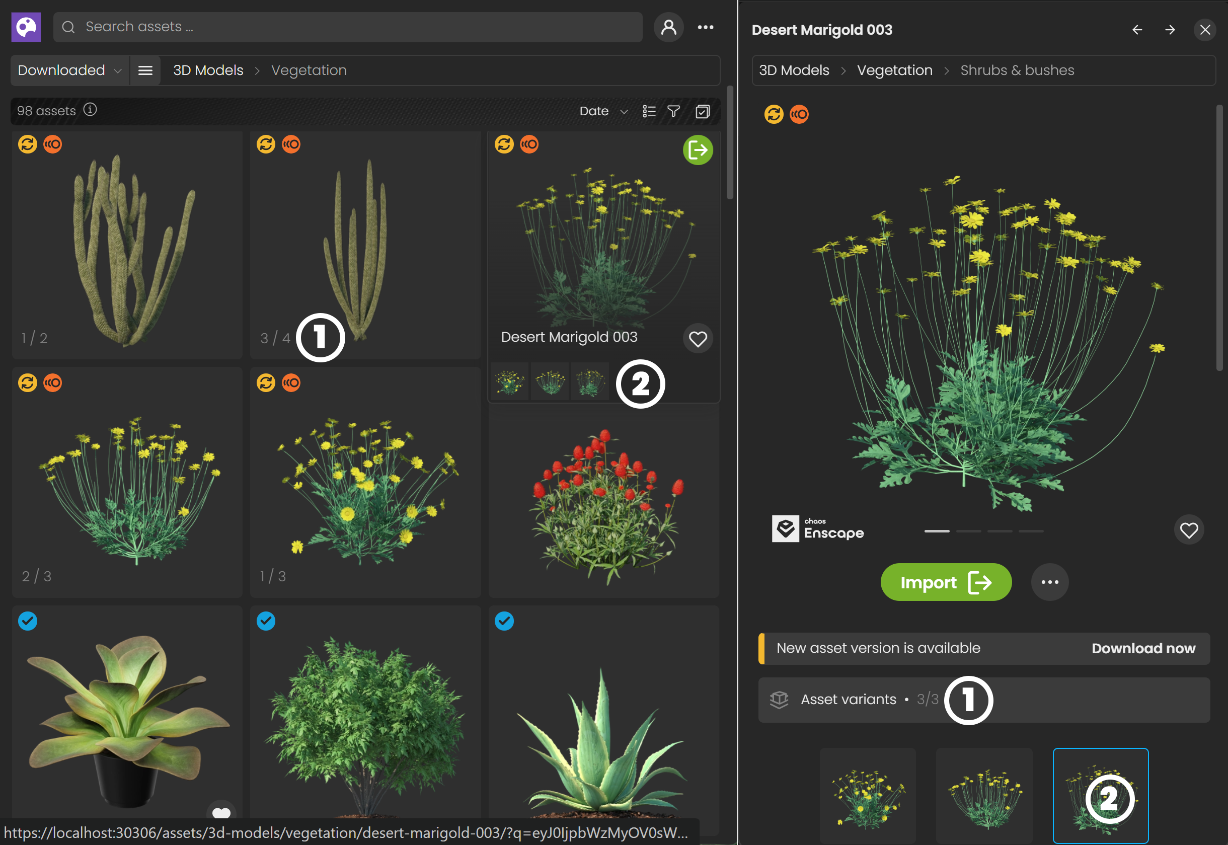

4. Download the asset of your choosing.
4.1. Hover over it and click on the blue download button at the lower-right corner.
4.2. Click on the asset to open a popup window and click on the Download button in the top right corner.
Additional information regarding the creator, the category/space/color of the asset, and other useful information are displayed in the popup window. Other connected assets can be filtered by clicking on any of the additional information parameters.
5. Once the download is complete, a pop-up window will state that the asset is downloaded successfully.

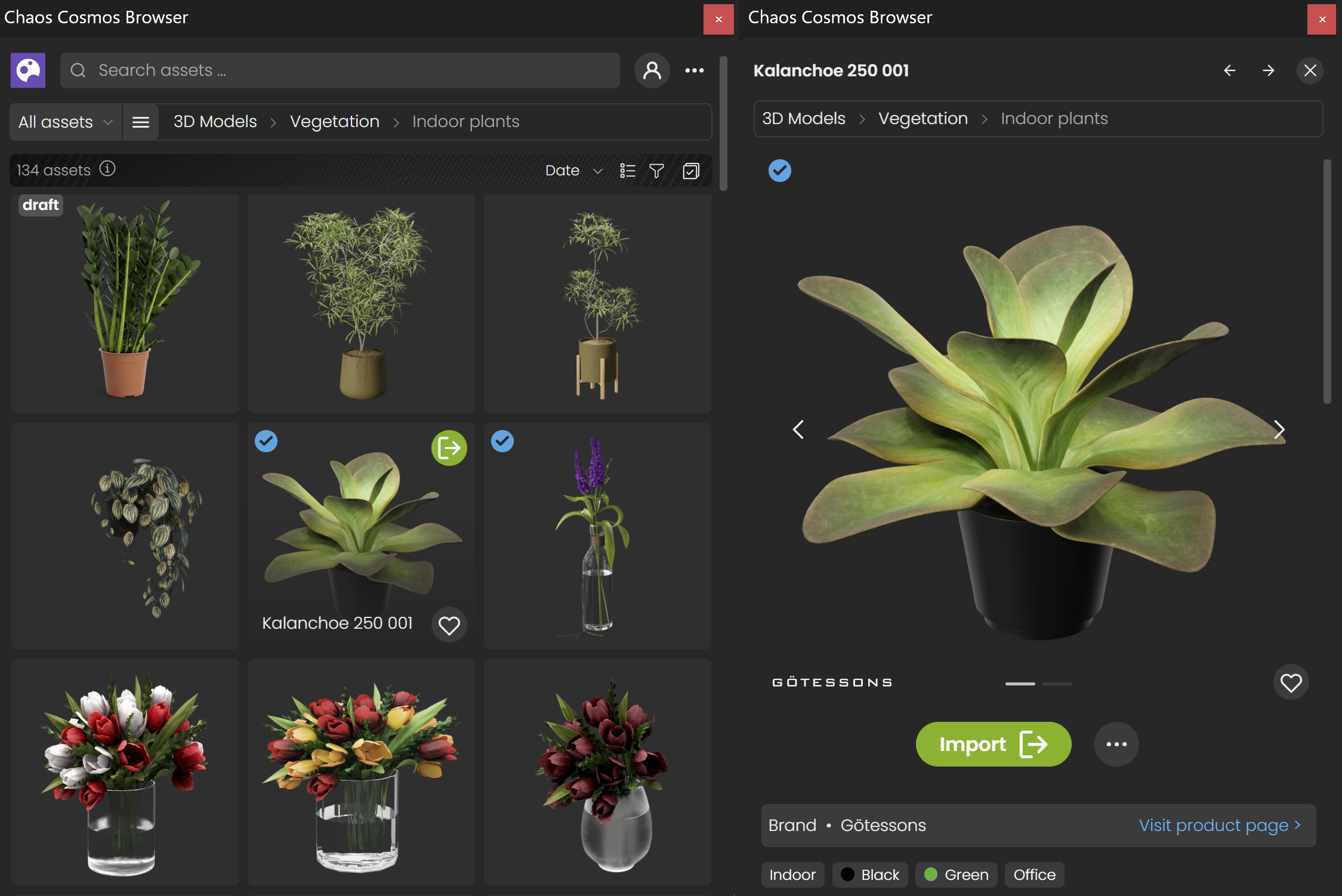

6. Import the asset in the scene:
6.1. 3D Models
6.1.1. Use drag&drop in the viewport. That starts the component placement tool and allows you to place the asset wherever you want in the scene with proper surface alignment. Holding Shift while placing will ignore the surface normal and place the asset without rotating it.
6.1.2. Use the green import button in the lower right corner of the asset.
6.1.3. Click on the asset to open a popup window and click on the Import button in the top right corner.
If multiple DCCs are opened, a list for available target applications will popup. Choose the appropriate target icon to import the asset

Cosmos assets get updated over time. When an update is available an update available label appears. You can download the new versions from within the Chaos Cosmos Browser.
Click on the labeled asset to open a popup window and click on the Download update text in the bottom.
