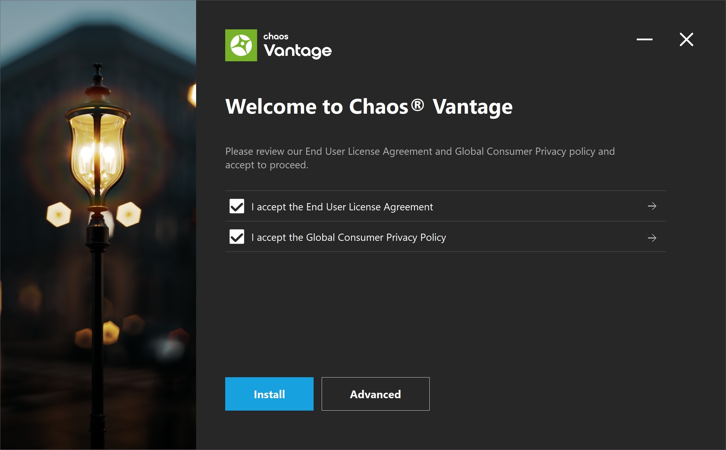

1. Upon the start of the installation, Windows may ask you for permission to run the installer with administrator privileges. Please confirm.
2. You are presented with the Chaos Vantage licensing agreement. Please take a moment to review the agreement. Check the I accept the Agreement checkbox and click Install to proceed with standard installation.
If you need to customize your Chaos Vantage installation, press the Advanced button.
The Install option enables Telemetry by default, uses the localhost for licensing and installs the software in a default directory.
Click here to see the Advanced installation options...

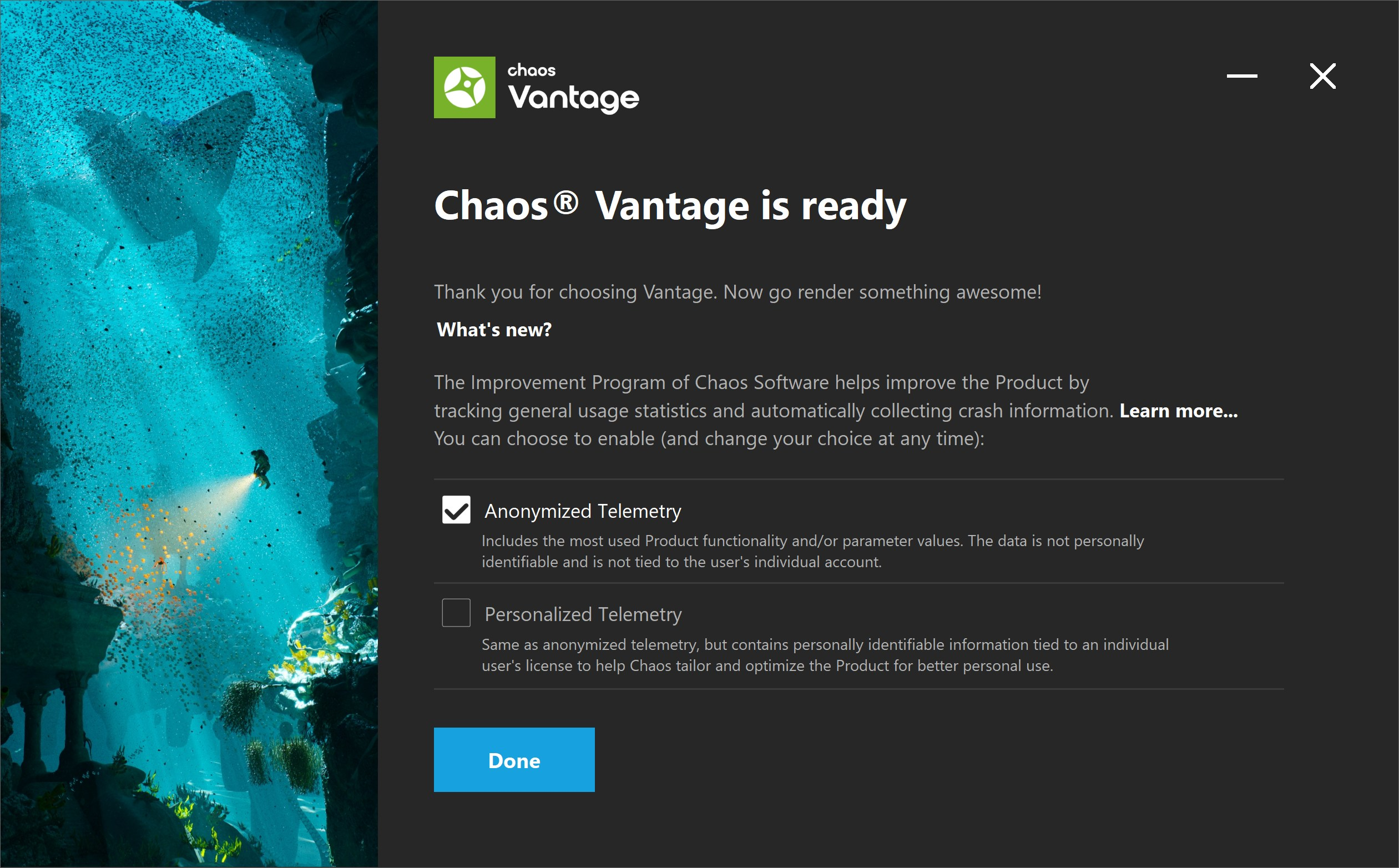

If you are installing Chaos Vantage for the first time and use the Advanced installation, you are presented with a Help make Vantage even better screen, where you can specify whether to Share Analytics Data
Otherwise, the Feedback program is activated by enabling Help make Vantage even better checkbox, available upon pressing the Advanced button of the installer. For more information, see the Chaos Feedback Program page.

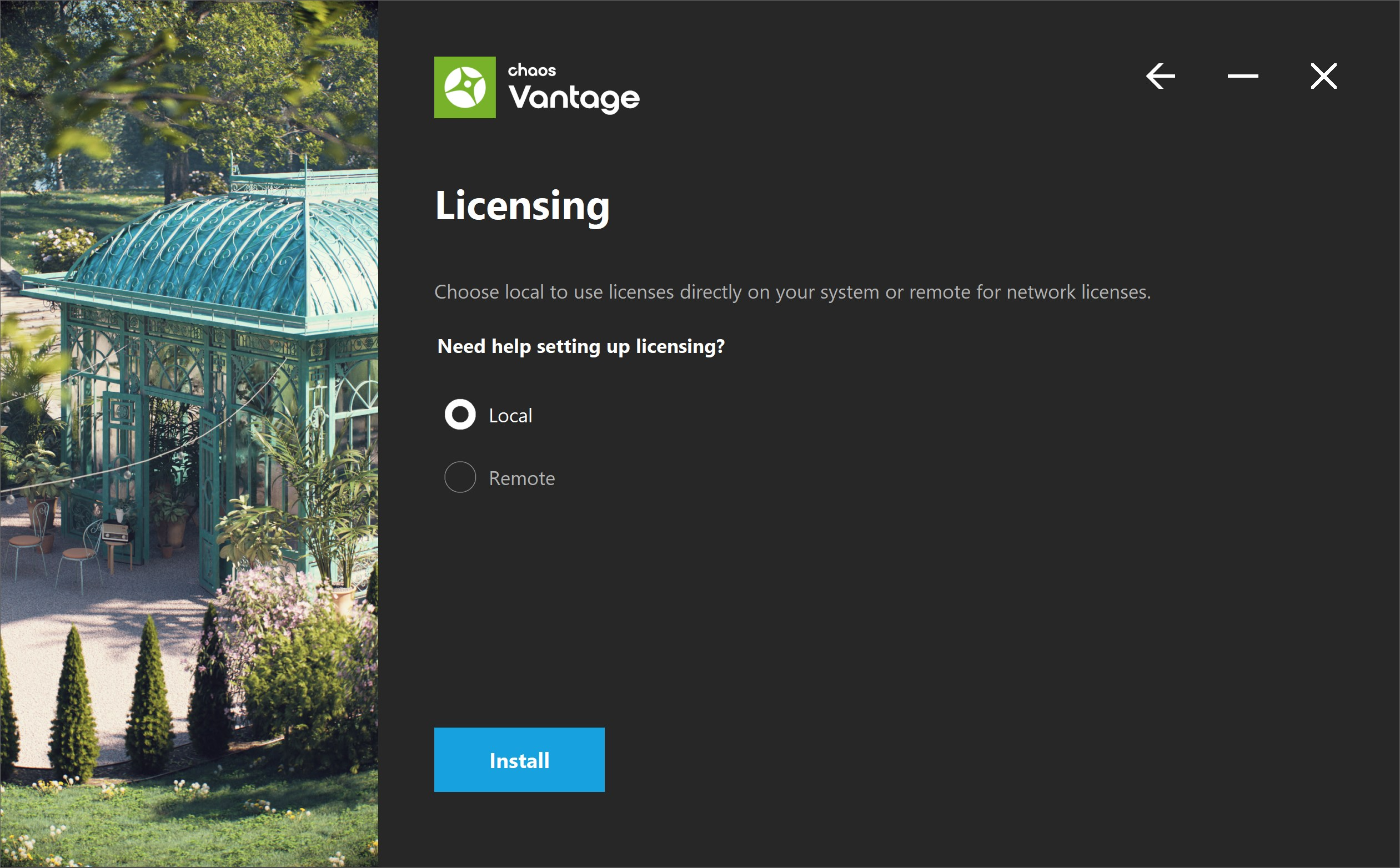

2b. In this step, you can specify whether the Chaos group license server will run locally or on another machine.
If you select the option Remote you have to fill in the IP address of your Chaos group license server in the field Primary License Server. Please leave the port 30304 unchanged. An Alternate License Server is used when the primary one does not respond.
See the Licensing page for more information.
2c. When ready click the Install button. If the installer detects previous versions of Chaos Vantage, they are automatically uninstalled.

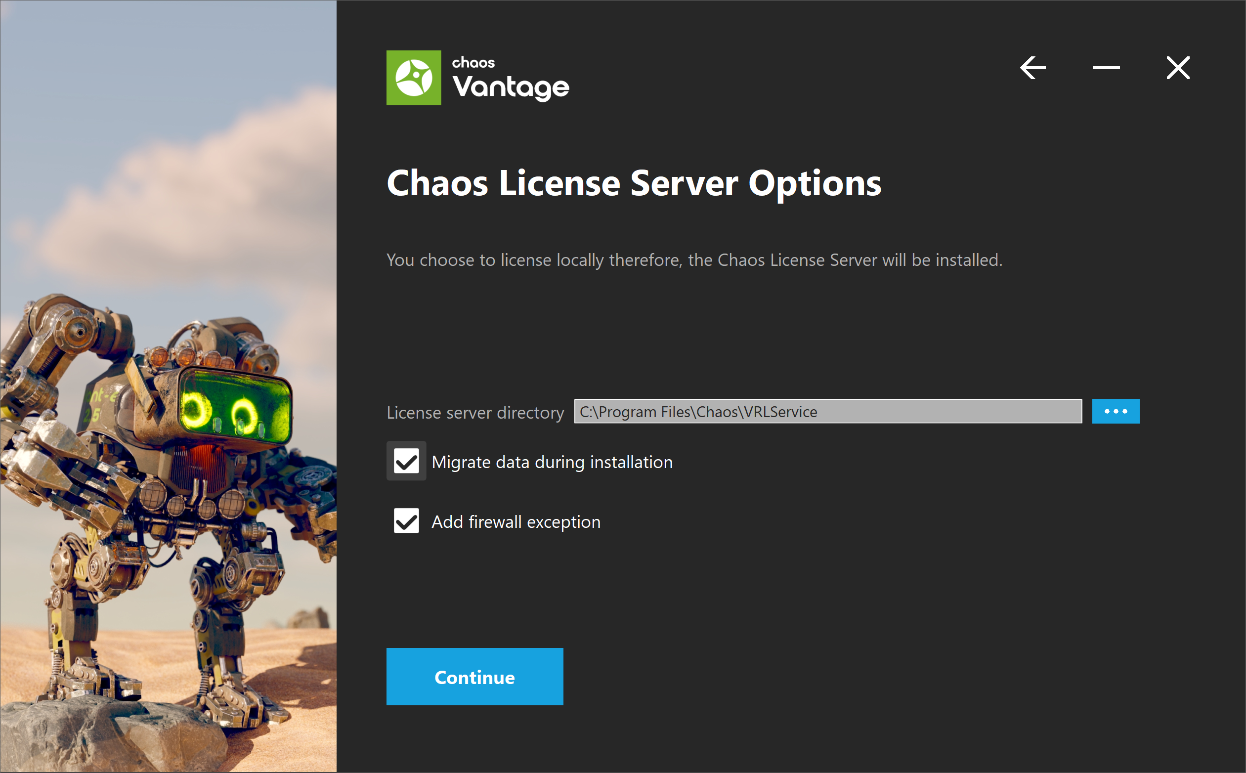

3. If you are installing a Chaos product for the first time and chose to use the license server locally, here the Chaos License server installation option is presented.
At this step you can choose the license server directory.
The Migrate data during installation option transfers all of your settings made with older versions of the License Server, such as enabled dongle subsystem, proxy settings, etc. Disabling this option will install License Server with all settings at their defaults and any custom settings from the previous installation will be lost.
Add firewall exception option allows the default licensing port (TCP 30304) in the firewall. If you disable it at this step, you will need to manually add firewall exceptions later.
4.  If the installation is successful, you will get this screen. Press the Done button.
