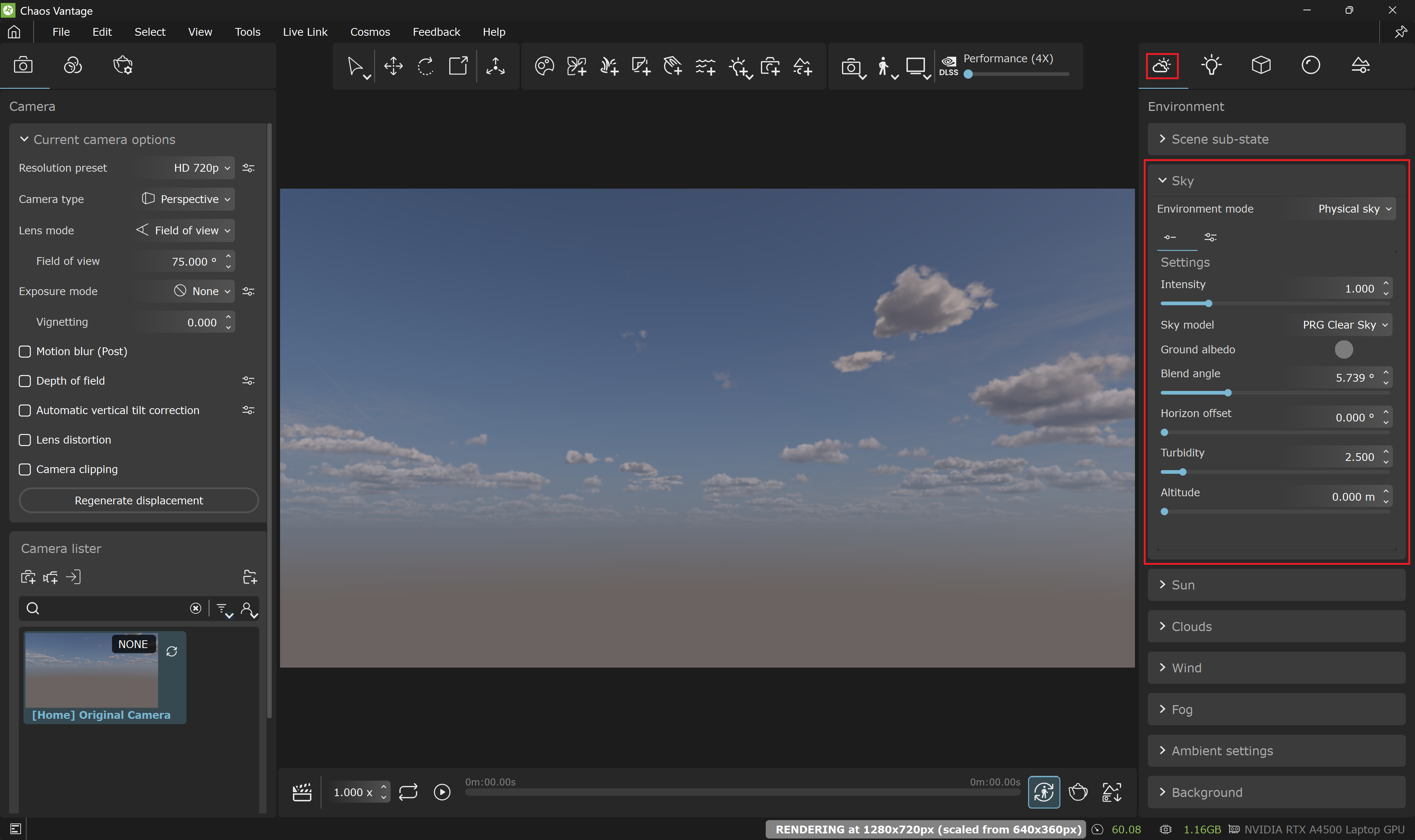

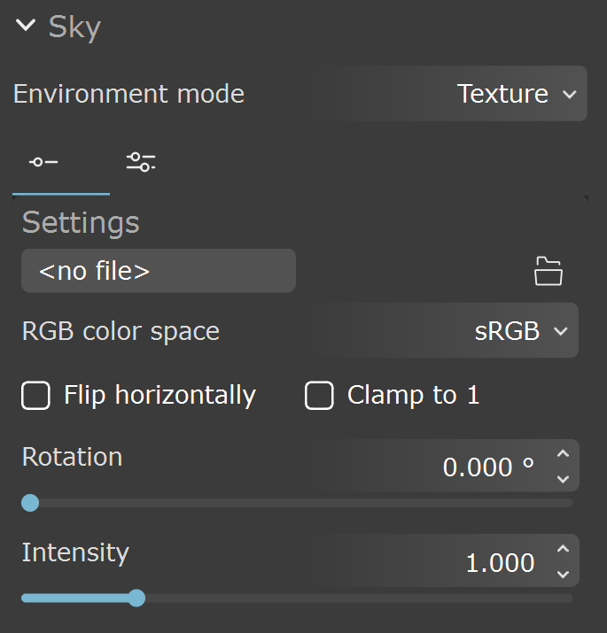

The Sky rollout offers properties for the environment setup. It is located under the Environment tab in the right-hand side panel.
The Sky settings are grouped into basic and advanced settings tabs.
Settings tab – Contains general settings for configuring the environment mode and parameters.

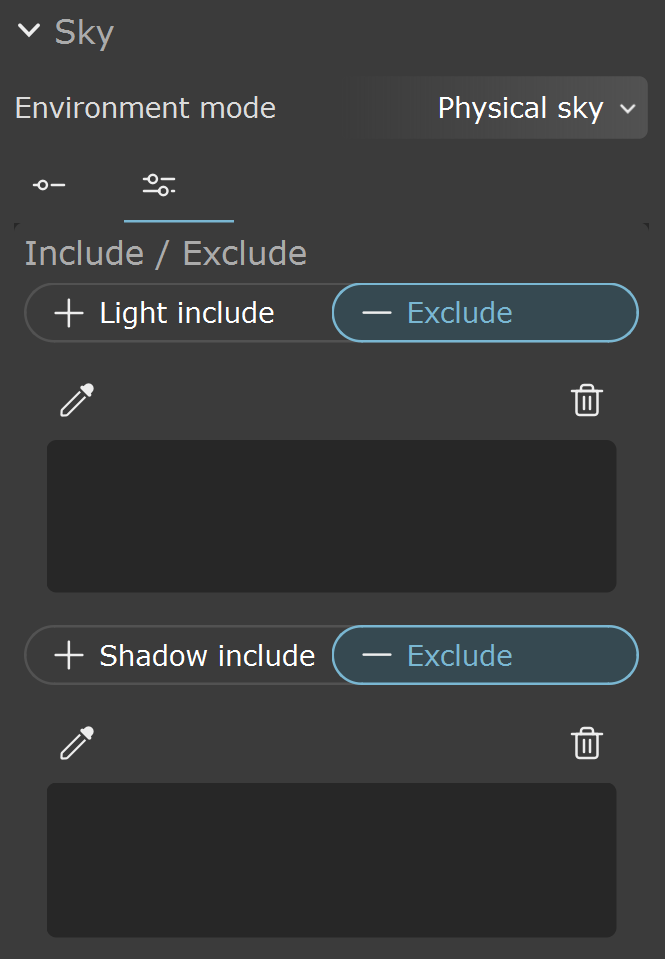

Include/Exclude tab – .Contains include/exclude lists of objects that are affected by the environment.
Environment mode – Specifies the mode which will be used for scene lighting:
Texture – Enables the use of an environment texture for lighting.
Solid Color – Enables the use of a solid color for lighting.
Physical Sky – Enables the use of a sky texture for lighting. Available only when the imported .vrscene has VRaySky texture.
Texture Mode
The following parameters are available for Texture Mode.

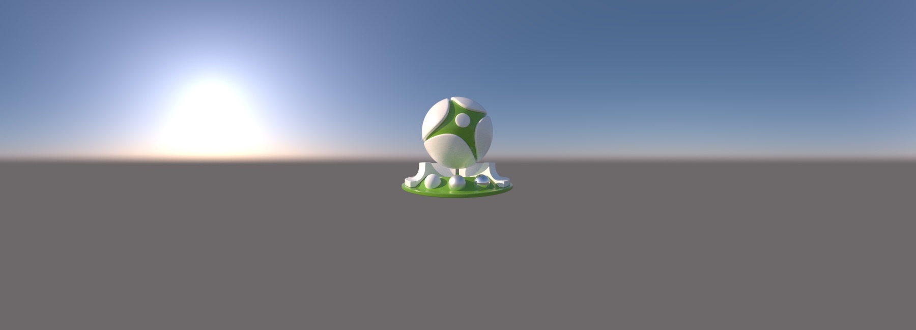

Load environment – Loads an image for Environment.
RGB color space – Specifies the RGB color space of the environment texture.
Auto – The color space is deduced by the file's name.
Raw – No transformation is applied to R|G|B colors.
sRGB The loaded image is considered in sRGB color space.
ACEScg – The loaded image is considered in ACEScg color space.
Flip horizontally – Flips the environment image horizontally.
Clamp to 1 – Clamps the colors of the Environment texture to a value of 1.
Rotation – Specifies a rotation angle in degrees for the Environment texture.
Intensity – Specifies the intensity of the Environment lighting.

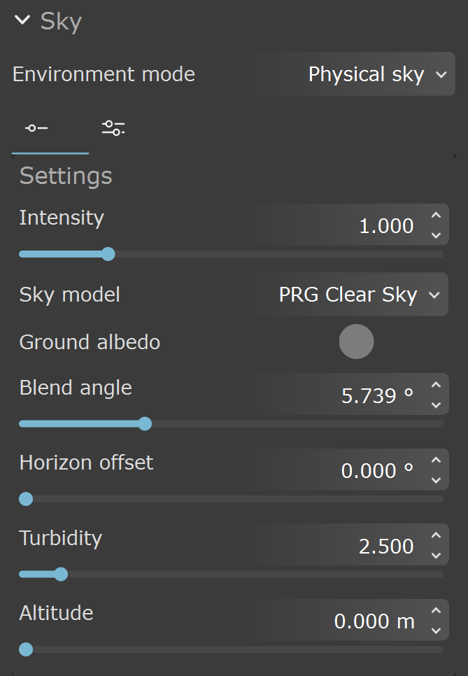

Physical Sky Mode
The following parameters are available for Physical Sky Mode.
Sky model – Specifies the use of location coordinates, date and time of day to control the sun position. See the Sky Model examples below.
Preetham et al. – The sky procedural texture is generated based on the Preetham et al. model.
CIE Clear – The sky procedural texture is generated based on the CIE method for a clear sky.
CIE Overcast – The sky procedural texture is generated based on the CIE method for a cloudy sky.
Hosek et al. – The sky procedural texture is generated based on the Hosek et al. model.
PRG Clear Sky (old) – The sky procedural texture is generated based on the PRG Clear Sky model (prior to V-Ray 7) which has enhanced sunrise and sunset sky.
PRG Clear Sky – The sky procedural texture is generated using the updated PRG Clear Sky method. The updated PRG Clear Sky allows for rendering the sky at various observer altitudes, up to several kilometers controlled by the Altitude parameter. It also supports rendering of nautical twilight effects with sun positions up to 12 degrees below the horizon. Additionally, it features enhanced turbidity control, enabling the rendering of sky conditions with turbidity values ranging from 1.81 to 4.89. See the PRG Clear Sky examples below.
Ground albedo – Sets the color of the ground.
Indirect hor illum – Specifies the intensity (in lx) of the illumination on horizontal surfaces coming from the sky. This parameter is enabled when one of the CIE Sky Models(CIE Clear, CIE Overcast) are selected.
Blend angle – Specifies the angle in degrees where blending will occur between the horizon line and sky. Values close to 0.0 produce a sharper horizon line, while larger values produce a softer horizon line. See the PRG Clear Sky - Blend Angle examples below.
Horizon offset – Allows you to manually lower the horizon line. See the PRG Clear Sky - Horizon Offset examples below.
Turbidity – Determines the amount of dust in the air, which in turn affects the color of the sun and sky. Smaller values produce a clear, blue sky and sun similar to what is seen in rural areas, while larger values make the sun and sky more yellow and orange. See the PRG Clear Sky - Turbidity examples below.
Altitude – Controls the observer's altitude in meters. As the altitude increases, sky clarity improves, and the horizon line becomes less defined. See the PRG Clear Sky - Altitude examples below.
Ozone – Affects the color of the sun light. Available in the range between 0.0 and 1.0. Smaller values make the sunlight more yellow, while larger values make it bluer.
Include/Exclude
Light include/exclude – Specifies a list of objects to be included in or excluded from illumination. Objects are added to the list using the Pick scene object(s) tool.
Shadow include/exclude – Specifies a list of objects to be included in or excluded from shadow-casting. Objects are added to the list using the Pick scene object(s) tool.
Pick scene object(s) () – Selects objects and adds them to the include/exclude list.
Delete selected object(s) from the list () – Removes the selected objects from the include/exclude list.

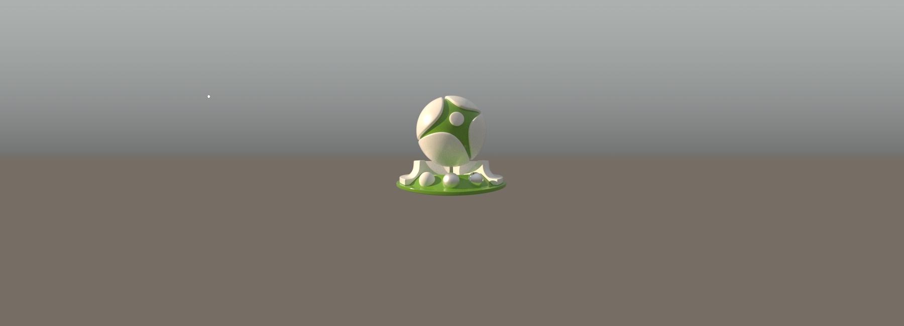

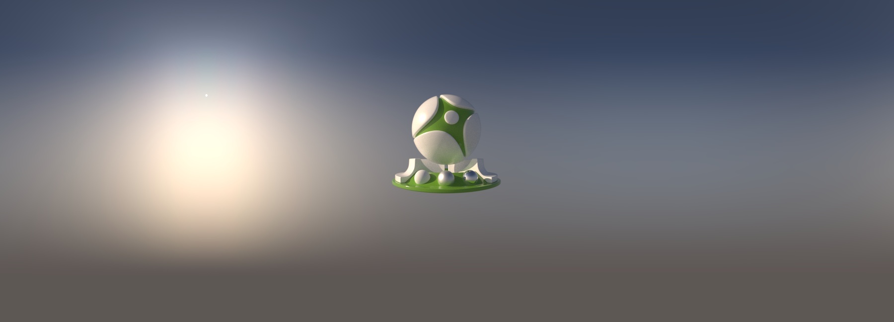

Sky Models
The images below show the different sky model types. Default values for VRaySky have been used.
Preetham et al.
CIE Clear
CIE Overcast
Hosek et al.
PRG Clear Sky Old
PRG Clear Sky

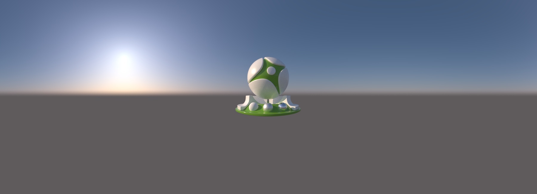

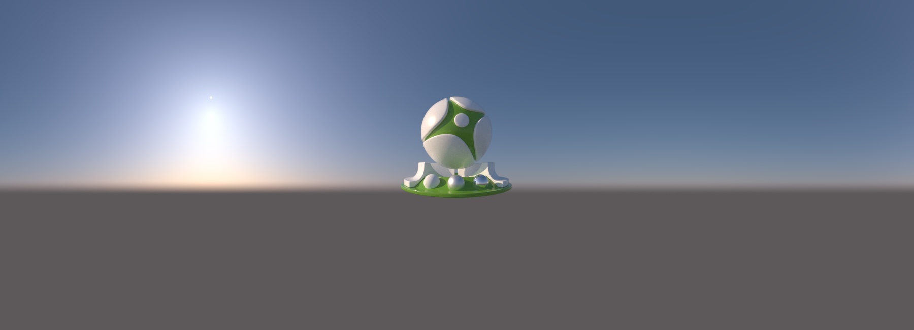

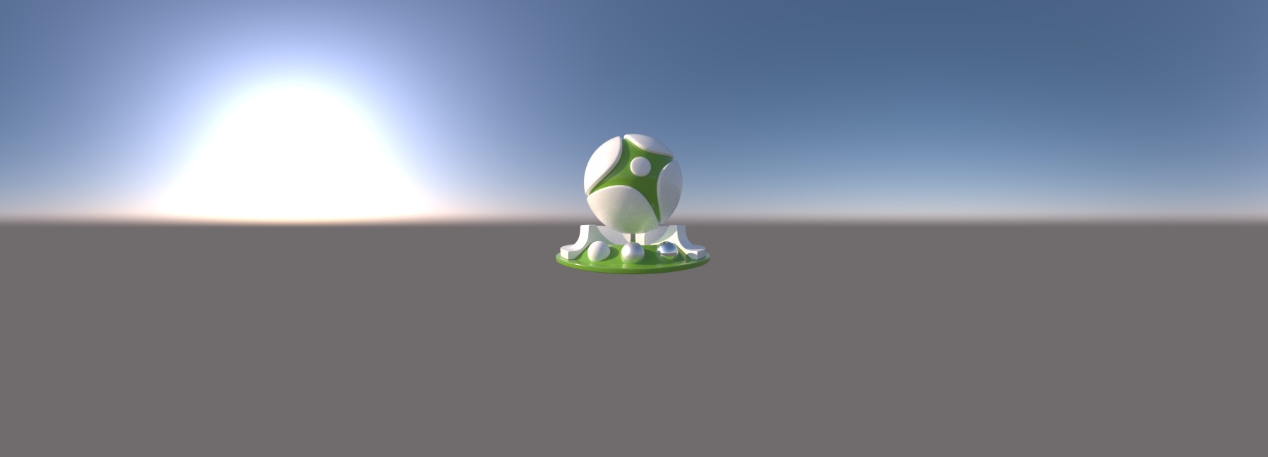

This example shows how the Altitude values affect the visualization of the sky. Higher Altitude values result in better sky clarity and a less defined horizon line.
01_PRGNew_Altitude-0
Altitude = 0
02_PRGNew_Altitude-1000
Altitude = 1000
03_PRGNew_Altitude-2000
Altitude = 2000
04_PRGNew_Altitude-10000
Altitude = 10000
05_PRGNew_Altitude-15000
Altitude = 15000

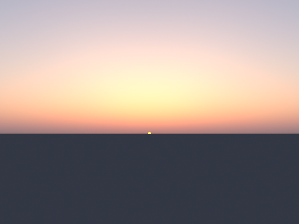

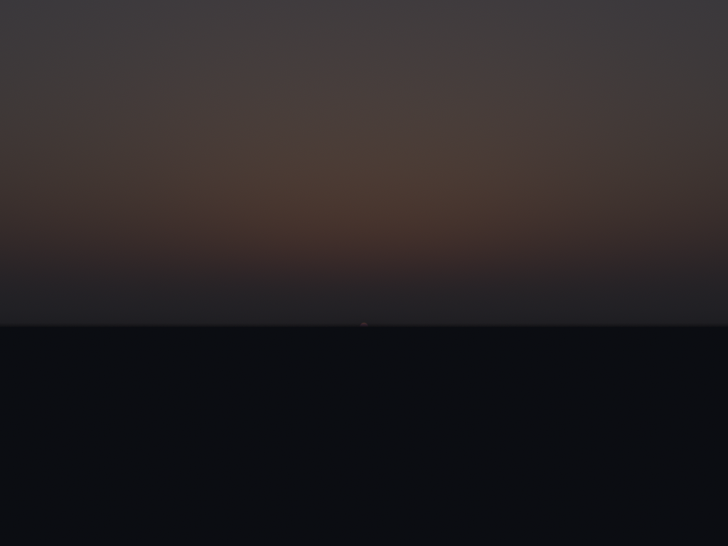

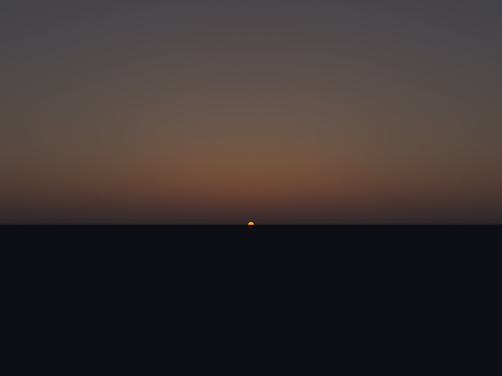

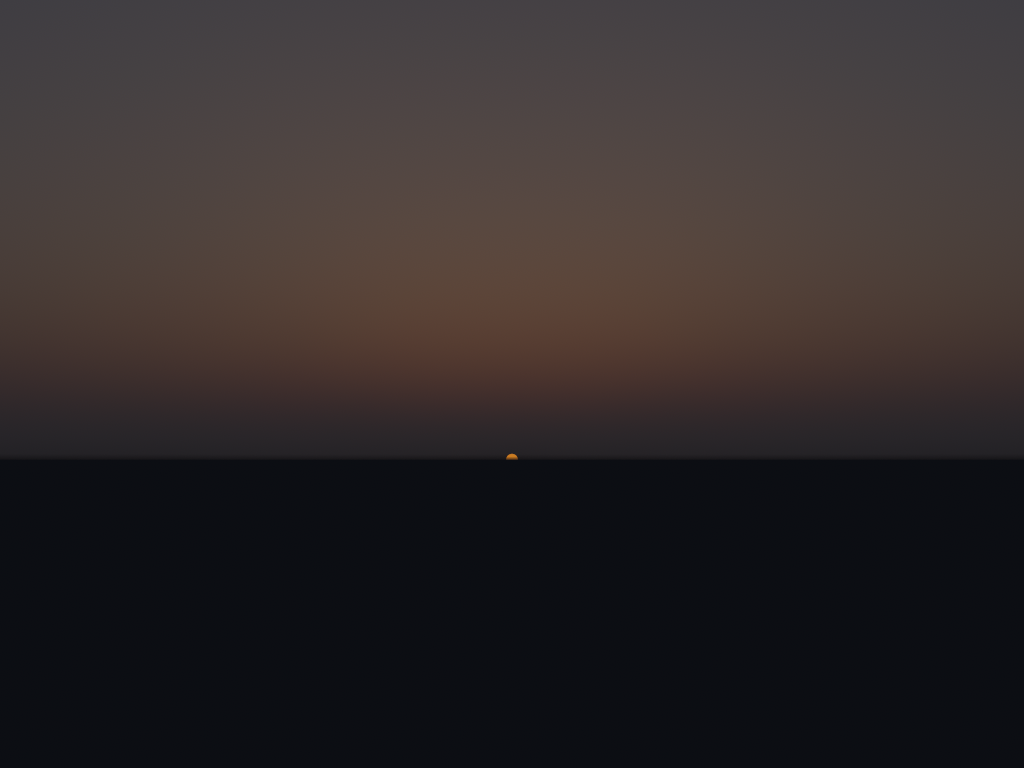

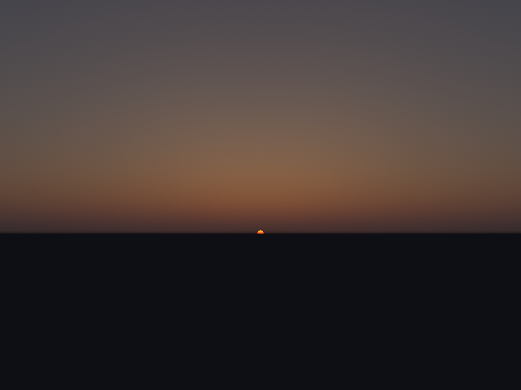

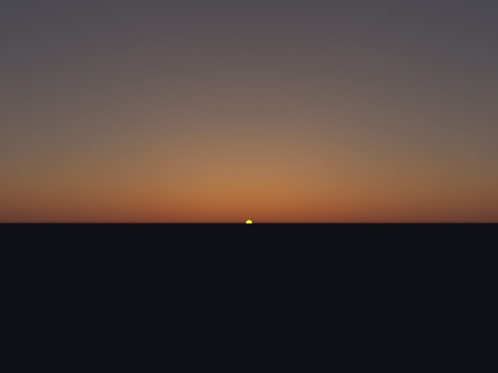

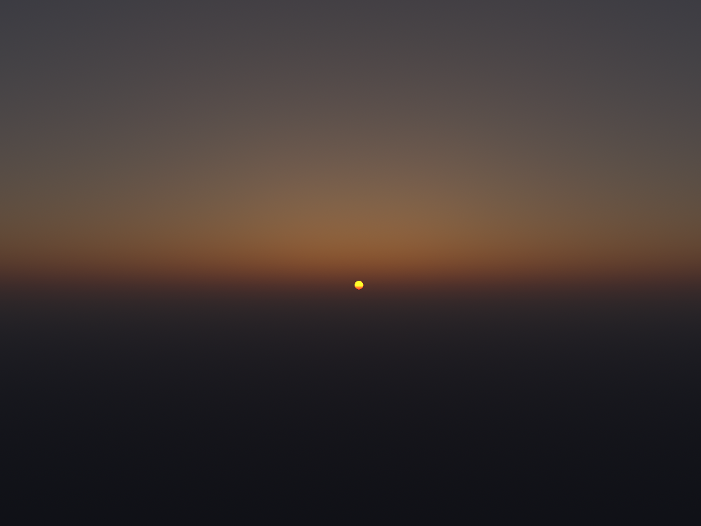

PRG Clear Sky - Nautical twilight effect
This example shows how the sun's position affects the sky, creating a twilight effect. Changing the sun's position could require adjusting the Exposure Value as well.
01_PRGNew_EV10_0deg
Exposure Value = 10; Sun below the horizon = 0°
02_PRGNew_EV10_-2deg
Exposure Value = 10; Sun below the horizon = -2°
03_PRGNew_EV10_-4deg
Exposure Value = 10; Sun below the horizon = -4°

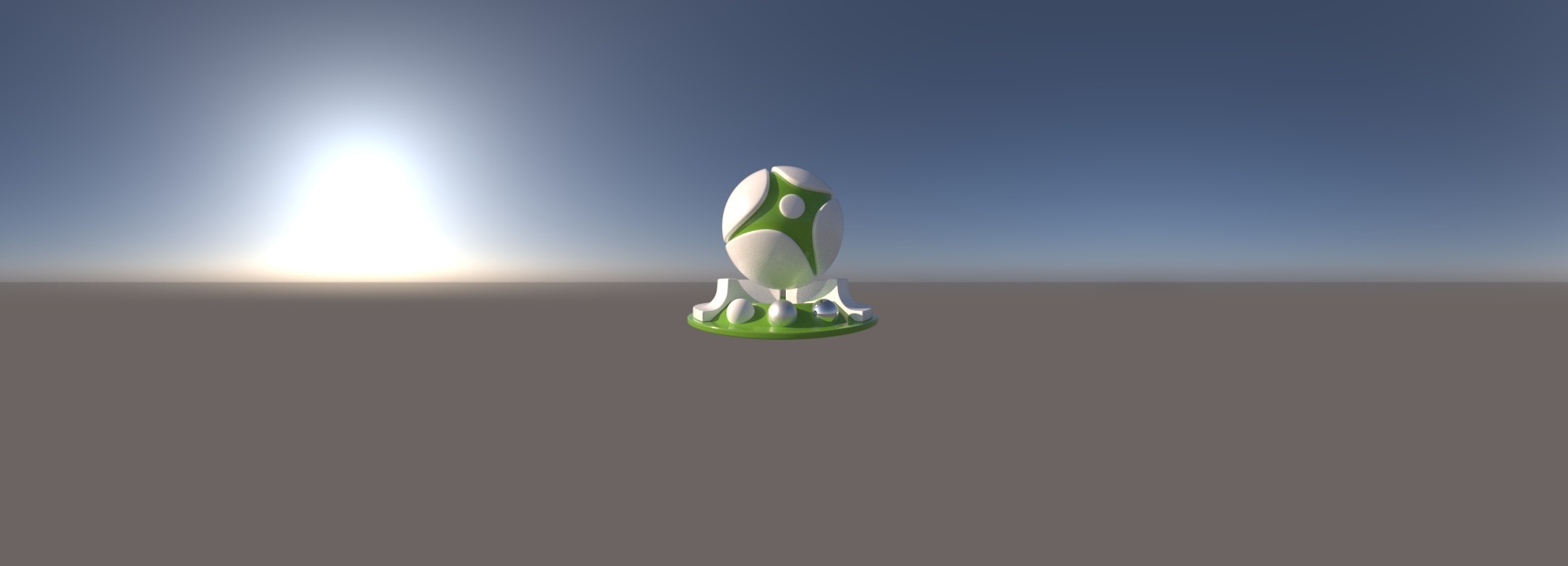

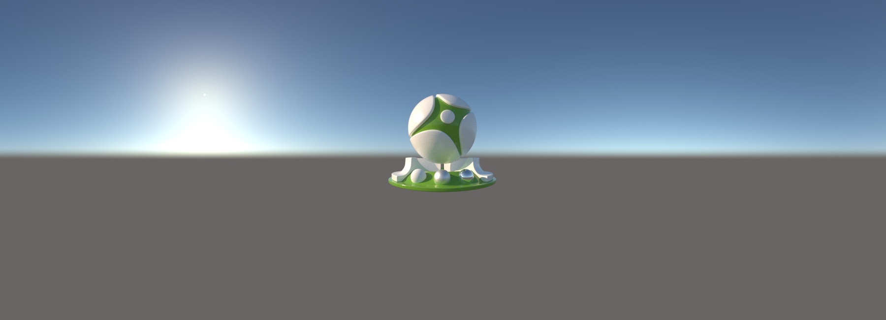

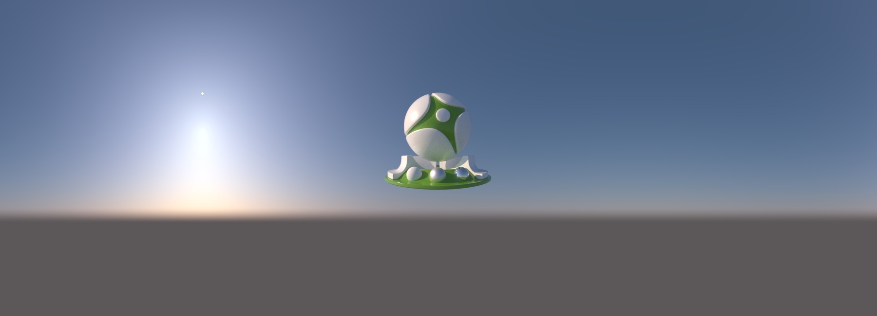

In this example, you can see how the value of the Blend angle smoothens or sharpens the horizon.
Blend angle = 5
Blend angle = 10
Blend angle = 20
Blend angle = 45
Blend angle = 90

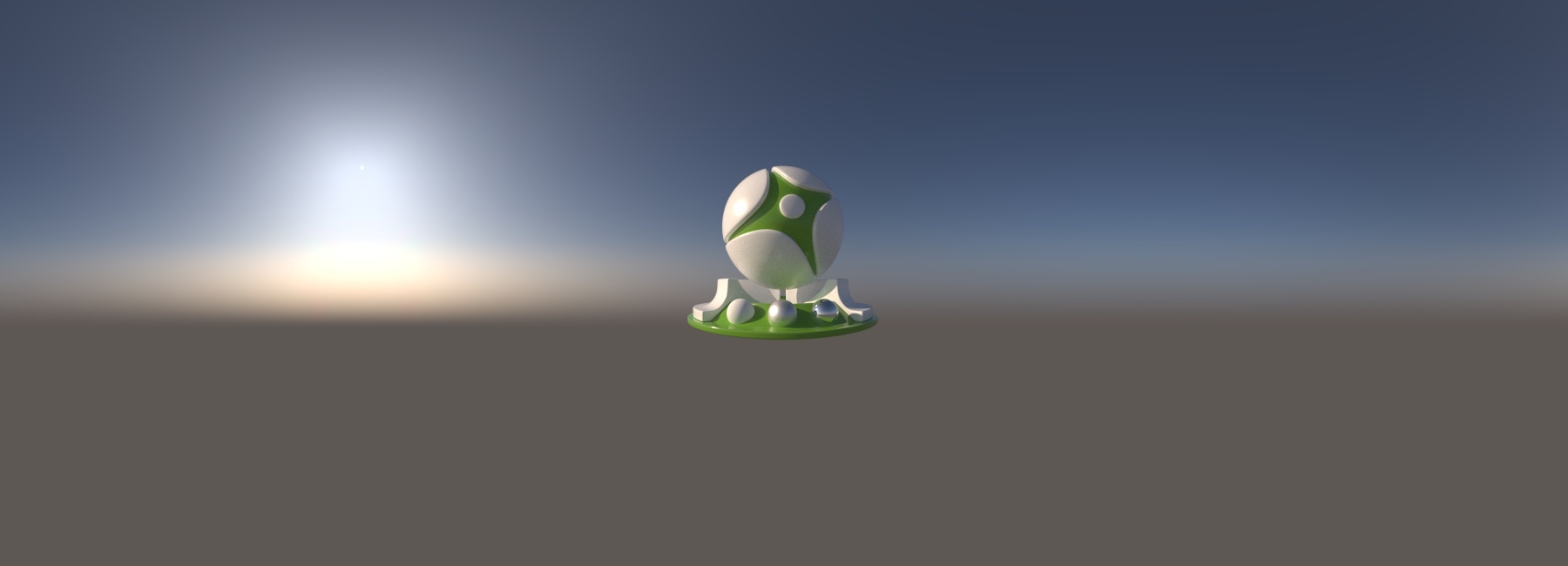

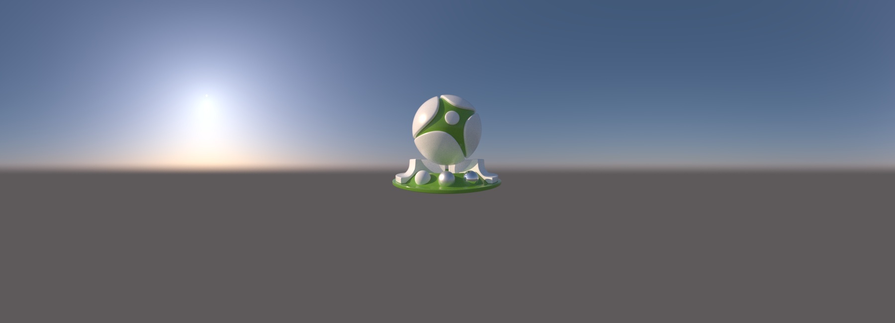

PRG Clear Sky - Horizontal Offset
In this example, you can see how the value of the Horizontal offset moves the horizon up and down.
Horizon offset = 0
Horizon offset = 10
Horizon offset = 20
Horizon offset = 40
Horizon offset = 60
