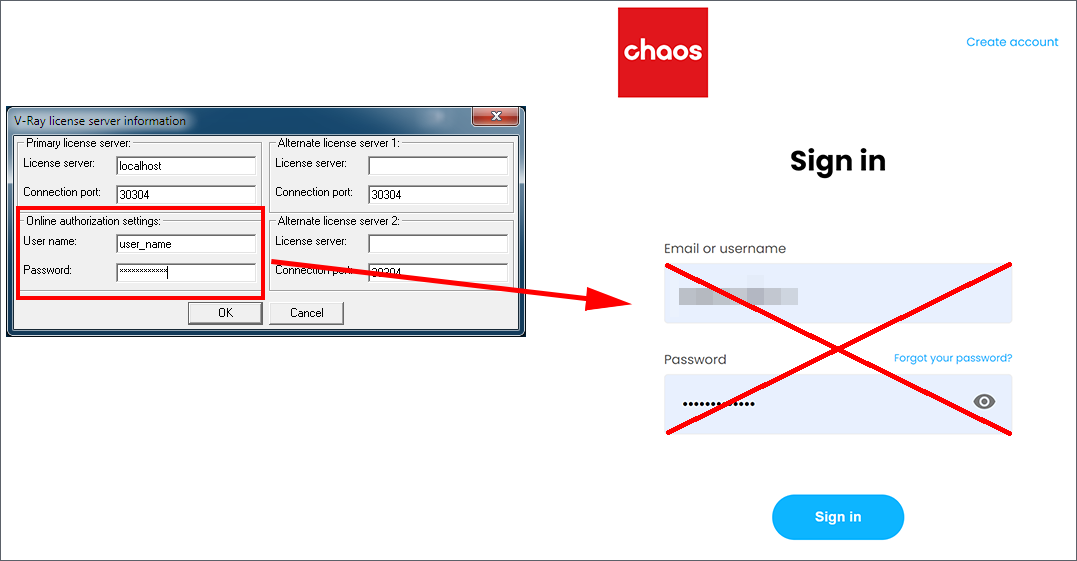

The username and password credentials in the Manually Change your license IP tool window are not the same as your online credentials used to log into your account at my.chaos.com and activate the License Server.

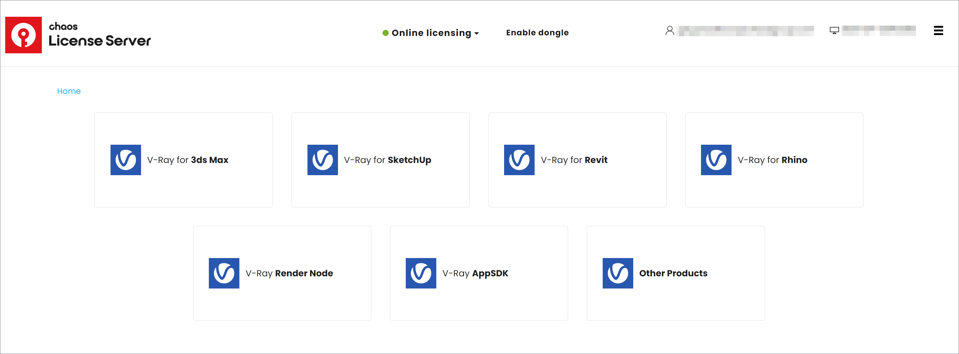

Enabling your Dongle Licenses

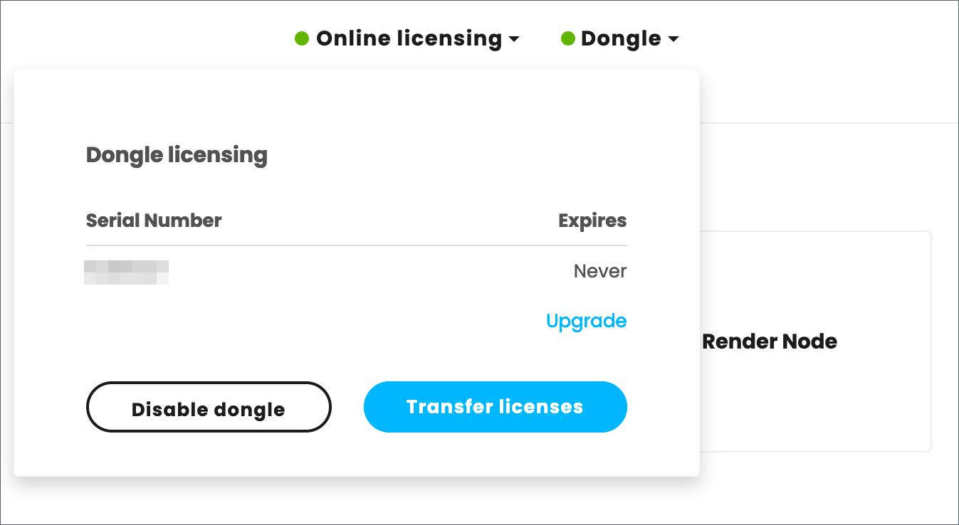

You can Enable your USB dongle by clicking on the Enable dongle button.
Once your USB dongle is enabled you will be able to see your dongle information.
If you need to upgrade your dongle, please click Upgrade and follow the instructions found on the Dongle Reprogramming page.
When using a dongle license connected to the Chaos License Server you are only able to access the dongle licenses on the machine that the dongle is connected to. You are unable to access dongle licenses over the Internet on another machine logged into the Chaos License Server.
