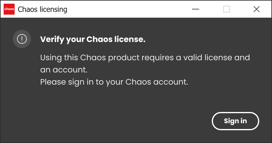

Your Chaos product will ask you to log in when this is required to activate the product.
Example: Sign in at the end of installation
Example: Sign in required in the product

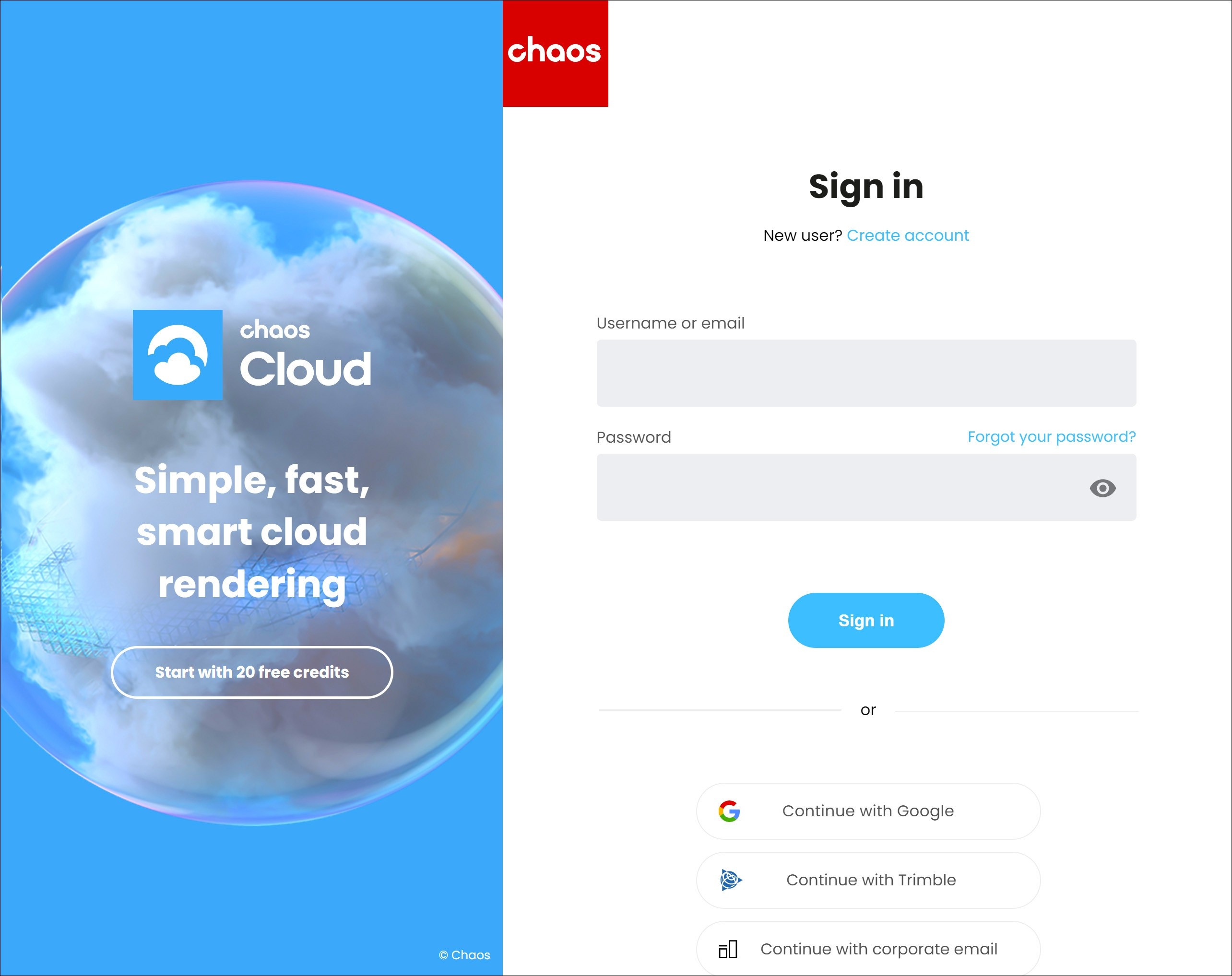

- Enter your Chaos credentials.
You can use your Chaos account credentials.
Your existing Enscape, V-Ray, Corona, Anima or Veras logins are all Chaos accounts and work for all our products.
If you have never had a Chaos account, you can create one at this step.
Chaos Single Sign-On Page
You can close the login page after seeing the confirmation for a successful login.
You can now start using your Chaos product.
Sign in confirmation
