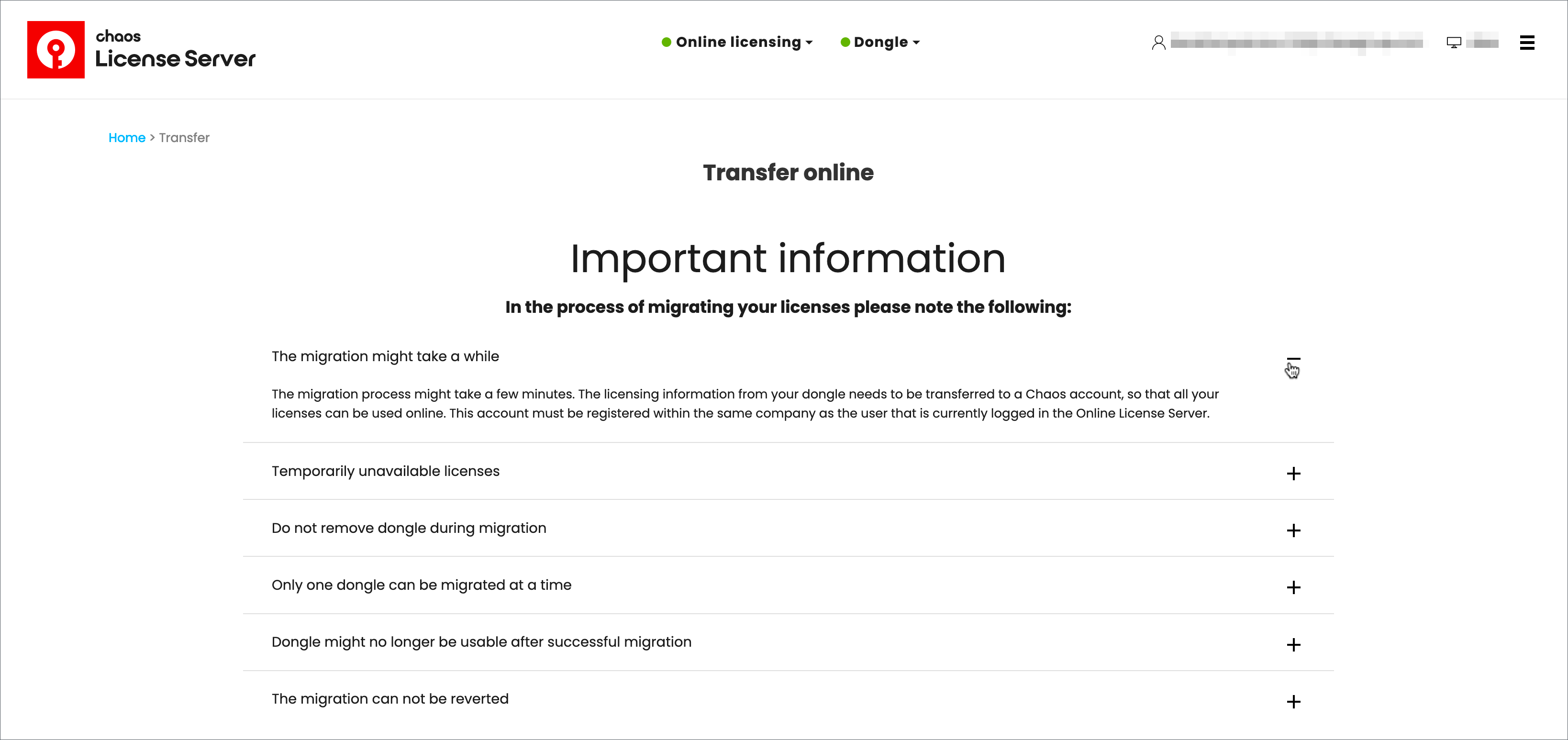

4. The Transfer option will take you to the next screen, where you will find some important information about the migration process. Please take the time to read it.
Before you click the Transfer button, please read carefully the disclaimers on the current screen and keep in mind the following:
  • The migration might take a while. The migration process might take a few minutes. The licensing information from your dongle needs to be transferred to a Chaos account, so that all your licenses can be used online. This account must be registered within the same company as the user that is currently logged in the Online License Server.
  • Temporarily unavailable licenses. During the migration, your licenses will not be available to you. After a successful migration your licenses will be available again. Please note that it might take a few minutes after the process completes before you are able to use your licenses with the Online License Server.
  • Do not remove dongle during migration. Once the migration has started, please do not remove the dongle until the migration is successful. When the migration finishes, you can remove your dongle.
  • Only one dongle can be migrated at a time. Please, do not plug other dongles into the machine during a running migration. Only one dongle can be processed at a time.
  • Dongle might no longer be used after successful migration. If all the licenses on the dongle are eligible for migration, they will be migrated and available online for use with your Chaos account with the Online License Server.
The migration can not be reverted. Once your dongle licenses are successfully transferred online, they cannot be transferred back to your dongle.
