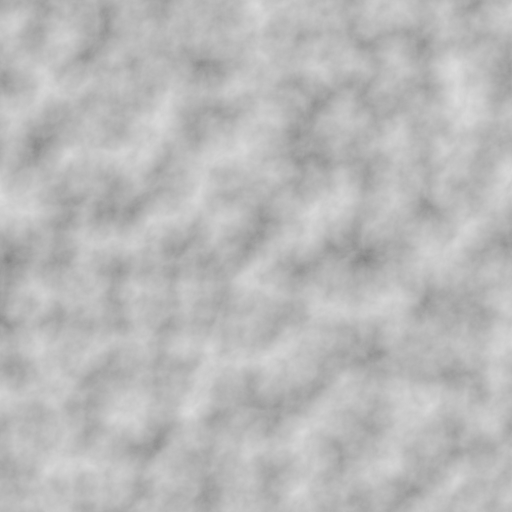

Alligator noise
This is an implementation of the Houdini's Alligator noise as described here.
It uses the shading point's position in object space rather than the surface's texture coordinates.
Use this shader with a VRayOSLTex instance with the "wrap texture coordinates" option turned off.
The shader code can be found at alligatornoise.zip.
start frequency - Initial sampling position multiplier that affects the overall granularity.
start offset - Offsets the initial sampling position effectively shifting the pattern in the specified direction.
lacunarity - Position (frequency) multiplier per iteration.
gain - Amplitude multiplier per iteration.
octaves - Number of fractal iterations.
attenuation - The power of the falloff applied to the final result.

Simplex noise
Simplex noise is a close relative to the Perlin noise but with fewer directional artifacts and generally lower computational overhead especially in higher dimensions.
The current 3D implementation uses the shading point's position in object space rather than the surface's texture coordinates.
The shader code can be found at simplexnoise.zip.
