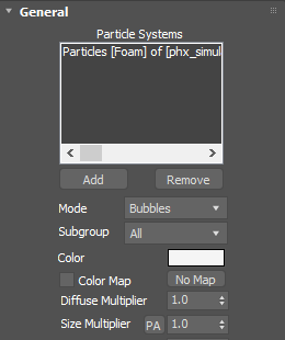

The Particle Shader is used to shade particles such as splash and foam. Usually, it is targeted to the particles exported by the Simulator, but it can also shade any Particle System in 3ds Max as well.
Select the Phoenix Particle Shader and set the Mode to Bubbles. When using this mode, each particle will be shaded as a spherical, transparent, reflective foam bubble, which is exactly what we need in this setup.
Set the Color to RGB (233, 233, 233).
Enable the Volume Light Cache.
Set the Light Cache Speedup to 0.990.
In this example scene, the Volume Light Cache is used for speeding up the rendering process.
You may experiment with the Light Cache Speedup value to see which value works best with your setup.
Check the Particle Shader page for more information about the Volume Light Cache option.
