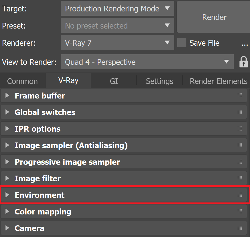

UI Path: ||Render Setup window|| > V-Ray tab > Environment rollout (Renderer set to V-Ray)
