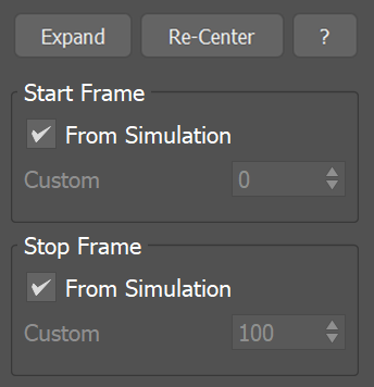

Start Frame
- From Simulation | rs_start_from_sim – When enabled, the Resimulation will run from the first frame of the base simulation to the simulation End Frame or the Custom Stop Frame, depending on the options.
- Custom | resim_startframe - Explicitly sets the Start Frame of the Resimulation. This can also be a negative number.
Stop Frame
- From Simulation | rs_stop_from_sim – When enabled, the Resimulation will run from the base simulation Start Frame or the Custom Start Frame to the last frame of the base simulation.
- Custom | resim_stopframe - Explicitly sets the End Frame of the Resimulation. This can also be a negative number.

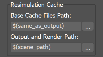

Resimulation Cache
During resimulation, Phoenix reads cache files from the Base Cache Files Path, performs resimulation operations, and then saves a new cache sequence in the Output and Render Path.
For more information on how to set up resimulation paths, see the Tips and Tricks page.
Base Cache Files Path | resim_inpath – Specifies the base simulation caches which will be used as base for resimulation. $(same_as_output) by default.
Output and Render Path | resim_outpath – Specifies the path for writing the output cache files. See Output Path for more details on the $(...) macros you can use. $(scene_path) by default (will append "_resim" to the end of the file name).
Click the "..." button to open a menu with the following options:
Browse - Opens a dialog where you can select where the resimulation caches will be written to. The filename you type in must contain # signs so each resimulation frame will be written to a differently numbered file. Also, you can choose between two file formats - AUR and VDB cache files.
Delete Cache Files - Clears the resimulation files.
Reset to Default - Resets the resimulation path to default.
Help - Opens this help page.
You can use the same Output and Render Path as the Base Cache Files Path, and this way Phoenix will not create a separate cache sequence for resimulation, but will overwrite the base simulation caches instead. It's valid to do so if you need a more complicated setup or when not enough disk space is available.
