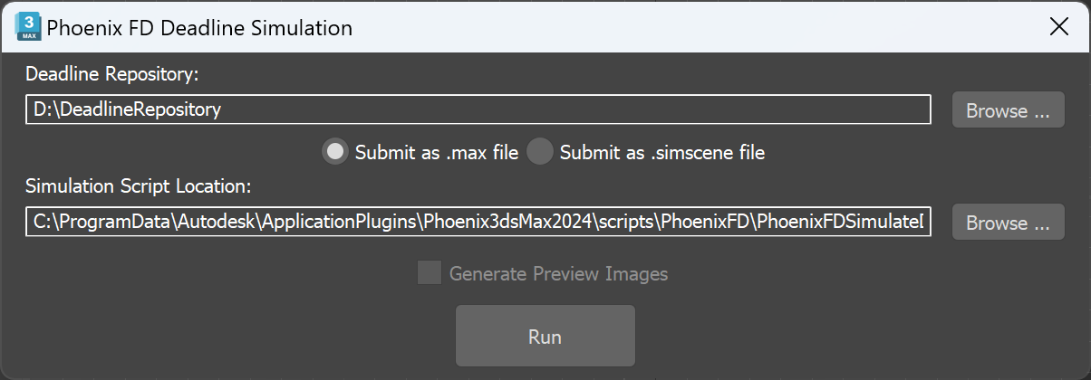

The path to the Phoenix scripts must be provided within the following window. The path is set by default to the correct values, so it should be changed only if you need to provide your own scripts.
When a simulation is submitted to Deadline, the selected Phoenix simulators in the scene will be simulated in the order they were selected. If no simulators are selected in the scene, all simulators will be simulated.
Deadline Repository – Specifies location of the Repository, the global file system component used by Deadline.
Submit as .max file Option for submitting 3ds Max scenes through Deadline.
Submit as .simscene file Option for submitting Phoenix Standalone simulations through Deadline. Using this method you don't need to have 3ds Max installed on the Deadline Worker node.
Simulation Script Location – Specifies the location of the Phoenix simulation script. This path is set by default.
Generate Preview Images - Option for enabling/disabling the image generation when submitting .simscene files. The checkbox is grayed out if submitting .max files. When the option is enabled - the Standalone Previewer will read the cache files produced by the simulation and it will generate an image sequence in the folder where the simulation caches are located.
