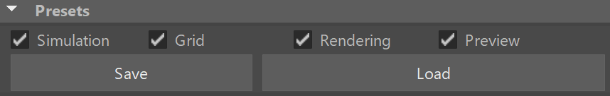

The Presets rollout allows you to save the parameters of the simulator to files on your storage, and then load them back. You can load a preset for a group of simulators if you select them together and load the preset from one of them. Particular groups of parameters can be managed in contrast to the default Maya preset system (the Presets* button at the top of the Attribute Editor).
Note that links to sets, nodes or textures are not saved and loaded from presets because loading a preset in a different scene where the linked nodes do not exist will error out.
Attributes
Simulation | global int $__phx_templ_sim – When enabled, the settings regarding the simulation will be saved or loaded.
Grid | global int $__phx_templ_grid – When enabled, the settings regarding the Grid Size/Container Walls/Adaptive Grid will be saved or loaded.
Rendering | global int $__phx_templ_rend – When enabled, the settings regarding the final rendering will be saved or loaded.
Preview  | global int $__phx_templ_prev – When enabled, the settings regarding the viewport visualization will be saved or loaded.
