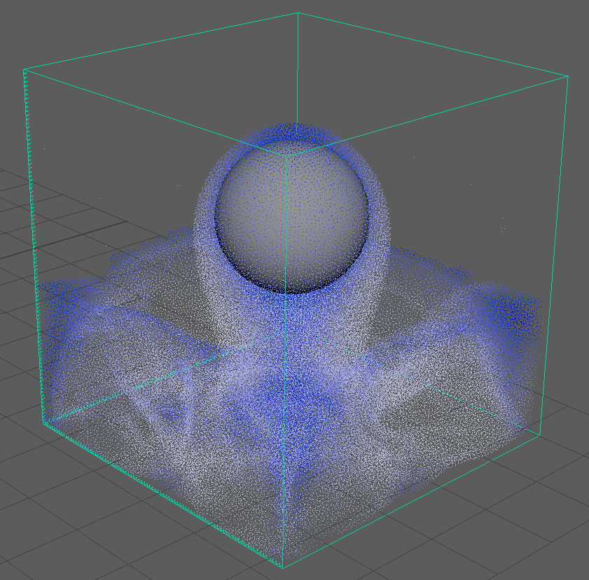

A Simulator is a Phoenix object that controls the simulation, and enables you to create fluids like liquids and gasses that interact with the surrounding environment.
You can think of a Phoenix Simulator as a 3D box, inside which simulations of fluids and Rigid Body Dynamics are performed. The box is divided into small cells, called voxels, which is why the box is referred to as a Simulation Grid. The voxels inside the grid can be filled with just about any type of gas or liquid.
For each frame in your simulation, Phoenix looks at each voxel and calculates whether there is any fluid there, based on the settings you give the Phoenix sim. The simulator will also account for obstacles, such as geometry, as well as participating forces in the scene, and so forth.

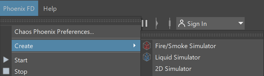

The Fire/Smoke, Liquid Simulator and the 2D Simulator can be created from the Phoenix FD menu → Create menu.

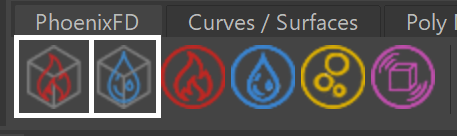

Another way to create a Simulator is to click the Fire/Smoke Simulator or Liquid Simulator button in the Phoenix Shelf, then draw on screen as if you are creating a box. The length, width, and height of the grid are set by the size of the Simulator. The Grid Size can be changed afterward, in the Simulator object's Attribute Editor.
The Simulator should contain the object which will emit the fire or liquid, and the area into which the fire or liquid will flow. The simulation will be contained completely inside the grid.
