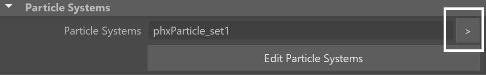

The nodes can be easily accessed from the Particle Shader's Particle Systems rollout, where all available Particle Group nodes are linked.

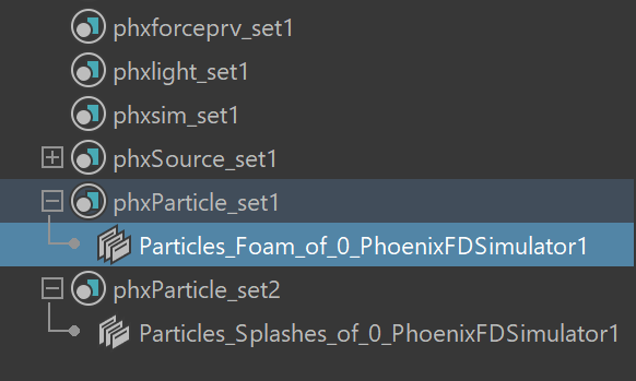

A Particle Group node can be assigned to a set, or used to create a Maya nParticle System.

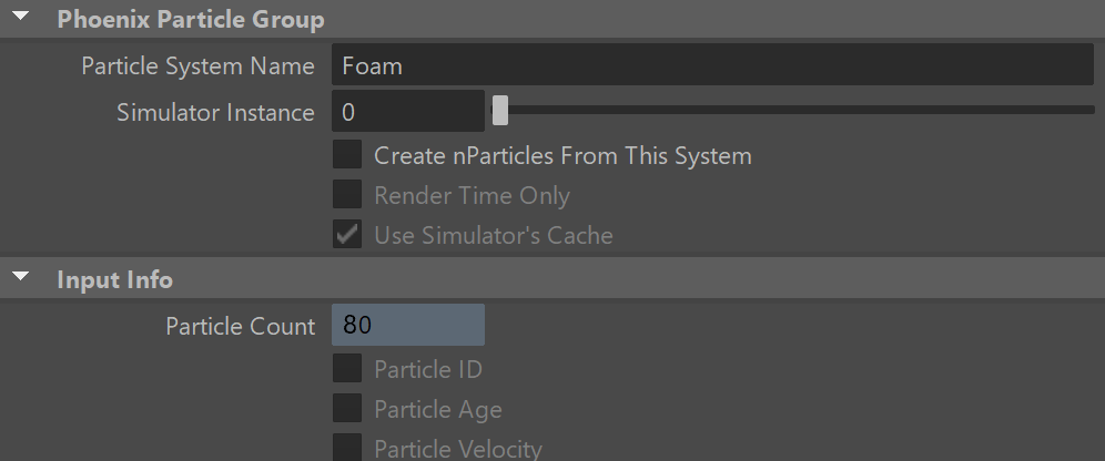

Attributes
Particle System Name  | groupName – The name of the particle group in the Simulator. Don't edit manually.
Simulator Instance | instance – The instance number of the Simulator that created this particle group. Note that each instance of the Simulator has it's own content and the particle groups are not instanced. Don't edit manually.
Create nParticles From This System | createPartSystem – When enabled, an nParticle System will be created for this group. Note that this will take more memory than using the particle group directly.
Render Time Only | renderTimeOnly - Used only when Create nParticles From This System is enabled. If checked, will not create the nParticle system in the viewport preview, but only during rendering.
Use Simulator's Cache | exportAsCache - Used only when Create nParticles From This System is enabled, and Render Time Only is disabled. If enabled, the nParticle system would read the Simulator's cache files during rendering, so they would need to be present and accessible to the rendering. If disabled, the nParticle's radii and colors would be baked in the rendered vrscene so that the Phoenix cache files would not be needed.
