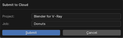

V-Ray provides built-in integration with Chaos Cloud, allowing you to submit render jobs to the cloud directly from Blender using the dedicated Submit to Cloud button, which is located in the V-Ray Menu.
A Submit to Cloud window opens, where you can confirm the export of the current scene and submit the exported .vrscene to the Cloud.
  • Here you can specify the name of an already existing Project or create a new one. Then, give a name to this new Job.
  • Once you click Submit, the Chaos Cloud page opens on your current job and starts rendering if you have enough Cloud Credits.

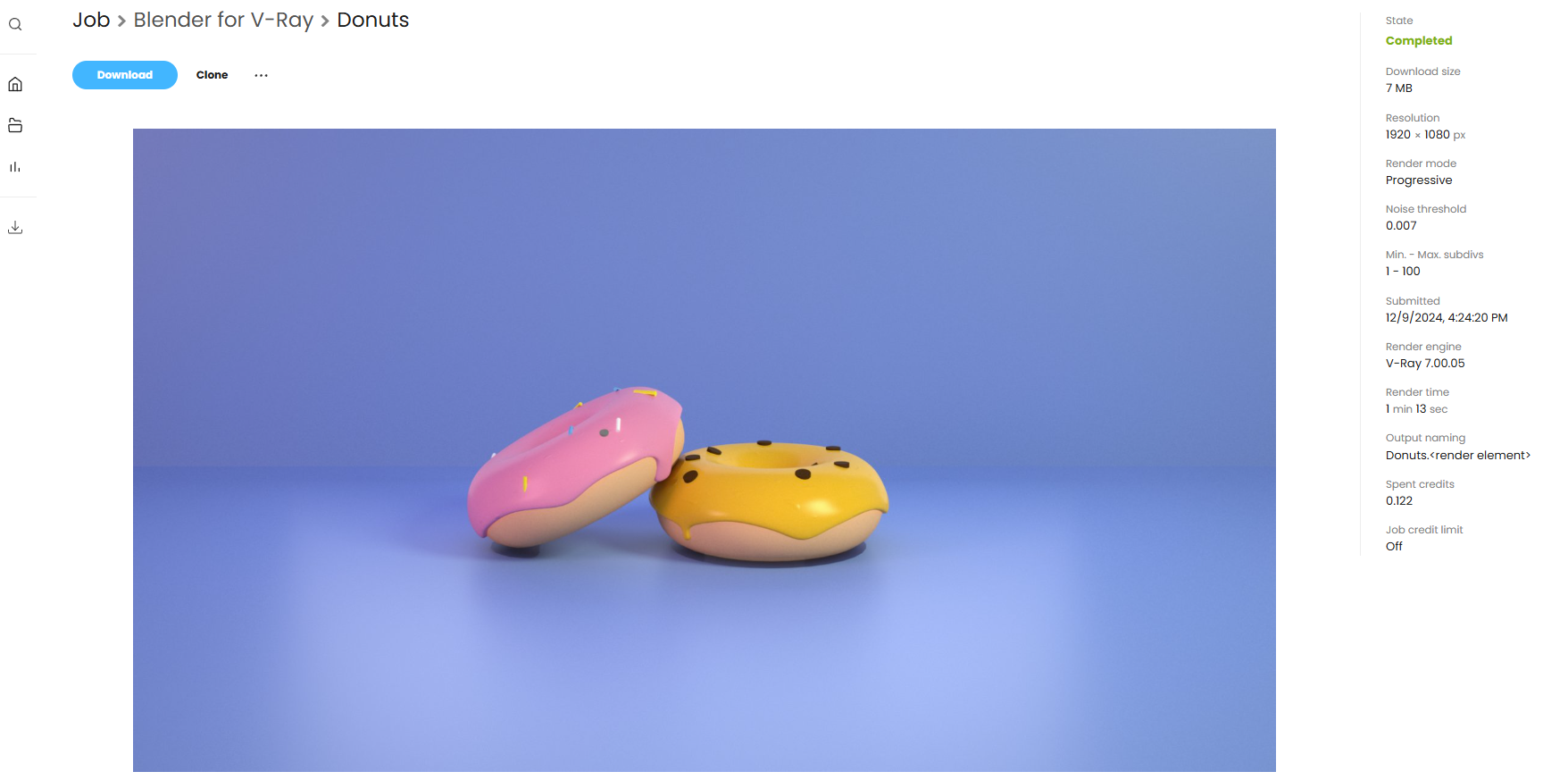

On the Chaos Cloud page, you can view details about your render.
When the render is complete, you can click Download to download the scene as an .exr
