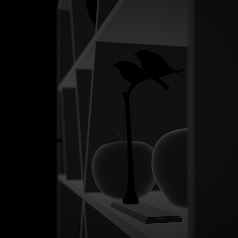

The Coat Filter Render channel stores reflection information calculated from the materials' reflection values in the scene. Surfaces with no reflection values set in their material(s) contain no information in the render pass and, therefore, render as black.
While the Raw Coat Reflection Render channel gives the full reflection of objects reflecting in the scene, the Coat Filter render channel shows how much of that reflection should come through in the composite. In other words, the filter defines the strength of the reflection, while the raw image defines what is being reflected in the image. When these two channels are multiplied, the true level of reflection is given and produces the Coat render channel. Using these component parts of the reflection, you can better fine-tune the reflection in your final composite.

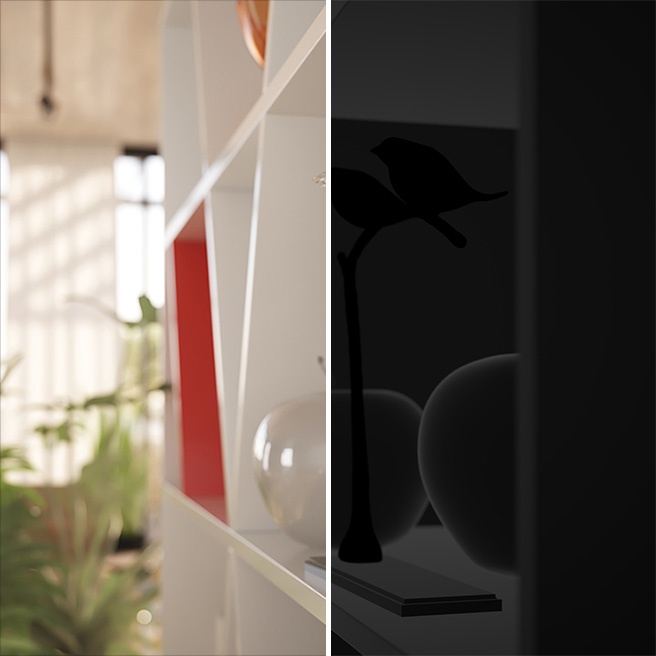

beauty render Before image
coat filter channel After image

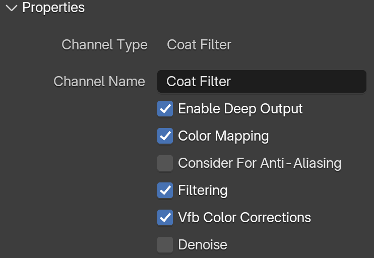

Properties
Enable Deep Output  Specifies whether to include this render channel in deep images.
Color Mapping – Applies the color mapping options specified in the Color Mapping rollout of the V-Ray tab in the Render Settings window to this render channel. This option is enabled by default.
