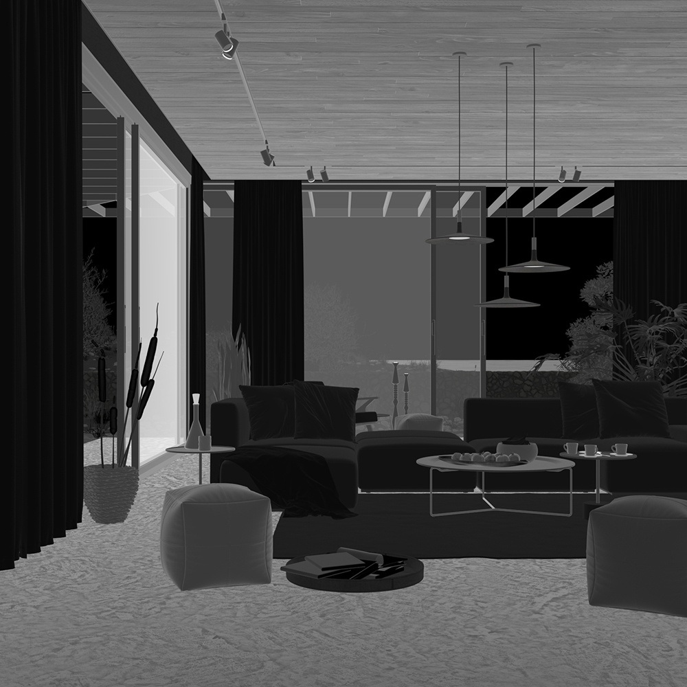

The Reflection Filter Render Channel stores reflection information calculated from the materials' reflection values in the scene. Surfaces with no reflection values set in their material(s) contain no information in the render pass and, therefore, render black.
While the Raw Reflection Render Channel gives the full reflection of objects reflecting in the scene, the Reflection Filter shows how much of that reflection should come through in the composite. In other words, the filter defines the strength of the reflection, while the raw image defines what is being reflected in the image. When these two channels are multiplied, the true level of reflection is given and produces the Reflection Render Channel. Using these component parts of the reflection, you can fine-tune the reflection in your final composite.

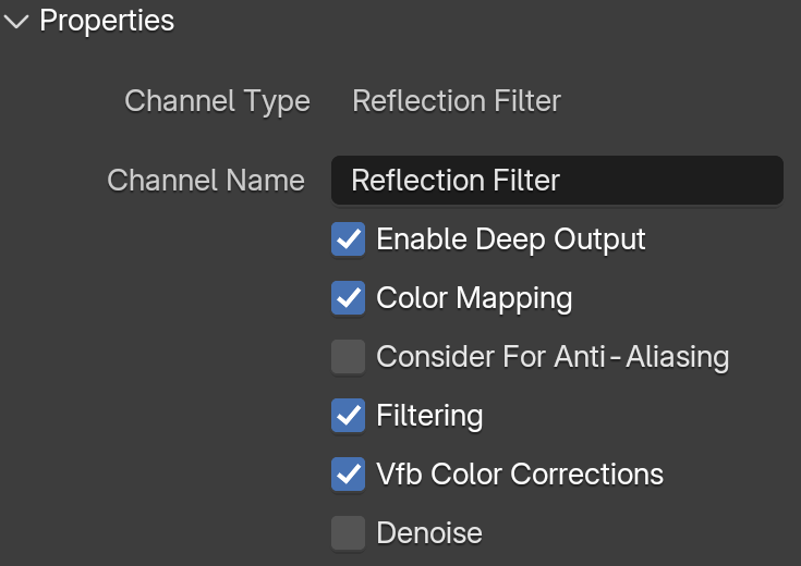

Properties
Channel Name – Customizable name for the render channel.
Enable Deep Output – Specifies whether to include this render channel in deep images.
Color Mapping –
Consider For Anti-Aliasing – When enabled, anti-aliasing is used where possible.
Filtering – Applies an image filter to this channel.
Derive Raw Channels – Generates data in the raw channels by combining the respective color and the filter color channels.
Vfb Color Corrections – Applies the post-render color adjustments made from the VFB.

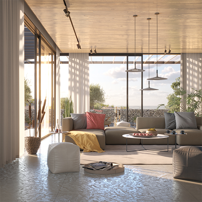

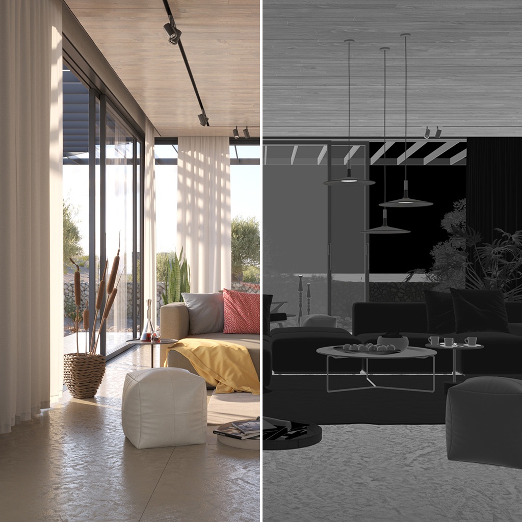

The Reflection Filter Render Element is useful for changing the appearance of Reflective elements after rending, in a compositing or image editing software. In the example, the contrast of the Reflection Filter is increased, which makes reflective objects even more reflective. The Raw Reflection render channelis used to colorize the reflections - the floor has a cool tint applied, and the ceiling - has a warm tint.
