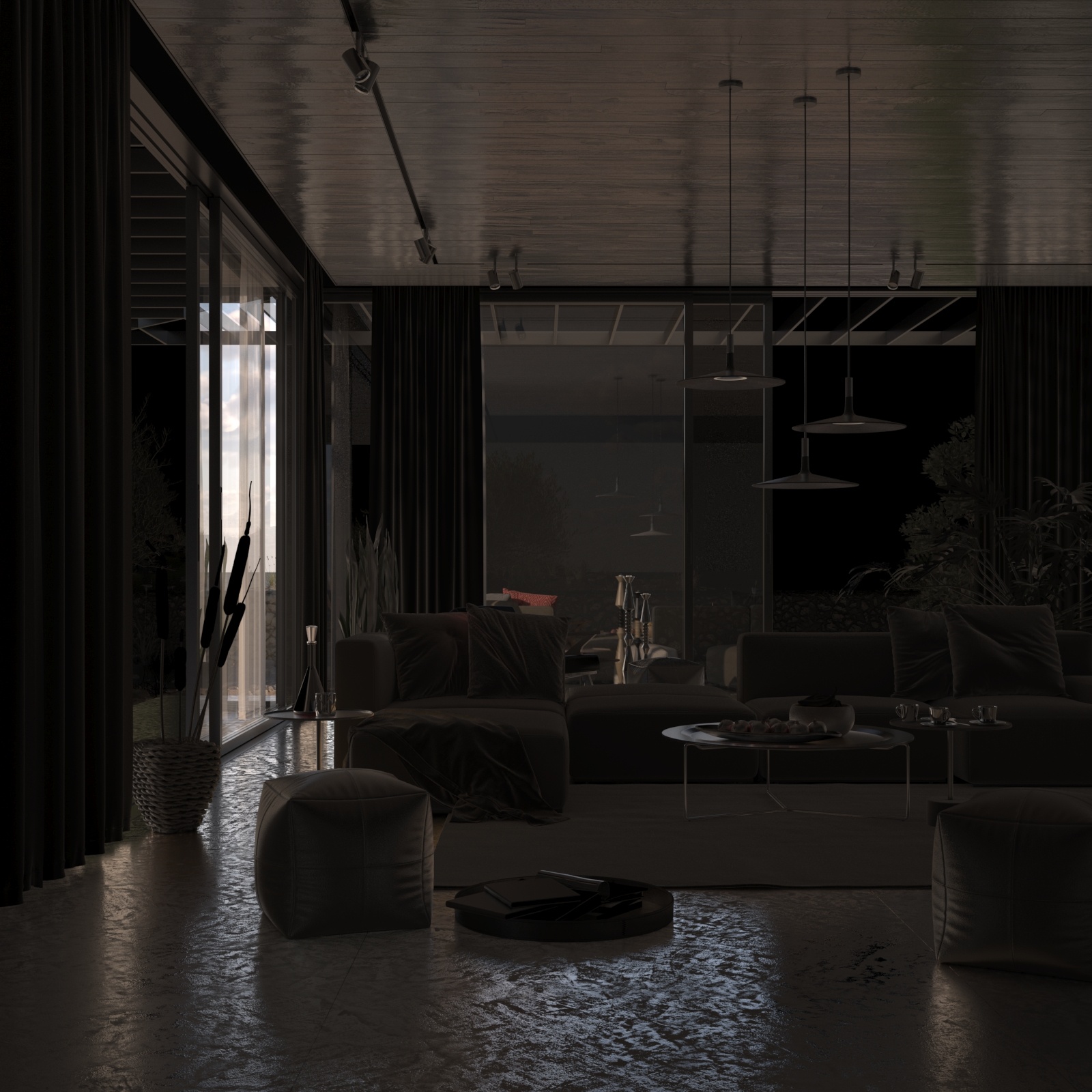

The Reflection Render Channel stores reflection information calculated from the materials' reflection values in the scene. Surfaces with no reflection values set in their materials contain no information in the render pass and, therefore, render black.
The Reflection Render Channel is formed by multiplying the Raw Reflection Render Channel by the Reflection Filter Render Channel. So, while the raw reflection pass gives the full reflection of objects reflecting in the scene, the reflection filter sets how much of that reflection should come through in the composite. The two are multiplied together to create the V-Ray Reflection render channel, which gives a true representation of the reflection in the scene.

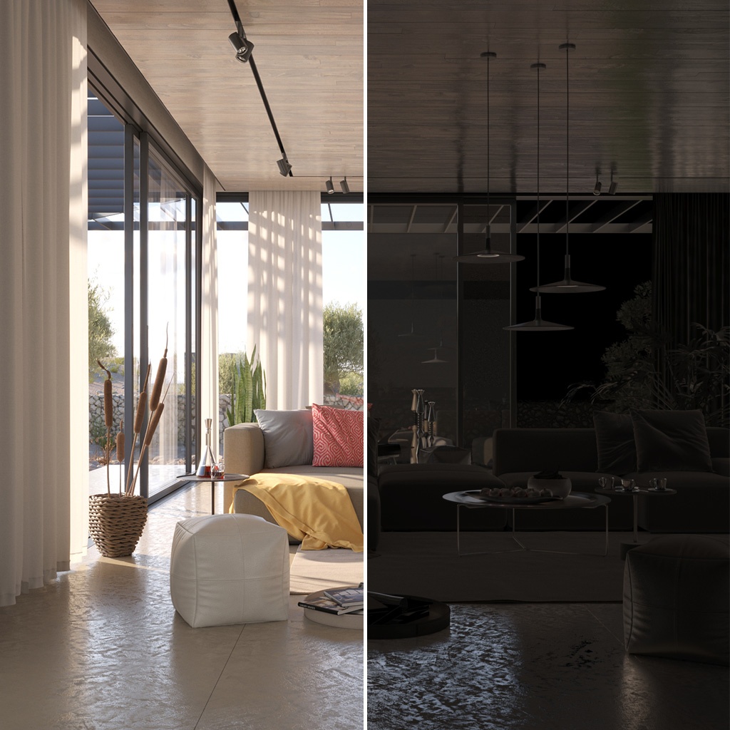

beauty render Before image
reflection channel After image

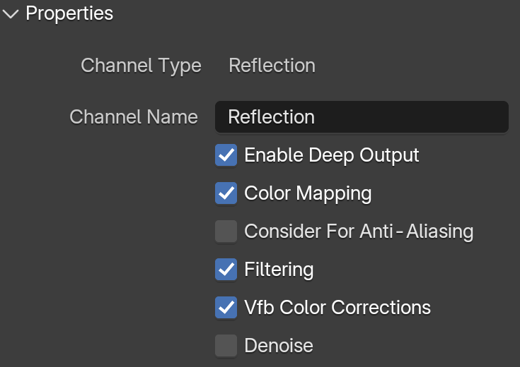

Properties
Enable Deep Output Specifies whether to include this render channel in deep images.

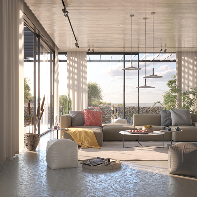

The Reflection render channel is useful for changing the appearance of reflective elements after rendering using compositing or image editing software. In the example, the reflections are brightened using the Reflection RC. Some of the reflections are selected using a Cryptomatte mask and a cool tint is applied to them.
original render Before image
reflections brightened After image
