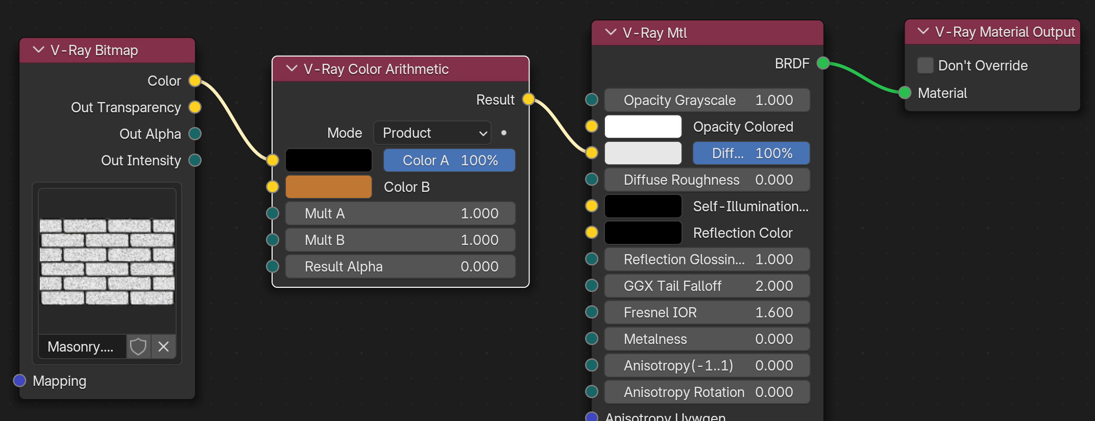

For the example here, a Bitmap node is attached to Color A, and Color B is set to an orange color. The Mode is set to output the Product of the two Color slots, and it is connected to the Diffuse of the V-Ray Material, resulting in an orange-tinted brick map.
