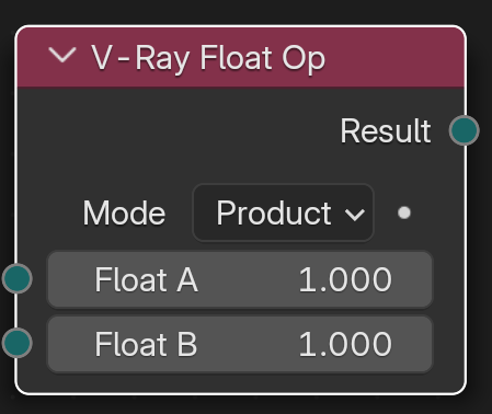

The V-Ray Float Operations utility texture performs mathematical operations on float values.
UI Path: ||V-Ray Node Editor|| > Shader > Add > Texture Utilities V-Ray Float Op
Properties
Float A – Specifies float operand A.
Float B – Specifies float operand B.
Mode – Determines what output to use when no output parameter is specified. It is useful if the type of the operation needs to be animated.
