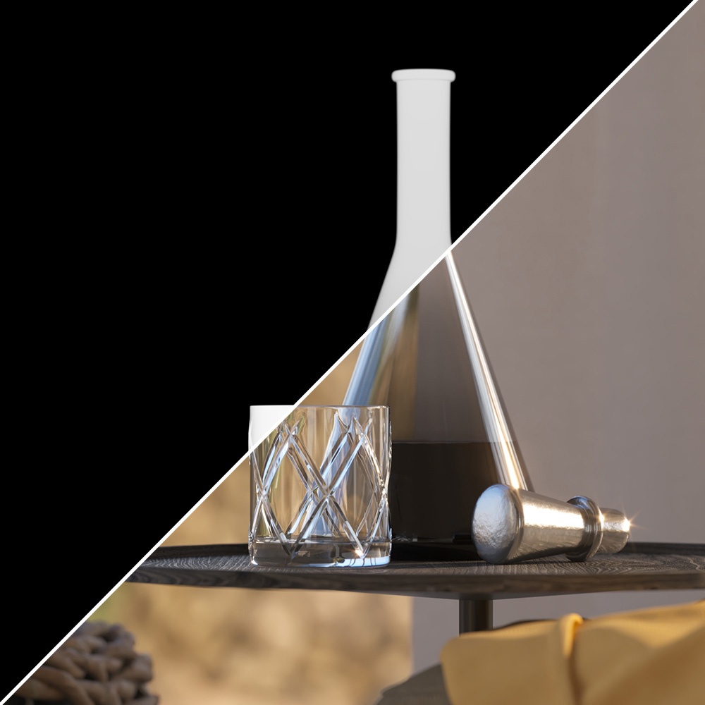

The Refraction Filter Render Channel is an image that stores refraction information calculated from the materials' refraction values in the scene. Materials with no refraction values appear as black, while completely refractive materials appear as white, and everything in between appears as a shade of gray. If any hue (color) is specified in the material's Refractive Color parameter, that hue and value are represented here in the Refraction Filter as well as being affected by the refraction's Amount parameter.
In comparison, the Raw Refraction Render Channel is a color render channel that takes materials and their colors into account when rendering refraction. Multiplying these two render channels together produces the Refraction Render Channel.

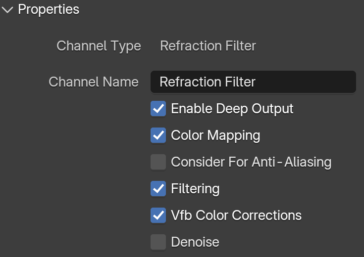

Channel Name – Customizable name for the render channel.
Enable Deep Output – Specifies whether to include this render channel in deep images.
Color Mapping –
Consider For Anti-Aliasing – When enabled, anti-aliasing is used where possible.
Filtering – Applies an image filter to this channel.
Derive Raw Channels – Generates data in the raw channels by combining the respective color and the filter color channels.
Vfb Color Corrections – Applies the post-render color adjustments made from the VFB.
