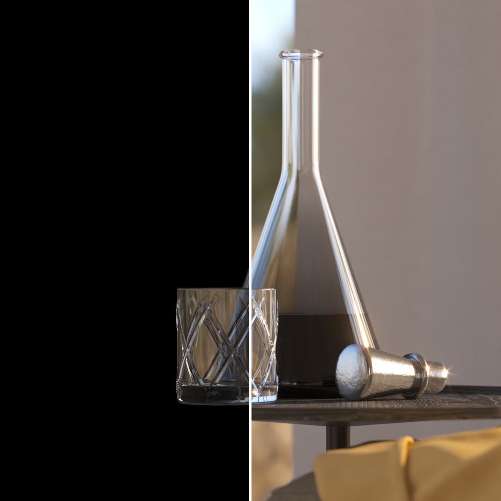

The Raw Refraction Render Channel is a color image that stores refraction information calculated from materials' refraction values in the scene. Surfaces with no refraction values set in their materials contain no information in the render channel and, therefore, render black.
In comparison, the Refraction Filter render channel is a render channel that indicates varying degrees of refraction in the scene through brightness values in the image. Multiplying these two render channels together produces the Refraction render channel.

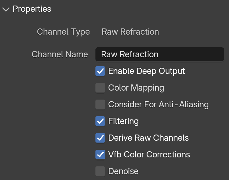

Properties
Enable Deep Output  Specifies whether to include this render channel in deep images.
Color Mapping –
