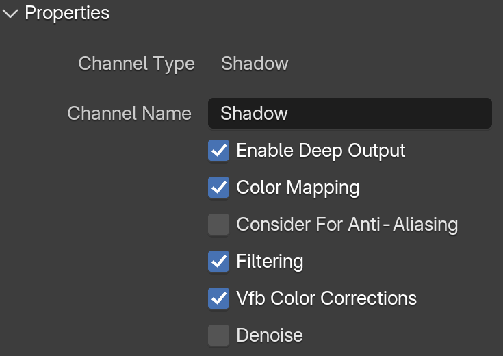

Enable Deep Output  Specifies whether to include this render channel in deep images.
Color Mapping
Filtering –  Applies an image filter to this channel.
Denoise – Enables the render channel's denoising, provided the Denoiser is enabled.
