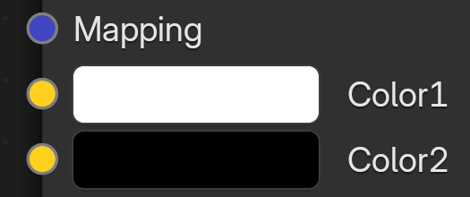

Mapping – Allows a UVW Mapping or a UVW Randomizer node to be connected to determine the mapping of the ramp.
Color1 (input socket) –  Allows a color node to control the stucco color.
Color2 (input socket) – Allows a color node to control the dot color.

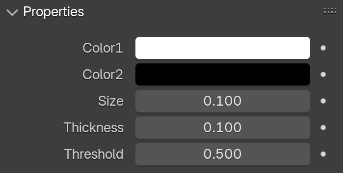

Color1 – Controls the stucco color when no node is connected.
Color2 – Controls the dot color when no node is connected.
Size – Controls the scale of the produced texture.
Thickness – Controls how thick the Stucco effect appears.
ThresholdControls which areas contain the texture's features.
