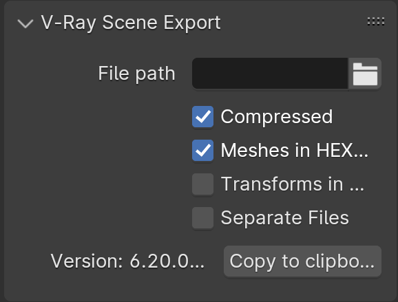

File path – Specifies the location and name for the .vrscene file.
Compressed – When enabled, basic compression will be applied to the .vrscene file. This option can only be used together with Meshes in HEX format.
Meshes in HEX Format – When enabled (the default), the mesh data will be written in hexadecimal format in the .vrscene file. This makes the files smaller and faster for processing, but less readable to a user. When disabled, the mesh data will be written in normal decimal format.
Transforms in HEX Format – When enabled (the default), transform data will be written in hexadecimal format in the .vrscene file. This makes the files smaller and faster for processing, but less readable to a user. When disabled, the data will be written in normal decimal format.
Separate Files – When enabled, V-Ray will export separate files for different components of the scene. This also allows you to disable export for certain types of objects.
You can also see and copy to clipboard the current V-Ray version in this rollout.
