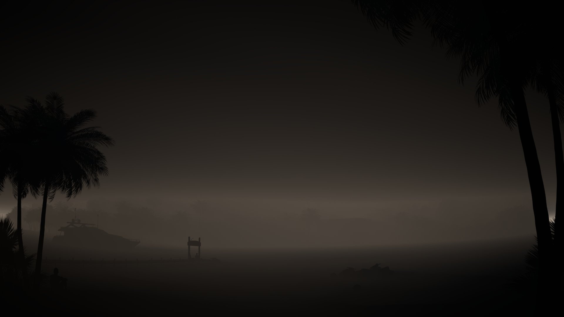

Example: Enhancing Atmospheric Effects

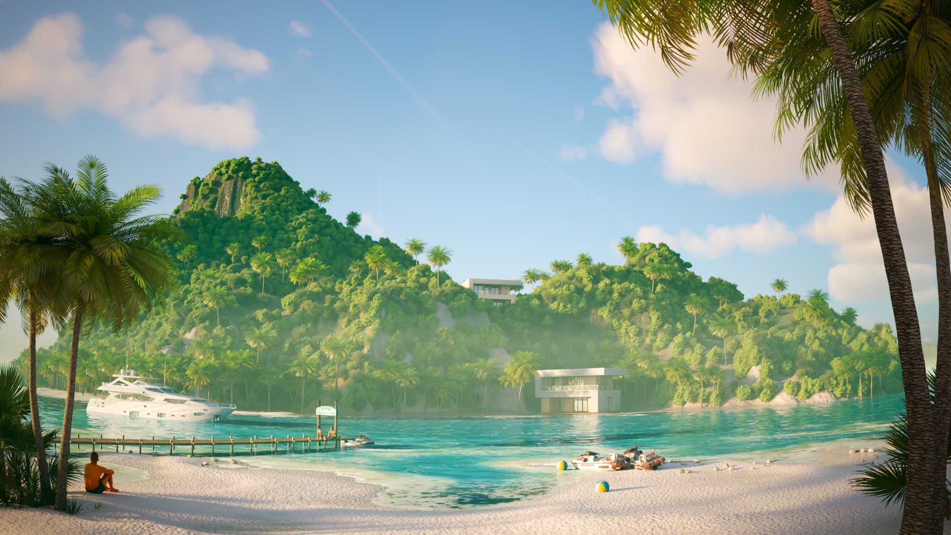

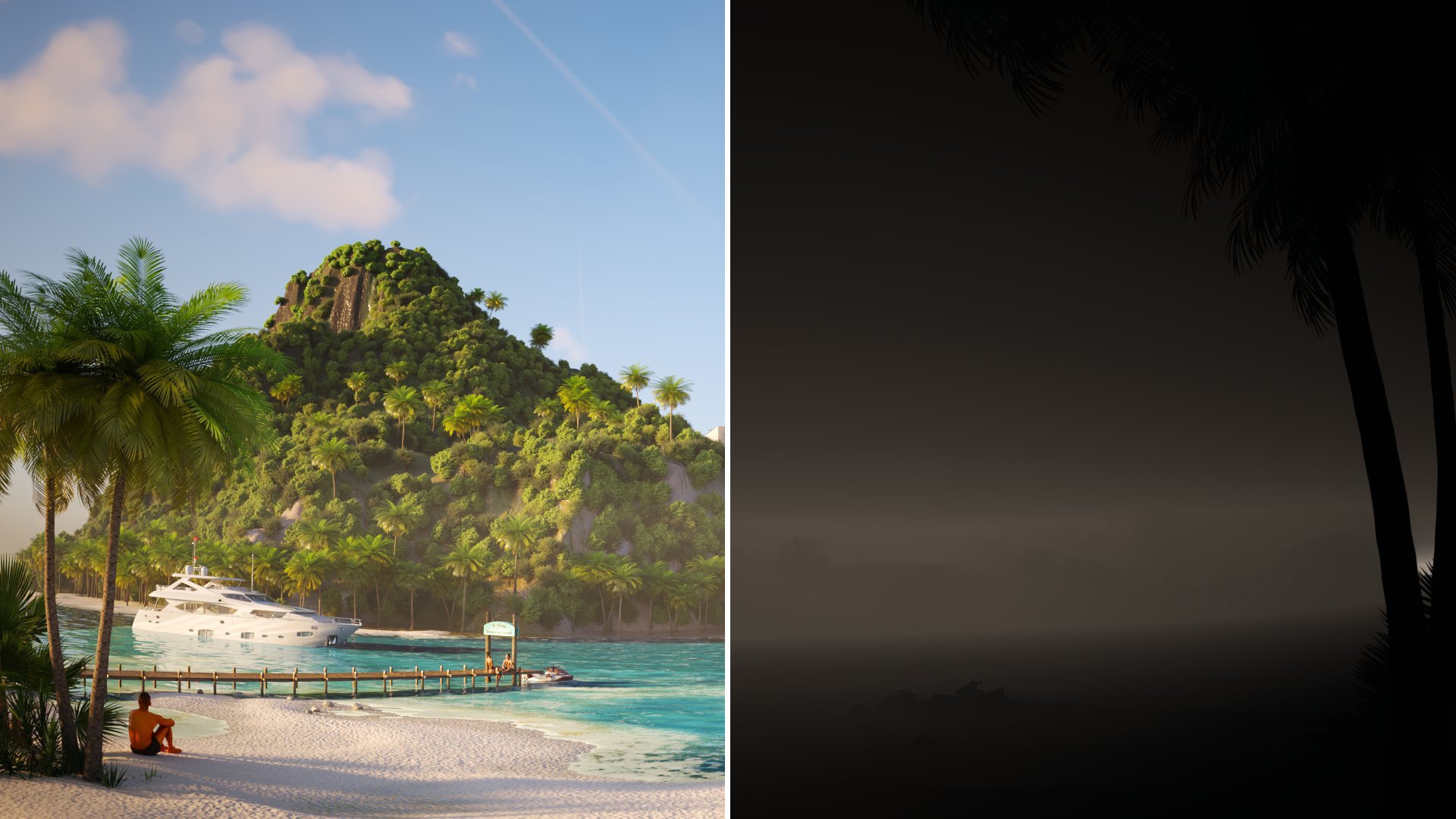

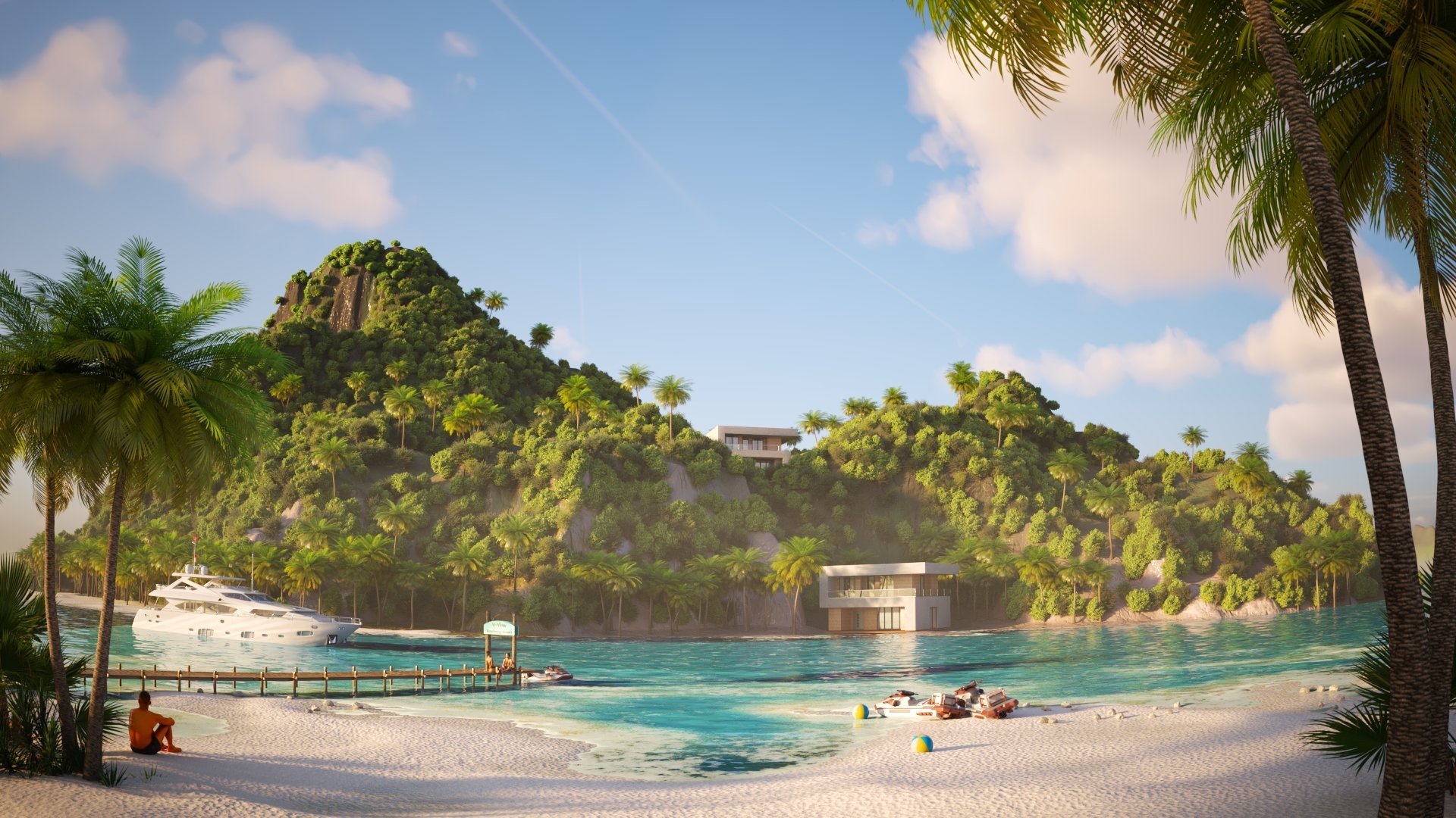

In this example, the fog density in the scene is increased after rendering using the Atmospheric Effects Render Element. A Color Balance layer is also applied to the Atmospheric Effects to adjust the color of the fog.
Before
After
