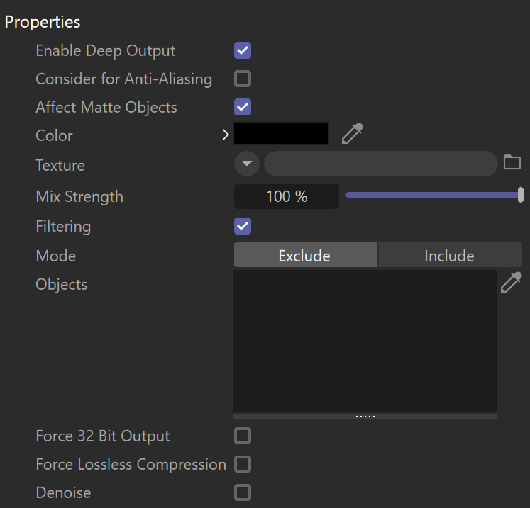

Properties
Enable Deep Output – Specifies whether to include this render element in deep images.
Consider for Anti-Aliasing – When enabled, anti-aliasing is used where possible.
Affect Matte Objects – Determines whether to include matte objects when generating the render element.
Color – Applies a color to this channel.
Texmap – Allows a bitmap or a procedural texture to be connected.
Filtering – Applies an image filter to this channel.
Exclude – Specifies a set of objects to be excluded from the Extra Tex channel.
Include – Specifies a set of objects to be included in the Extra Tex channel.
Force 32 Bit Output – When enabled, stores the Extra Texture render element as a 32-bit float even when writing a 16-bit raw image. This option applies only to multichannel .exr files.
Force Lossless Compression – When enabled, lossy DWAA/DWAB compression is not applied to the Extra Tex data stored in a multichannel exr. This option applies only to multichannel .exr files.
Denoise – Enables the render element's denoising, provided the Denoiser render element is present.
