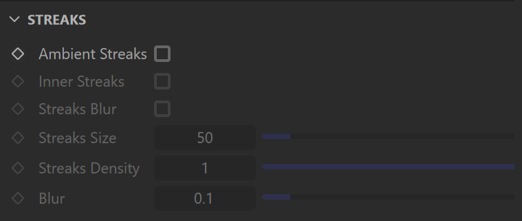

Streaks
Ambient Streaks Draws streaks across the dirt effect, respective to the ambient occlusion.
Inner Streaks – Draws streaks across the dirt effect respective to the inner occlusion.
Streaks Blur – When enabled, blurs the dirt streaks. Bear in mind that a new algorithm is calculating this effect, and the visual representation of the streaks is different.
Streaks Size – Controls the thickness of all streaks.
Streaks Density – Controls the density of the streaks.
Blur – Controls the amount of the blur of the streaks.
