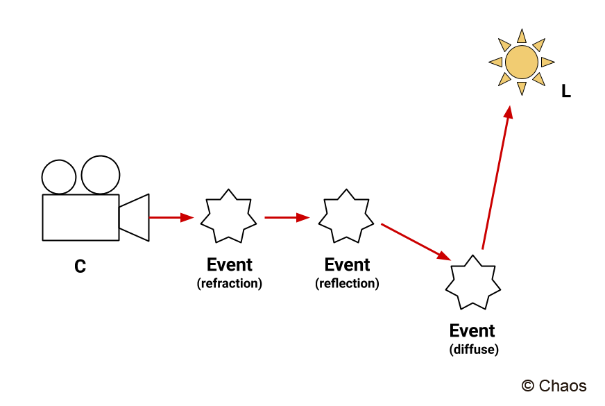

Generally speaking, in ray tracing, we shoot rays from a virtual camera. Those rays hit different surfaces in the scene and bounce between objects until they are finally terminated at a light source.
Light Path Expressions follow the path of a ray and allow us to ask specific ray hits (which we call events) to be recorded. A ray, and the way an expression is built, always starts from the camera and ends at a light source. The different ray hit events in between are what we capture with LPEs.
To understand how this works, let’s look at the different symbols that make up an expression.
  1. Starting from the camera, we use the C symbol to designate it.
  2. When the ray hits a surface and starts bouncing in the scene, we record these ray hit events. In the first series of simple examples, we will not look at the events themselves. We will look at the ray hit events in the next section, where we explain Ray Spawn events and Ray Scatting types.
  3. Finally, the ray path is always terminated at a light source, which can be a light (L), a self-illuminating object (O), or the background (B), and is designated with these 3 symbols at the end of the expression.
In a simple example, the path or a ray can be represented this way: camera -> event -> light source.

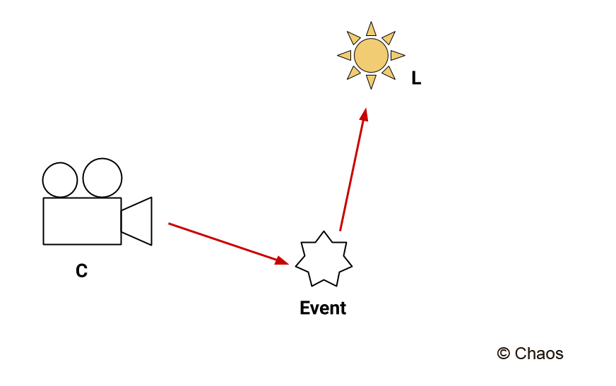

A single event example - the ray starts from the camera, an event (hit) occurs, and the ray is terminated at a light source
Leave the Light Select set empty for contributions from all scene lights, the environment, or emissive objects.
Add lights to the Light Select set if you want to filter only their contribution.

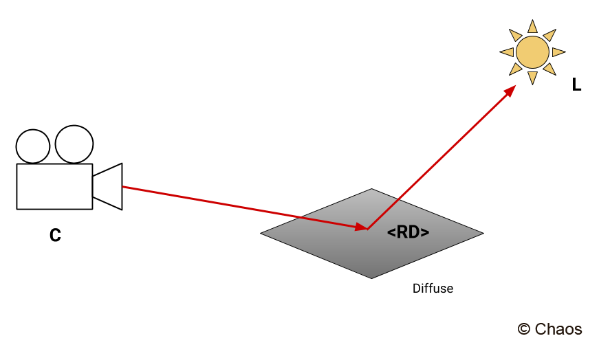

A single diffuse reflection hit.
C<RD>L (Lighting)

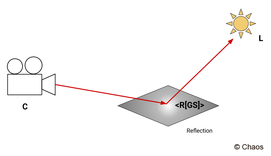

A single hit for glossy and singular reflection.
C<R[GS]>L (Direct Specular)

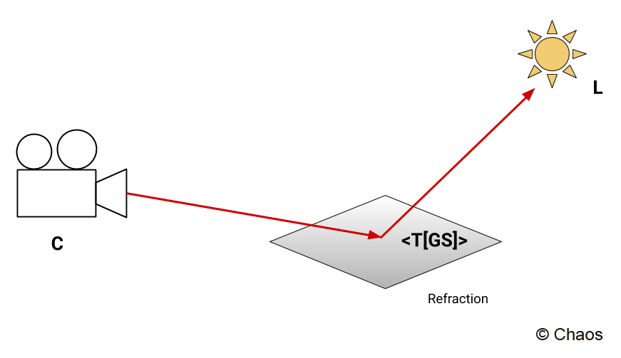

Glossy and specular refraction.
C<T[GS]>L (Refraction)

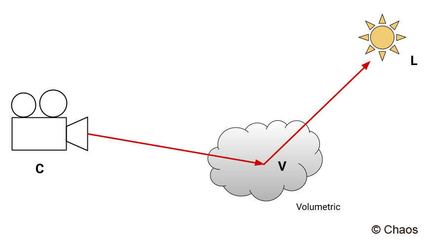

A single volumetric event.
 CVL

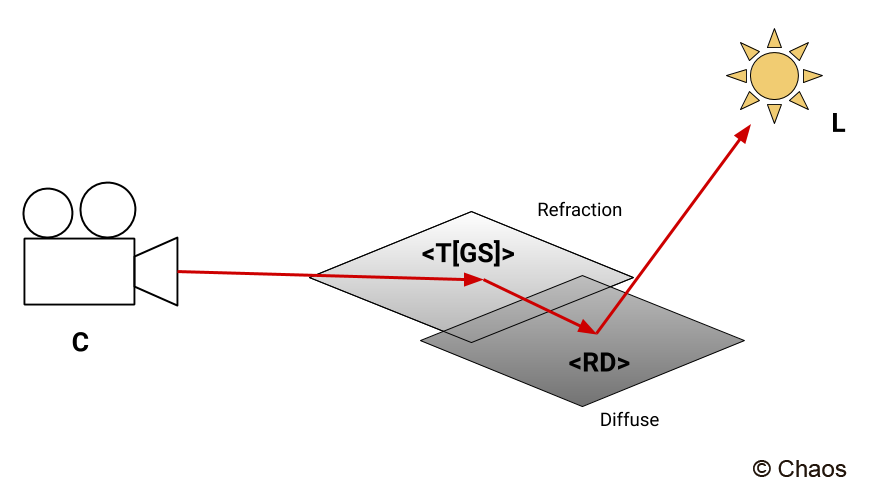

Multiple events: Glossy and specular refraction followed by diffuse reflection.
 C<T[SG]><RD>L
