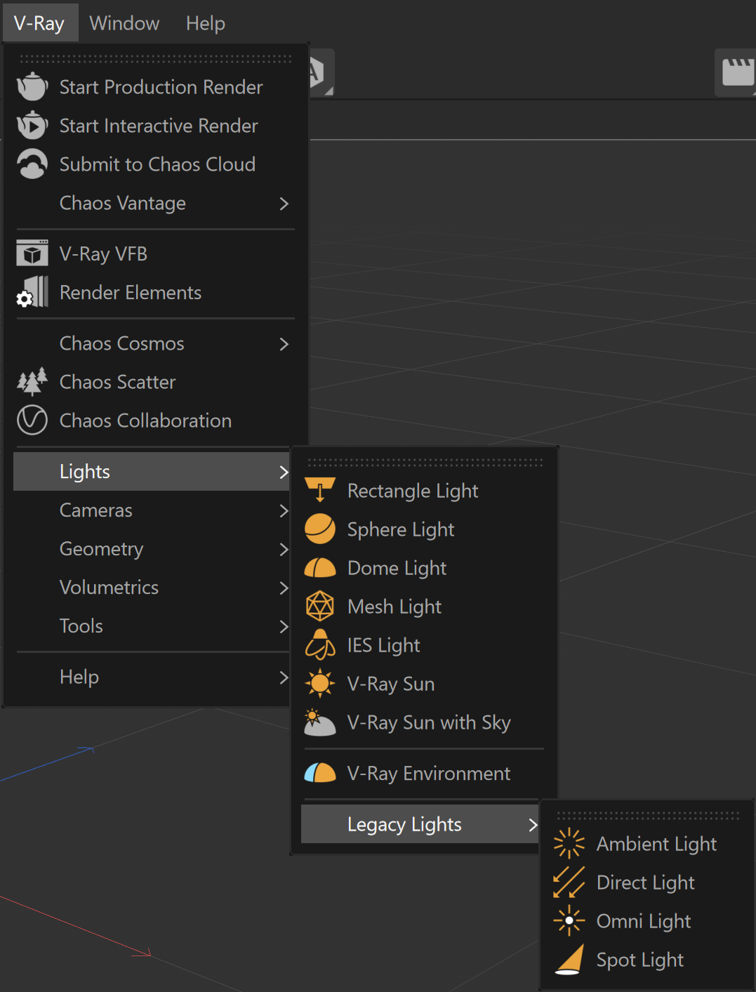

This page provides information about the Omni light in V-Ray for Cinema 4D.
The V-Ray Omni Light or Point Light can be used to create a physically accurate light. It emits light from a single location in all directions.

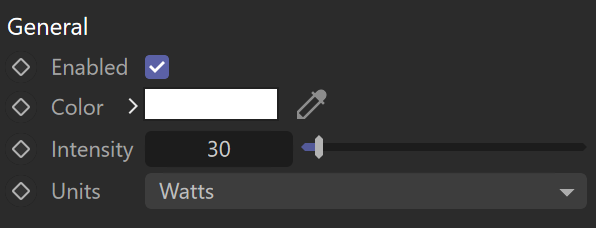

General
Enabled – Turns the light on and off.
Color – Determines the color of the light.
Intensity – Multiplier for the light strength. The units of the intensity are set by the Units parameter.
Units – Specifies the light units. Using correct units is essential when using the V-Ray Physical Camera. The light automatically takes the scene's unit scale into consideration to produce the correct result for the scale you are working with. The possible values are:
Default – The color and multiplier directly determine the visible color of the light without any conversion. The light surface appears with the given color in the final image when seen directly by the camera (assuming there is no color mapping involved).
Lumens – Total emitted visible light power measured in lumens. When this setting is used, the intensity of the light does not depend on its size. A typical 100W electric bulb emits about 1500 lumens of light.
Lm/m/m/sr – Visible light surface power measured in lumens per square meter per steradian. When this setting is used, the intensity of the light depends on its size.
Watts – Total emitted visible light power measured in watts. When this setting, the intensity of the light does not depend on its size. Keep in mind that this is not the same as the electric power consumed by a light bulb for example. A typical 100W light bulb only emits between 2 and 3 watts as visible light.
W/m/m/sr – Visible light surface power measured in watts per square meter per steradian. When this setting is used, the intensity of the light depends on its size.

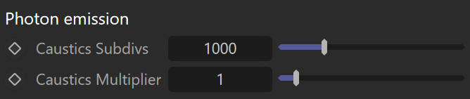

Photon emission
Caustics Subdivs – Only used when calculating Caustics. Lower values mean more noisy results but render faster. Higher values produce smoother results but take more time.
Caustics Multiplier – This value is a multiplier for the generated caustics by the selected object. Note that this multiplier is cumulative - it does not override the multiplier in the Caustics render settings rollout section.

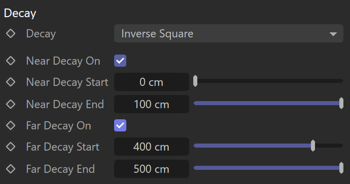

Decay
The Decay parameters determine how the light fades in and out. The Near Decay determines how light fades in. The light isn't at its maximum value at its source, but instead gradually increases until it reaches the Near Decay End. The Far Decay determines how light fades out. The light isn't at its maximum value at its end, but instead gradually decreases after the Far Decay Start.
The Decay options are useful for creating hotspots or controlling the length of a "God Rays" effect created with Environment Fog.
Decay – Controls how quickly the light fades.
None – The light does not fade at all, unless obstructed.
Linear – The light intensity fades with the inverse of the distance, in a linear fashion. E.g. at a distance of 5 units, the intensity is 1/5th of the intensity of the emitter.
Inverse Square – The light fades with the inverse square of the traveled distance. This is physically correct light propagation. For example, at a distance of 5 units, the intensity is 1/25th of the intensity of the emitter.
Near Decay On – Toggles near decay on and off.
Near Decay Start – Determines where the fade in starts. Anything before this point is rendered dark.
Near Decay End – Determines where the fade in ends. After this threshold, the light is at its full value.
Far Decay On – Toggles far decay on and off.
Far Decay Start – Determines where the fade off starts.
Far Decay End – Determines where the light reaches a value of 0, i.e. completely fades off.

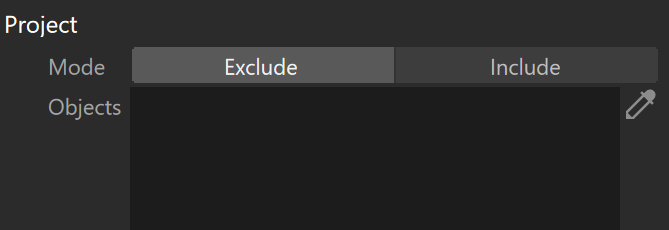

Project
Mode – Specifies whether the objects in the list are considered Included or Excluded from the light's effects.
Objects – Creates a list of objects to be excluded or included. When an object is added to the list, the  icons appear, which determine how the light affects the object. The  icon controls whether the emitted light affects the object. The  icon controls whether the shadows caused by the light affect the object. The  determines whether the object's children are affected.
