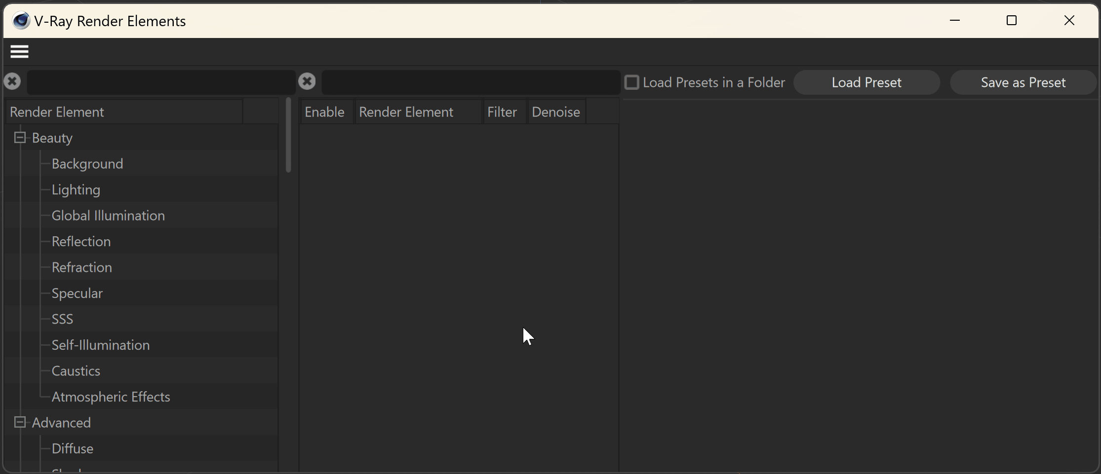

How to add a render element to a scene.

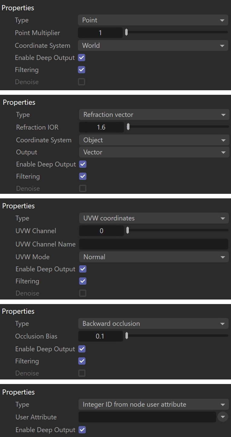

Properties
Type – Controls the type of render element produced by the Sampler Info element:
  • Point – The X, Y, and Z coordinates of the point are converted to RGB data according to the Coordinate System that is set. This outputs a Position Pass for use in compositing.
  • Normal vecNormal vector with bump mappingtor – The direction of the normal at the particular shaded point, according to which the Coordinate System is set.
  • Reflection vector – Commonly used for adjusting reflections in the composite.
  • Refraction vector – Commonly used for adjusting refractions in the composite.
  • UVW coordinates – Extracts the UVW coordinates of the object at the particular shaded point. This can be used to apply another texture at a composite level.
  • Normal vector with bump mapping – Produces the bump normal, according to the Coordinate System that is set.
  • Backward occlusion – The red and green components of this render element represent the screen position of the shaded point at the beginning of the motion-blurred frame, while the blue component represents camera occlusion at the beginning of the motion-blurred frame. This can be used for denoising and/or post-process motion blur.
  • Forward occlusion – The red and green components of this type represent the screen position of the shaded point at the end of the motion-blurred frame, while the blue component represents camera occlusion at the end of the motion-blurred frame. This can be used for denoising and/or post-process motion blur.
  • Integer ID from node user attribute – Extracts any integer node user property into an integer render element. Can be used as an extended Object ID. Supports both V-Ray and Mograph user attributes.
  • Float number from node user attribute – Extracts any floating-point node user property into a single-channel floating-point render element. Can be used to extract additional masks. Supports both V-Ray and Mograph user attributes.
  • Color from node user attribute – Extracts any color node user property into a color render element. Can be used for masking in post-production. Supports both V-Ray and Mograph user attributes.
  • Face index in mesh – Correlates points between separate bakings of the same mesh.
  • Barycentric coordinates from face – Displays the Barycentric coordinates of the rendered objects.
  • Tangent vector in object space – Displays tangent vector according to the object space.
  • Bitangent vector in object space – Displays bitangent vector according to the object space
Point Multiplier – Acts as a multiplier when Type is set to Point.
Refraction IOR – Sets the index of refraction when the Type is set to Refraction vector.
Coordinate system – Determines the coordinate system used:
World – X, Y, and Z coordinates (in world space) of the point are converted to RGB data.
Object – X, Y, and Z coordinates (in object space) of the point are converted to RGB data.
Camera – X, Y, and Z coordinates (in camera space) of the point are converted to RGB data.
Relative – X, Y, and Z coordinates in the object space of the Relative Node are converted to RGB data.
Output – Controls the way data is stored in the render element. Available for all vector Types and face Types.
Vector – Values are stored directly without modification, including negative components.
Color – Values are scaled down by 0.5 and offset by 0.5 so that (0, 0, 0) maps to (0.5, 0.5, 0.5), (-1, -1, -1) maps to (0, 0, 0) and (1,1,1) maps to (1,1,1). This avoids negative values which might be necessary for some compositing packages.
UVW Channel – The UVW mapping channel used when the Type is set to UVW coordinates, Tangent / Bitangent vector in object space, if no UVW Channel Name is specified.
UVW Channel Name – The default UVW mapping channel used when the Type is set to UVW coordinates. Specifies the UVW Channel to render by the name of the UV set.
UVW Mode – Specifies what happens to UVW values outside the 0.0-1.0 range of the unit texture square:
Normal – Stores the UVW coordinates without modification.
Clamp – UVW coordinates above 1.0 are clamped to 1.0, and values below 0.0 are clamped to 0.0.
Tile – Wraps the UVW coordinates to the unit texture square.
Occlusion Bias – Controls the positional bias of the Backward occlusion and  Forward occlusion types in order to prevent incorrect self-occlusion.
User Attribute – Determines which user attribute to connect to when a user attribute Type is selected..
Enable Deep Output – Specifies whether to include this render element in deep images.
Filtering – Applies an image filter to this channel. This option is not available for the user attribute Types and the Face index in mesh Type.
Denoise – Enables the render element's denoising, provided the Denoiser is enabled. This option is not available for the user attribute Types and the Face index in mesh Type.

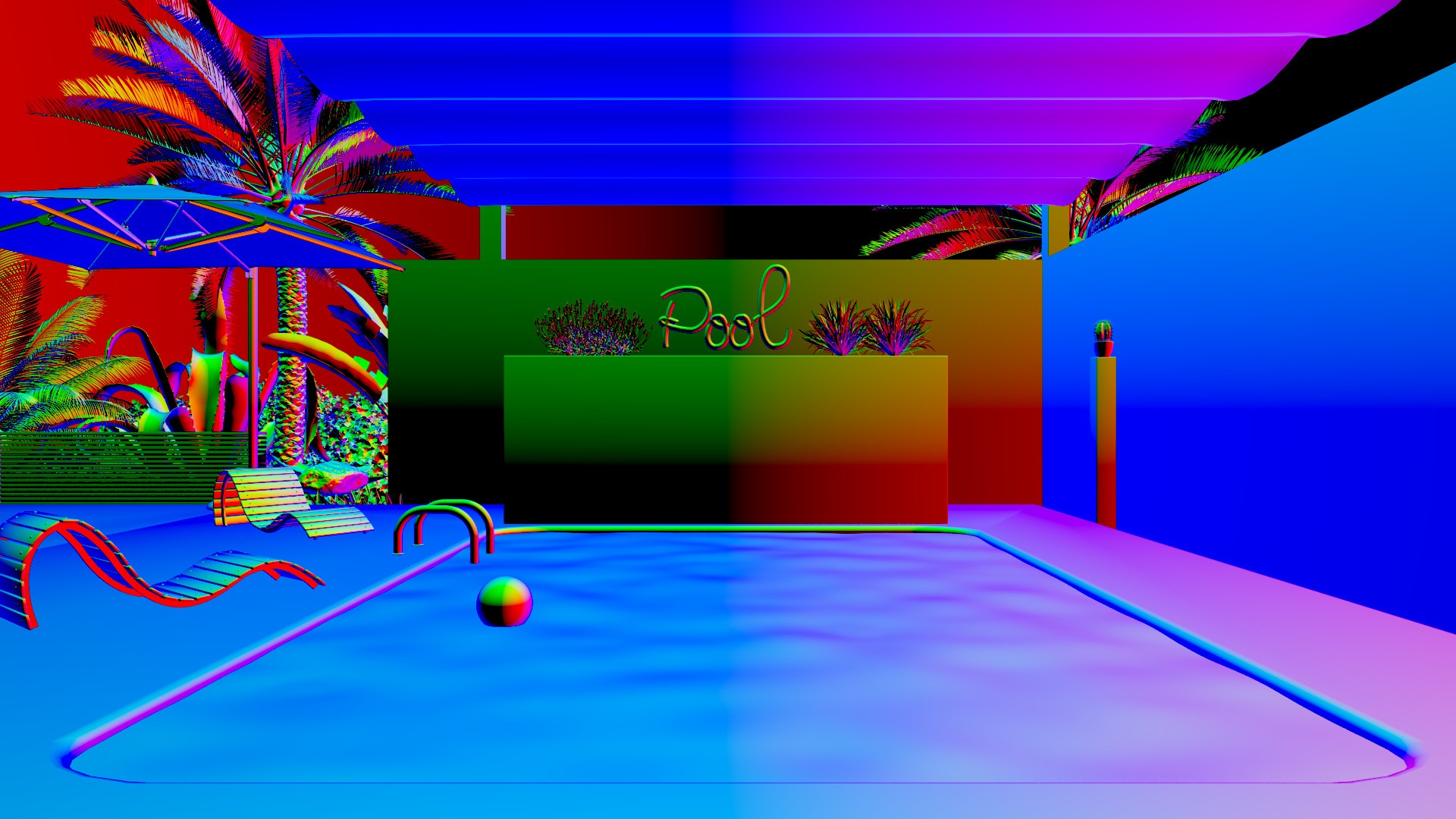

Point Type in World Coordinates

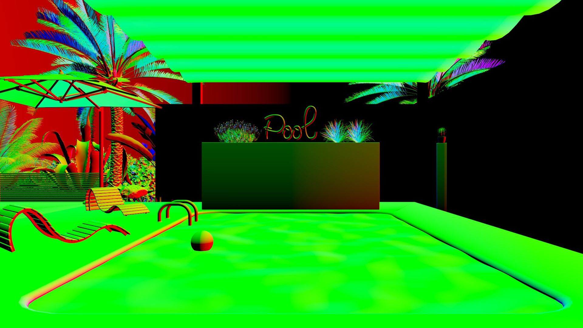

Normal vector Type in World Coordinates

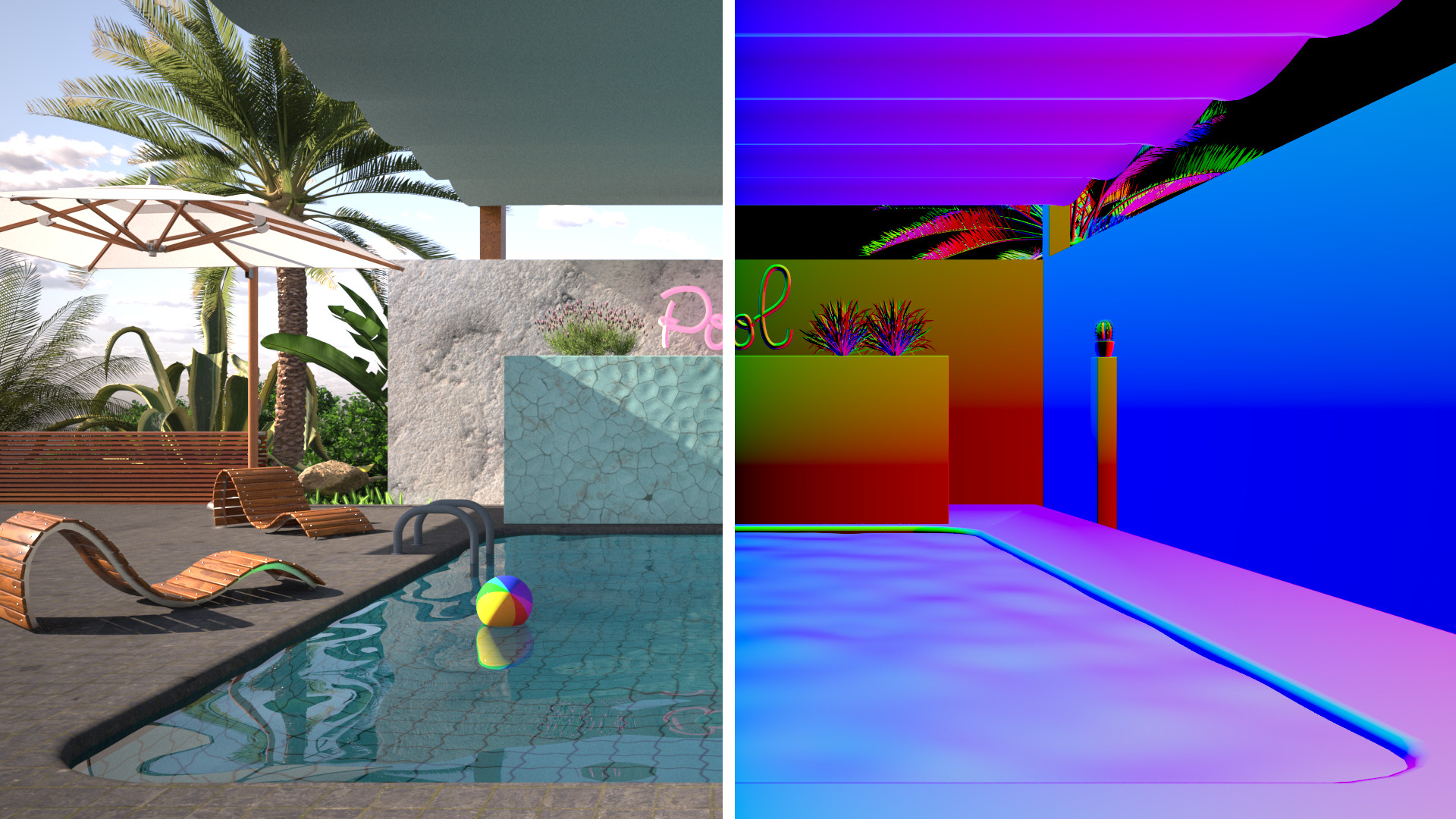

Reflection vector Type in World Coordinates

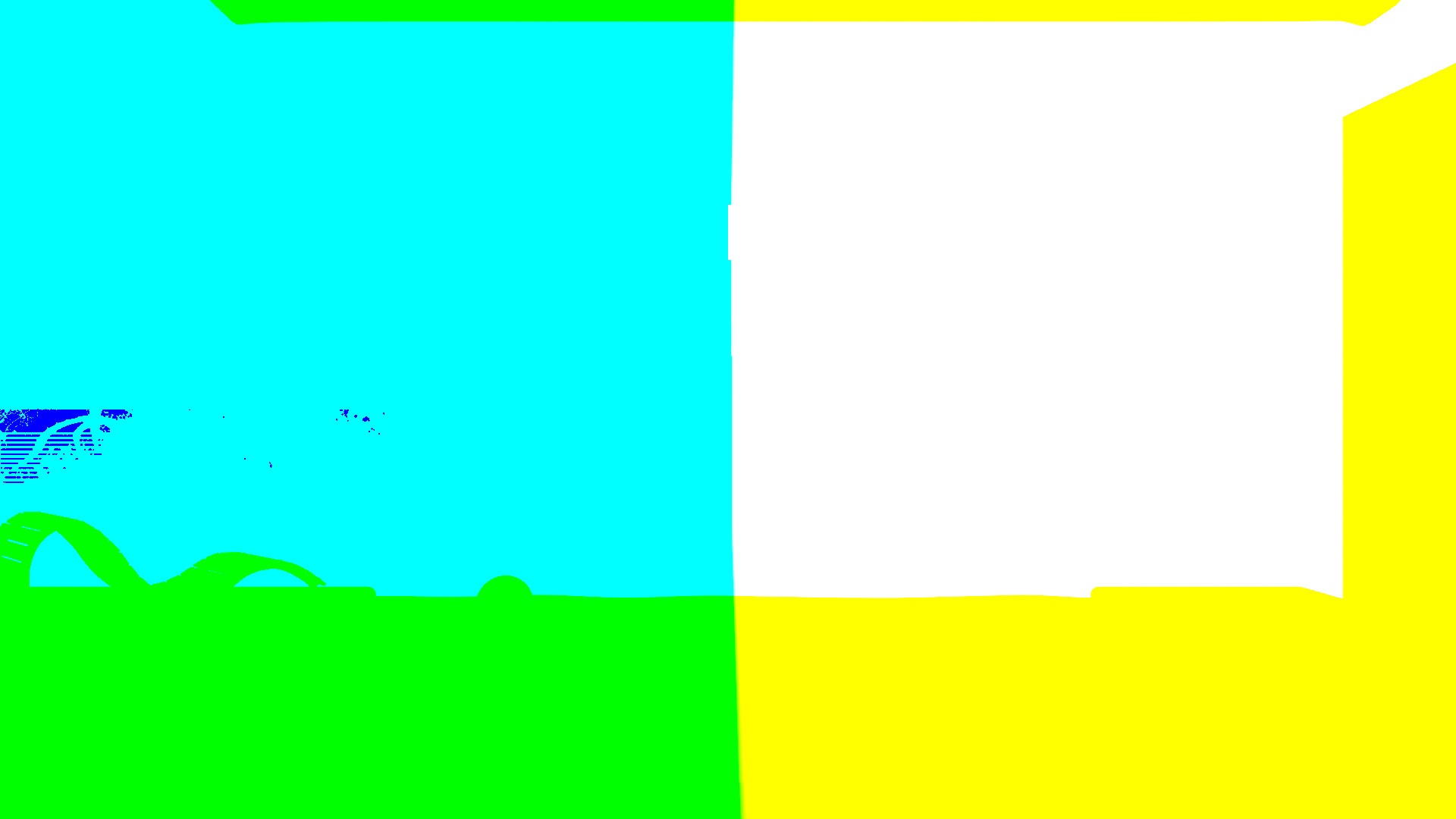

Refraction vector Type in World Coordinates
