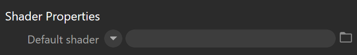

Shader Properties
Default shader – If a material uses some opacity texture in addition to the Scatter Edge Trimming shader, this texture can be defined here.

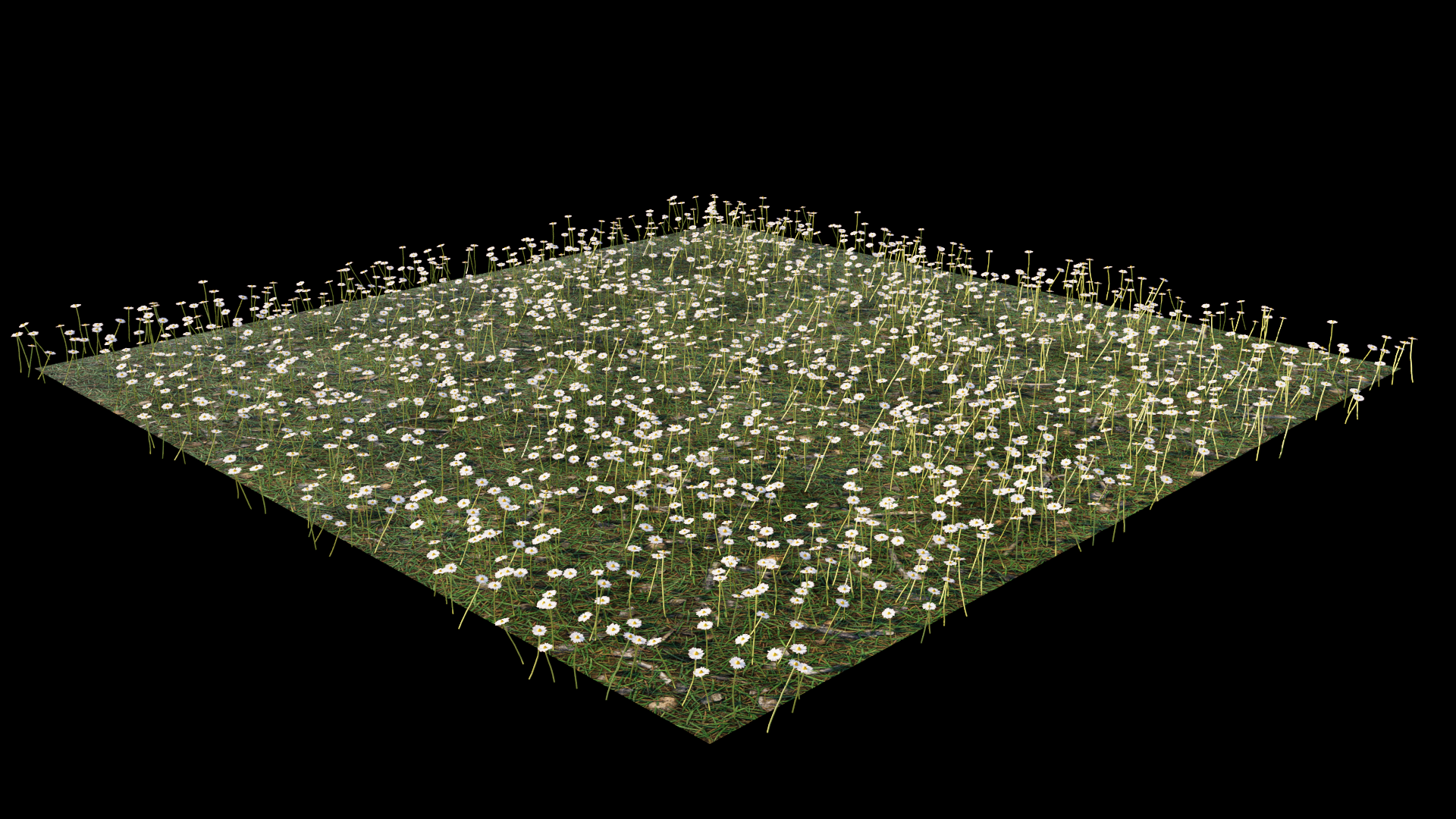

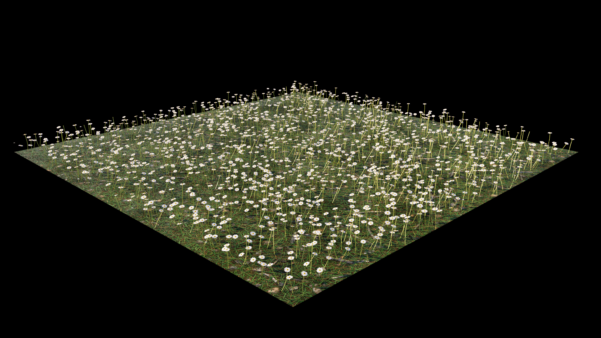

Example: Scatter Edge Trimming
See the instances before and after the Scatter Edge Trimming texture is applied.
Before
After
