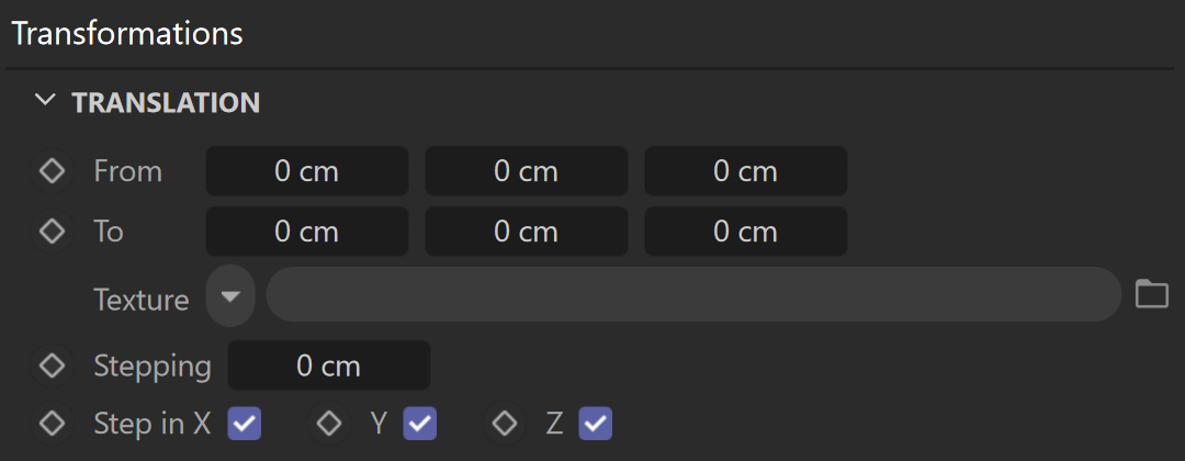

Translation
From/To – Specifies the translation range for the X, Y, and Z axes, in world units.
Texture – Specifies the texture map or shader to use for translation.
Stepping – When nonzero, switches the random translation from a continuous to a discrete one, with steps specified by this parameter value. The From and To values are still used as bounds. This effect is used only for the selected axes.
Step in X, Y, Z – Defines the axes affected by the Stepping value.

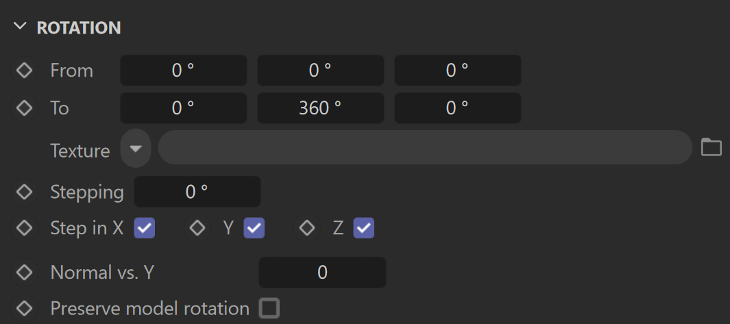

Rotation
From/To – Specifies the rotation range for the X, Y, and Z axes, in degrees.
Texture – Specifies the texture map or shader to use for rotation.
Stepping – When nonzero, switches the random rotation from a continuous to a discrete one, with steps specified by this parameter value. The From and To values are still used as bounds. This effect is used only for the selected axes.
Normal vs. Y – Defines the instanced object's orientation, using the base object's normals. A value of 1 means instanced objects remain vertical, regardless of the base object's normals direction, while a value of 0 means instanced objects are oriented according to the base object's normals.
Preserve model rotation – When enabled, instances preserve the original rotation of their models (instanced objects). Otherwise, the original rotation is ignored.

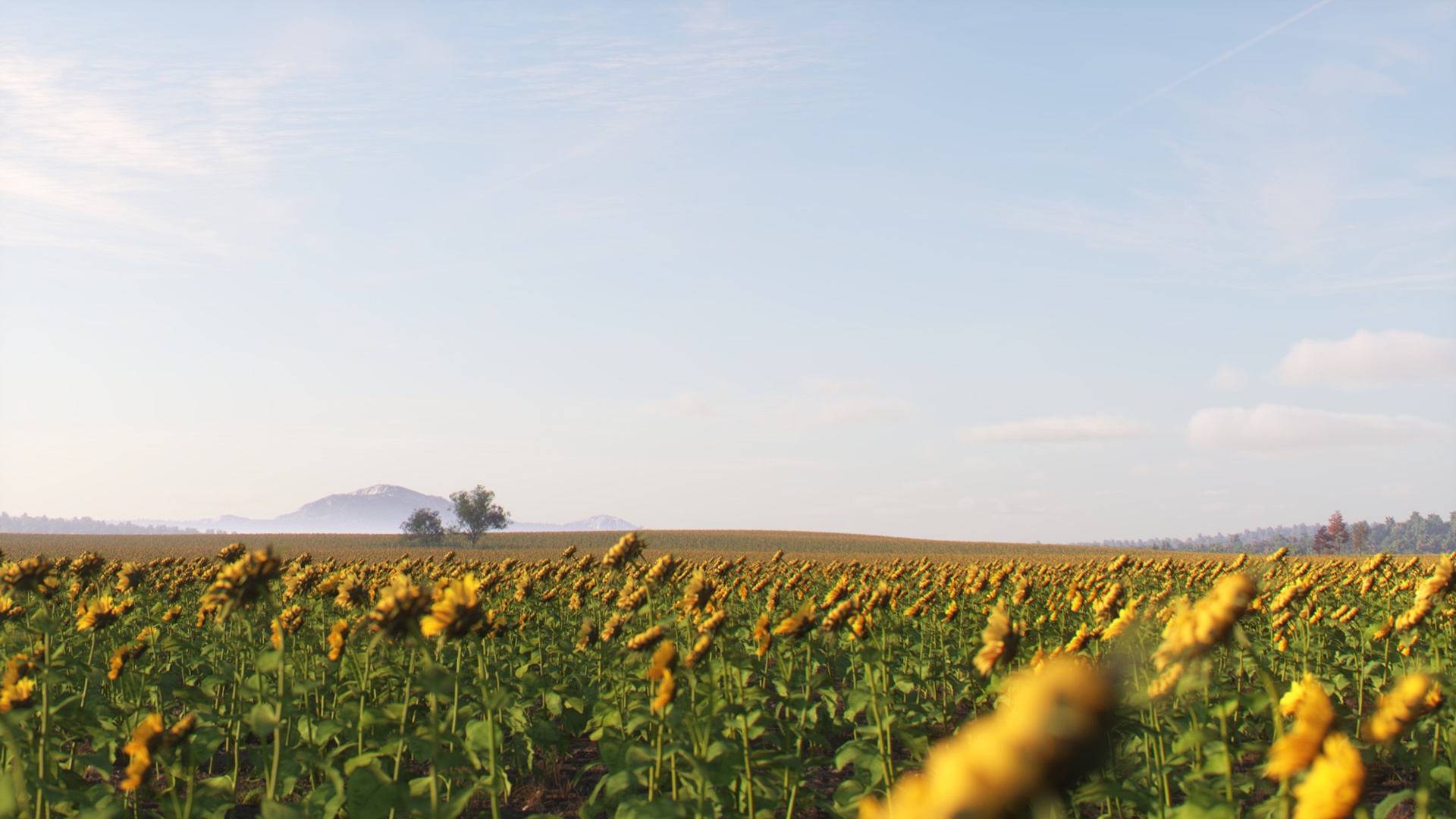

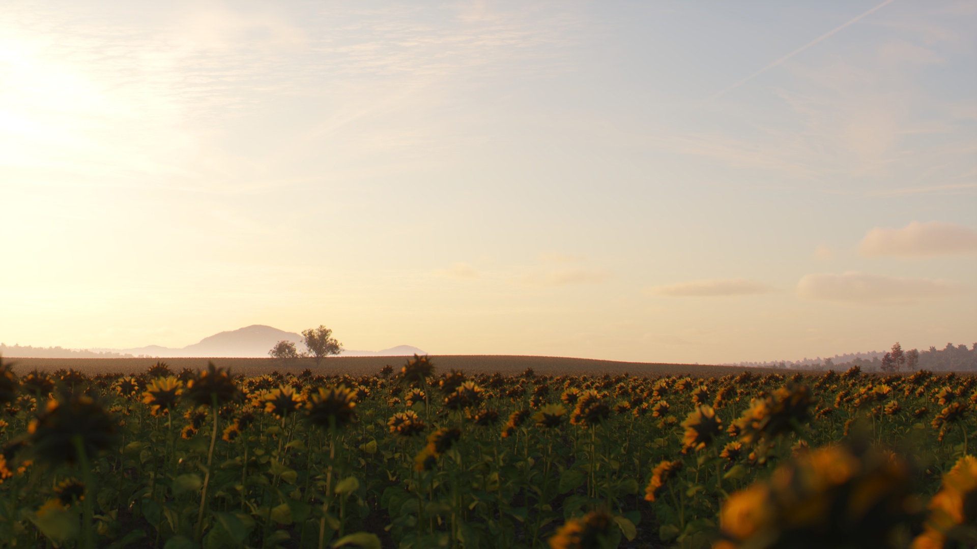

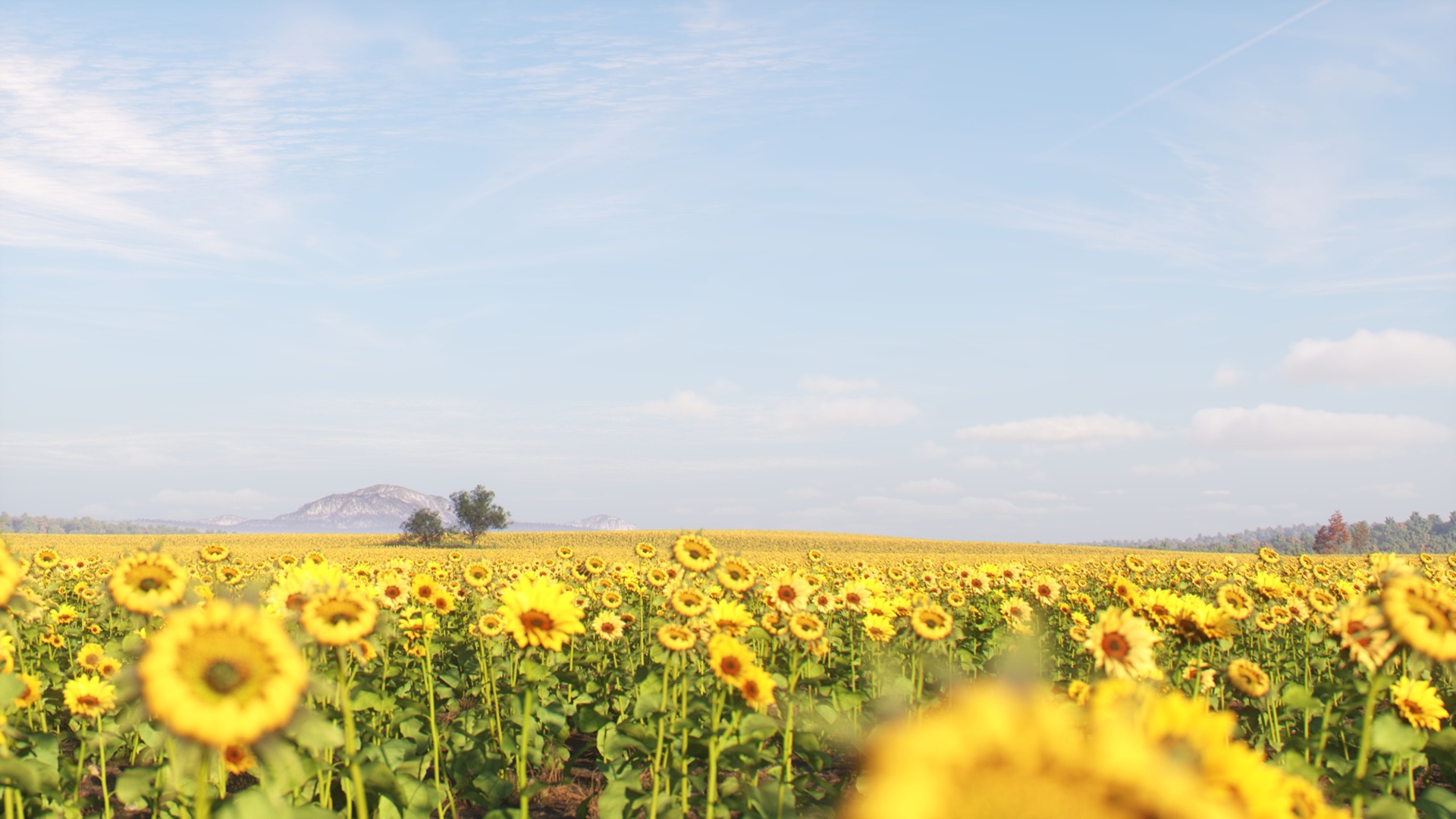

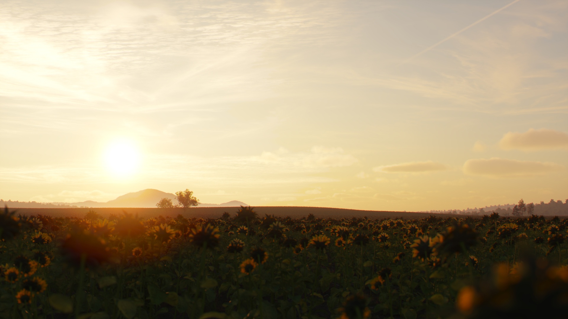

Example: Look At
In this example, the sunflower objects are scattered along the plane. The Sun Light is assigned as the Target object, and it is moved along the sky as if it were setting over the horizon. The Horizontal option is enabled, allowing the sunflowers to rotate more realistically. Slide through the images to see the movement of the sunflowers.

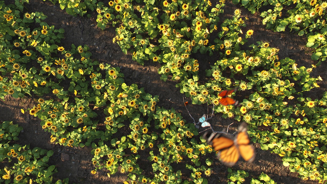

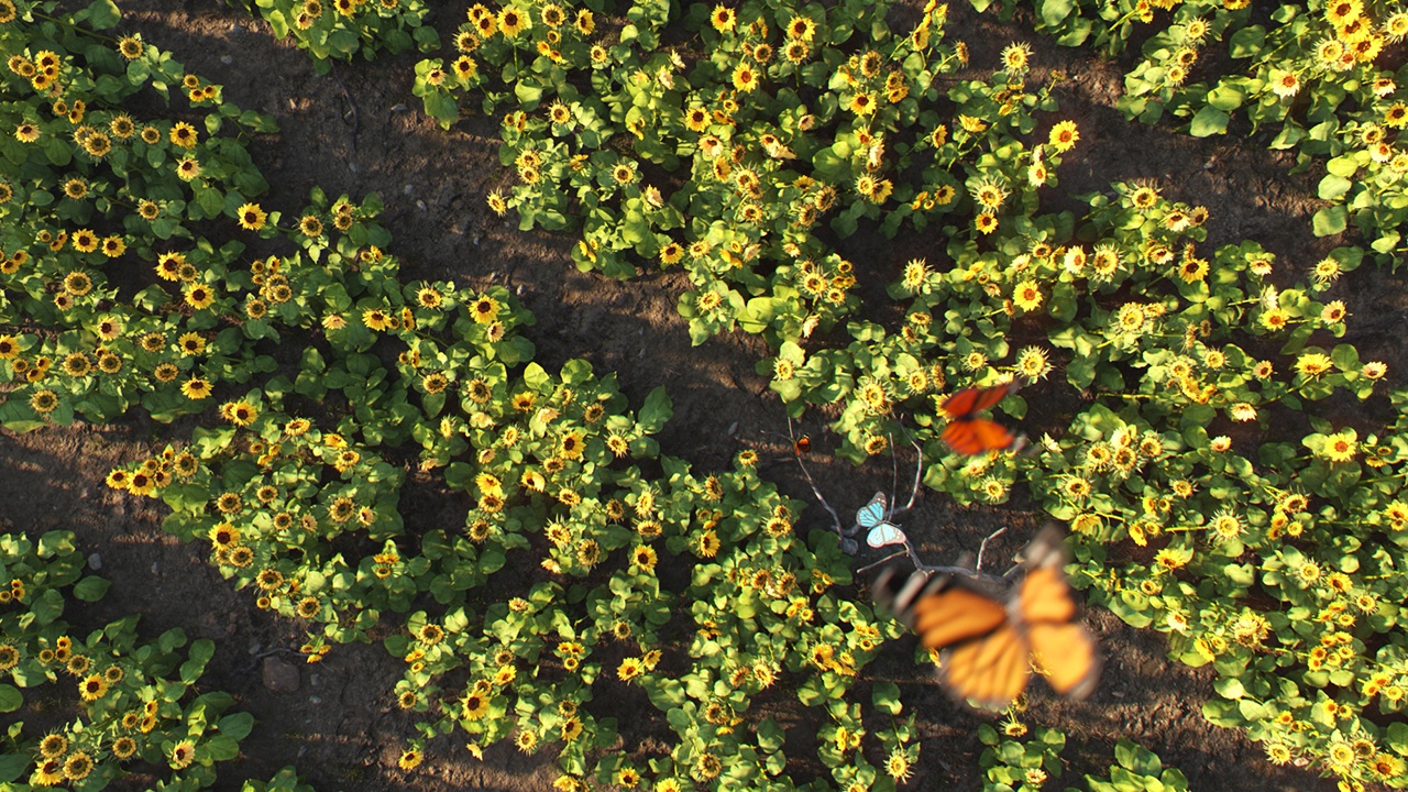

Example: Look At Falloff Distance
In this example, the sunflowers are looking at the blue butterfly. Adding Falloff Distance creates an area around the Target object where the effect is applied. Having the value at 0 applies the effect to the entire scattered geometry. Scrolling through the examples quickly reveals the area which remains affected.
Falloff Distance = 0cm
Falloff Distance = 300cm
Falloff Distance = 900cm
