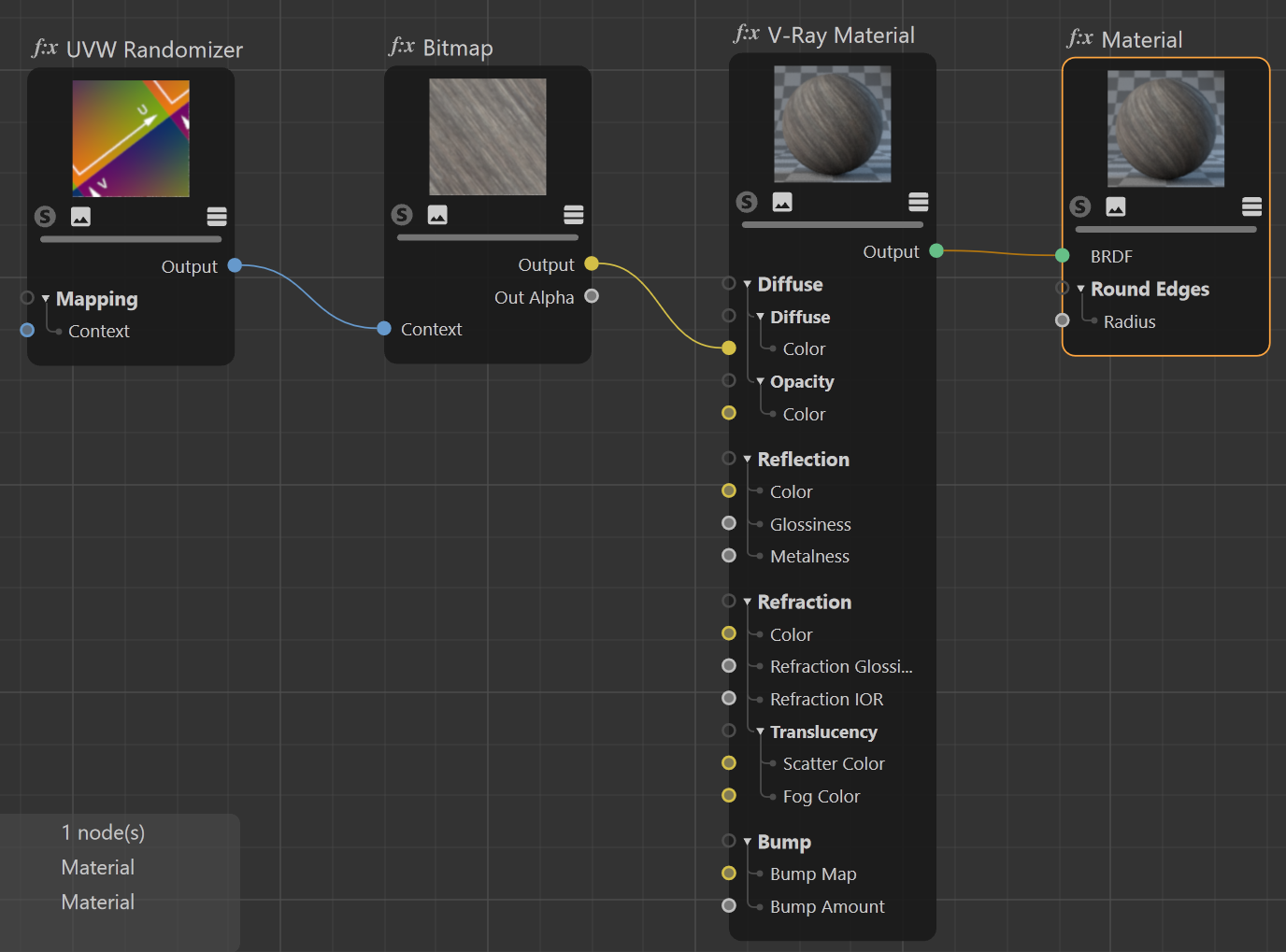

The UVW Randomizer node allows applying random offset, rotation and scale to texture nodes, assigned to a single object with different Face IDs or different objects.
Note, that the UVW Randomizer's output can only be connected to the Context input of a Bitmap.
Note also that the Randomizer itself has a Context input port. Even though the Randomizer is a Context node, it can have another Context node attached to it. Refer to the Context section of this page for more.

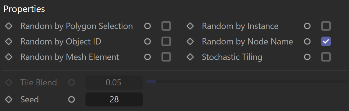

Properties
Random by Polygon Selection – Considers the face IDs (from unique polygon selections) of the object when feeding the data (color or texture) to the material.
Random by Object ID – Considers the Object IDs of the object when feeding the data (color or texture) to the material.
Random by Mesh ElementAssigns random colors based on the object's element (e.g., teapot lid, etc.) IDs.
Random by Instance – Assigns random colors based on the InstanceID (works for Alembic instances and VRayInstancer source objects).
Random by Node Name – Considers the node name when feeding the data to the material.
Stochastic Tiling – Changes the mapping based on the UV tile.
Tile Blend – Edge blending between adjacent tiles when Stochastic Tiling is used.
Seed – Changes the randomization pattern.

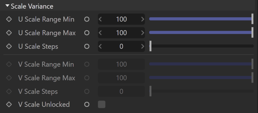

Scale Variance
This rollout controls the variance in the scale parameter.
U Scale Range Min/MaxThe min and max range in which the scale parameters are applied to the U axis.
U Scale Steps – Specifies the number of steps in which the variance interval is achieved on the U axis.
V Scale Range Min/MaxThe min and max range in which the scale parameters are applied to the V axis.
V Scale Steps – Specifies the number of steps in which the variance interval is achieved on the U axis.
V Scale Unlocked – When enabled, the U and V axes can be scaled separately.

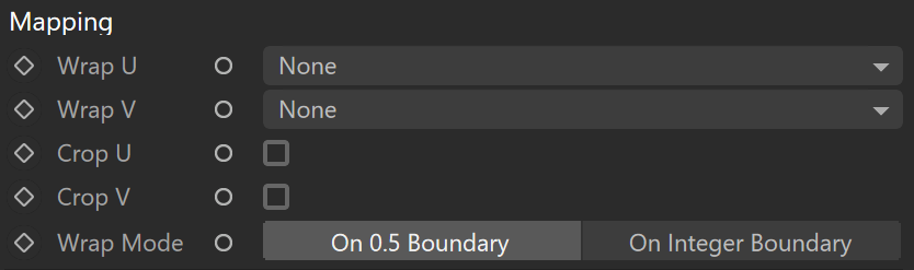

Mapping
Wrap U/V – Controls how the map is wrapped.
None – It is rendered as is.
Tile – Tiles the bitmap.
Mirror TileTiles the bitmap in a mirror pattern.
 Crop U/V – When enabled, crops the map on respective axis.
Wrap Mode – Specifies how to wrap the map:
On 0.5 Boundary
On Integer Boundary
