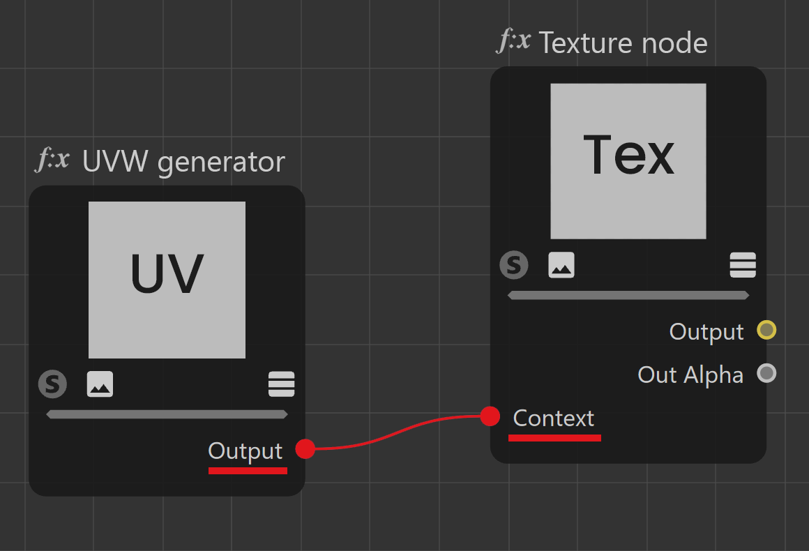

Context nodes (UVW generators) can be connected to texture nodes via the Context port. Context nodes determine how the texture is generated, read, or modified. When no context node is attached, a standard way of projecting textures is used. Some UVW generators only modify the standard generated UVWs, see the example for more. Others create new ones entirely and override the texture node's UVWs, see the example for more.

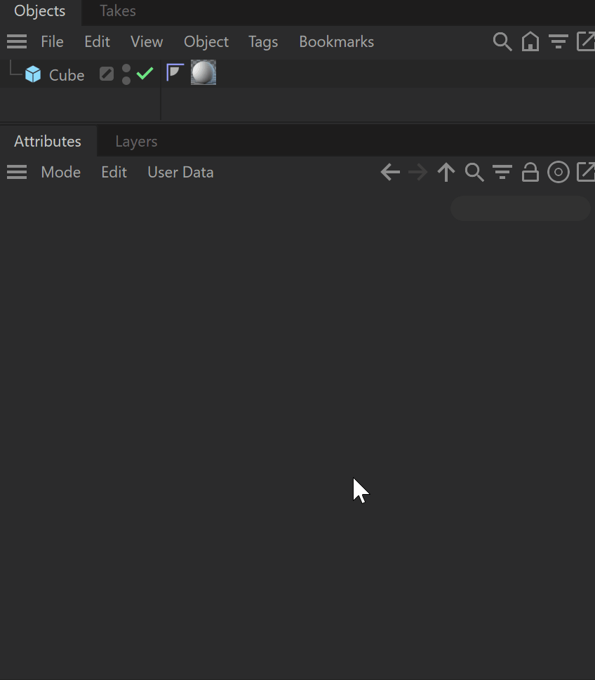

The standard way of projecting textures is defined by the Material tag Properties. You can find the Material Tag in the Objects section, once a material is assigned to the geometry. Clicking on it reveals the Tag tab, where you can modify the texture projection.

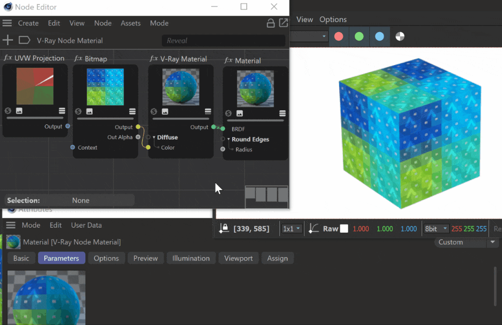

Example: Connecting an Override Context Node
In this example, a UVW Projection node is attached to a Bitmap node. You can see the UVs of the Bitmap change immediately. This is because the UVW Projection generates its own UVs and overrides the ones on the Bitmap. Any changes made to the UVW Projection node are applied to the Bitmap.

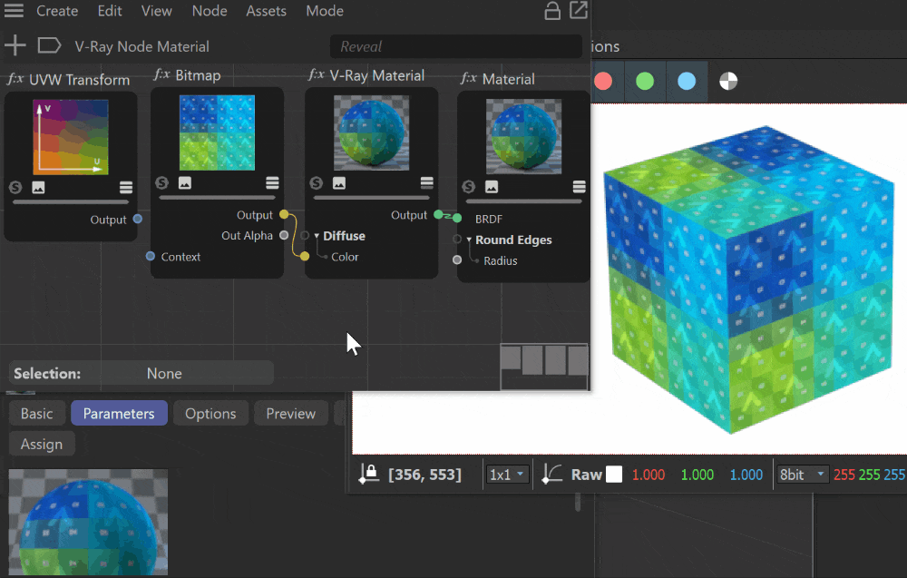

Example: Connecting a Modify Context Node
In this example, a UVW Transform node is connected to a Bitmap node. Nothing happens straight away, as the UVW Transform node does not generate its own UV map. Once changes are made to the UVW Transform, they are applied to the Bitmap. This is because the Transform node modifies only UVWs that are already present, from the texture it is attached to.
