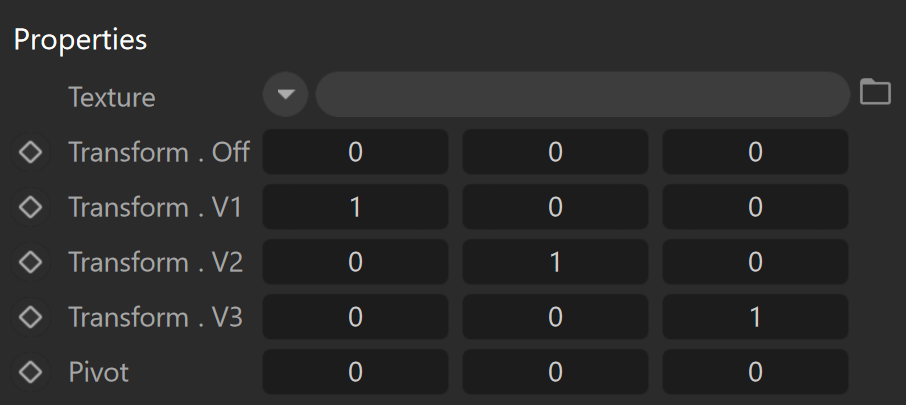

Properties
Texture – Determines the VRayBitmap file to be adjusted.
Transform . Off – Determines whether Transform is applied to the X, Y, and Z axes. Setting this option to 1 on either axis removes the transform adjustments from that axis.
Transform . V1  Controls the map rotation along the X, Y, and Z axes.
Transform . V2  Controls the map scale along the X, Y, and Z axes.
Transform . V3  Controls the map sheer along the X, Y, and Z axes.
Pivot – Determines the coordinates of the pivot point around which the texture is rotated. By default, the pivot is placed in the bottom-left corner of the texture; assigning a different value moves it along the U, V, or W coordinates, respectively. Negative values can also be assigned.
