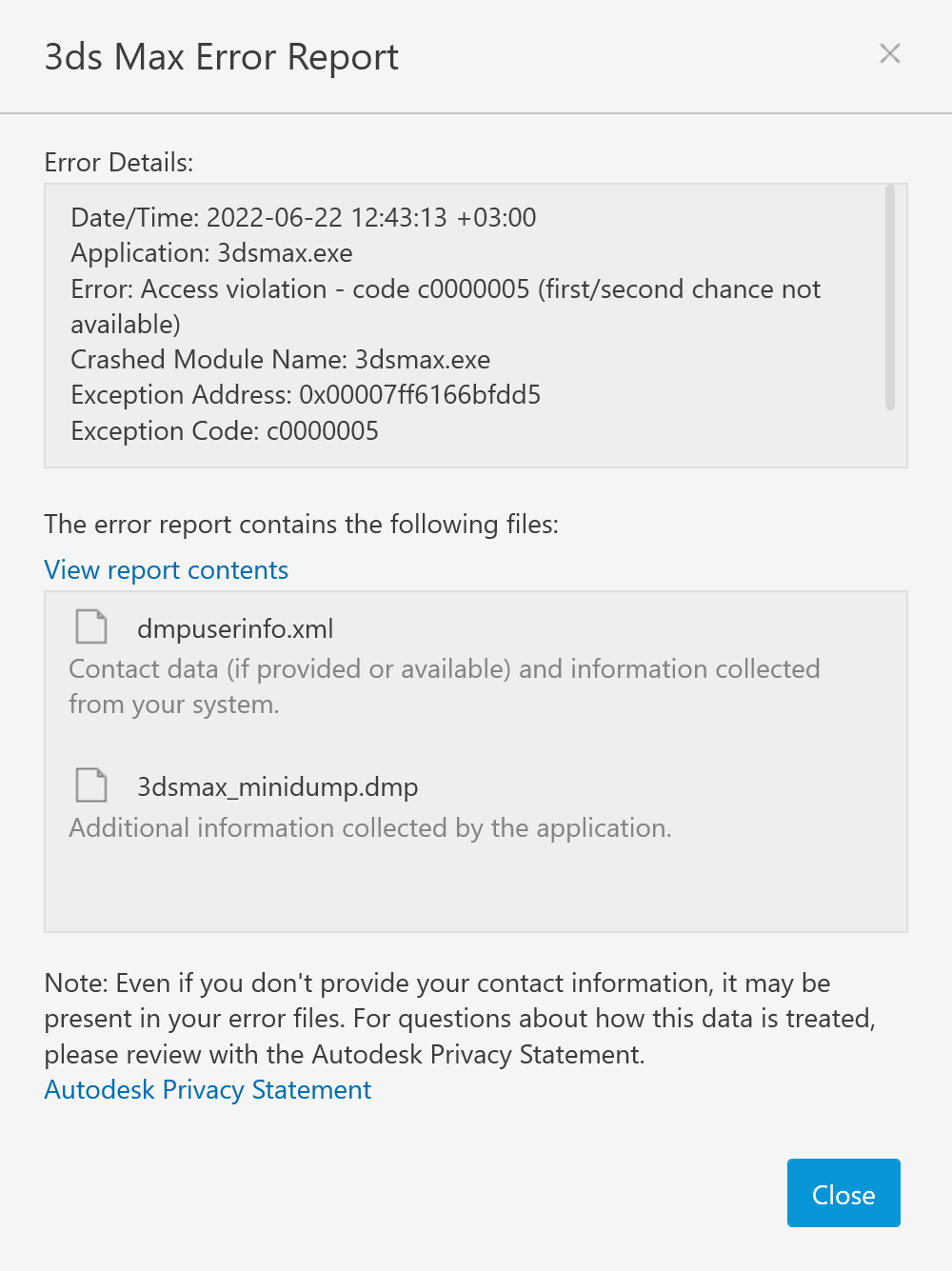

2. Click the View Report Details option for 3d Max 2022 and earlier, or the Report Details option for 3ds Max 2023.
3ds Max 2022 and earlier
3ds Max 2023

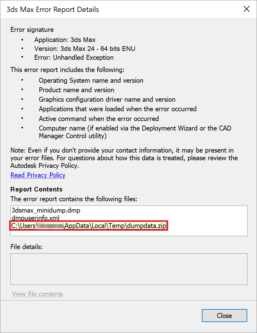

3. In 3ds Max 2022 or earlier, hover your mouse over 3dsmax_minidump.dmp to see its location. In 3ds Max 2023, click View report contents option.
3ds Max 2023

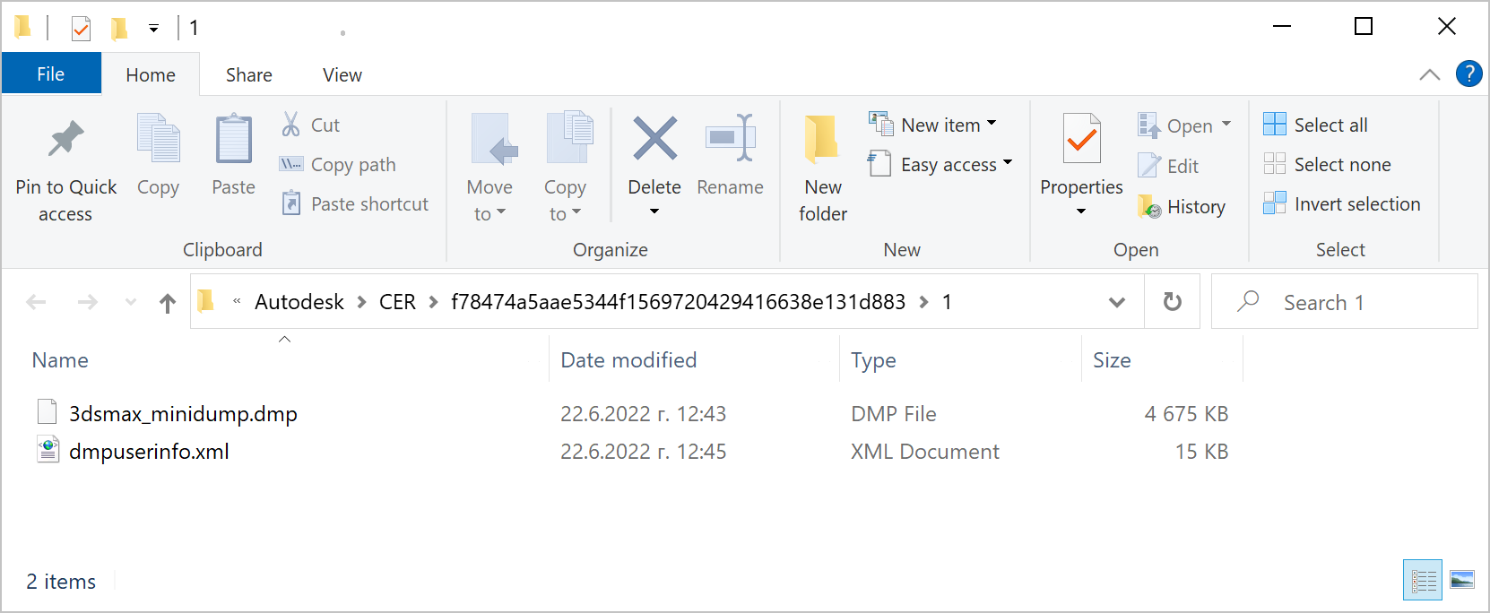

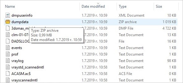

4.  Go to that location and find the .dump file. It is better to send the dumpdata.zip file, if available, as it contains all the necessary dump files.

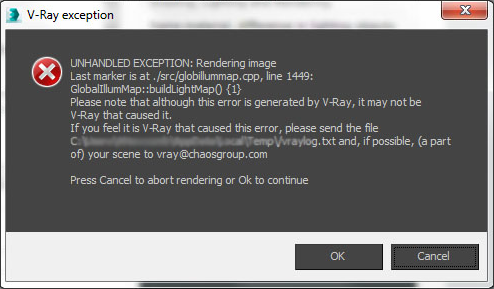

Sometimes 3ds Max freezes without showing the Autodesk Error Report Window or V-Ray exception occurs:
