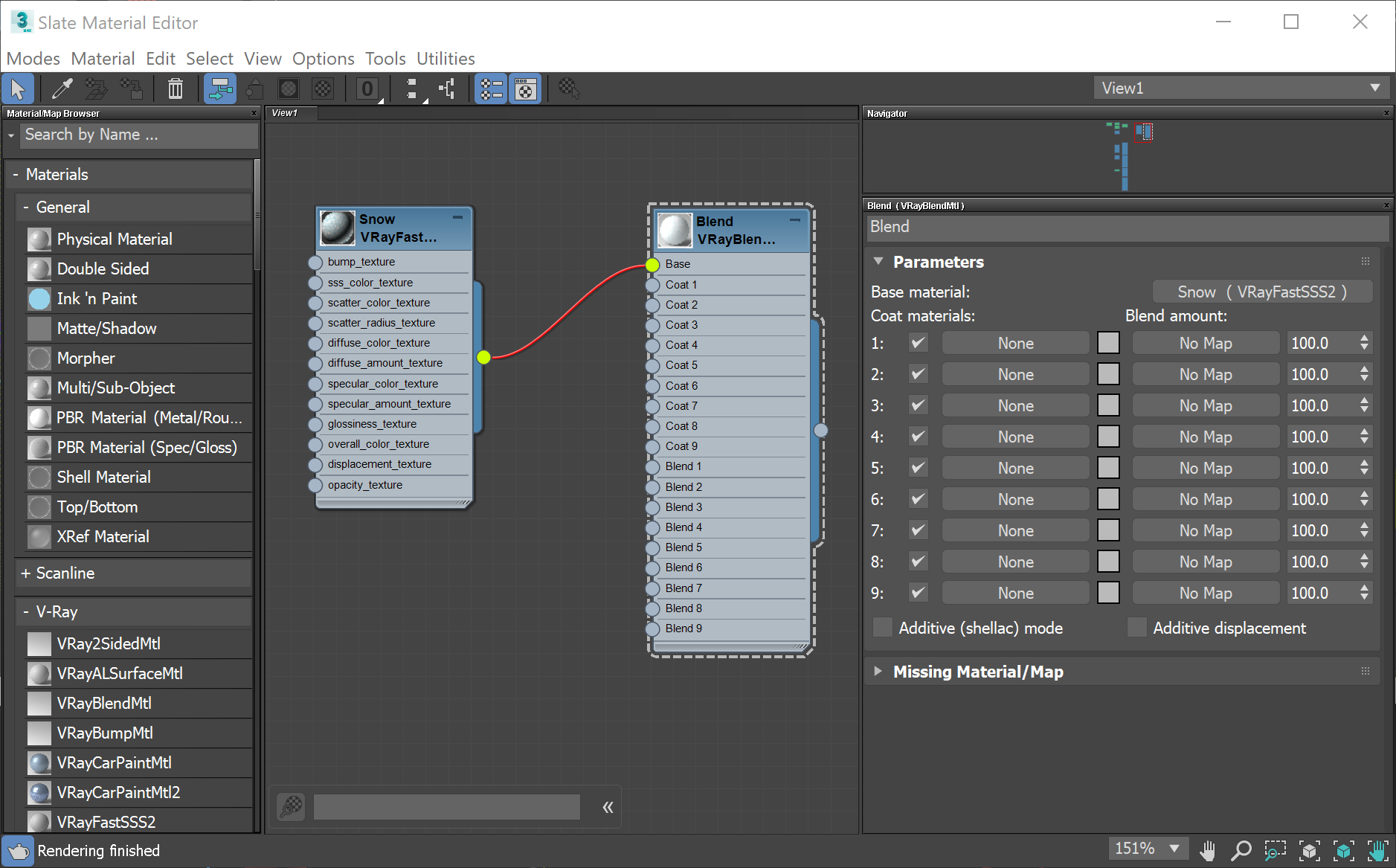

1. Start by opening the Material Editor and creating a VRayFastSSS2 material. Change its name to Snow.
2. Create a VRayBlendMtl material and name it Blend.
3. Connect the Snow to the Base of the Blend material.

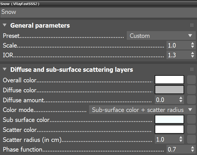

4. Select the Snow material and change the Sub surface color to a light blue (R233,G252, B255).
5. Change the Scatter color to white (R255,G255, B255).
6. Change the Phase function value to 0.7.

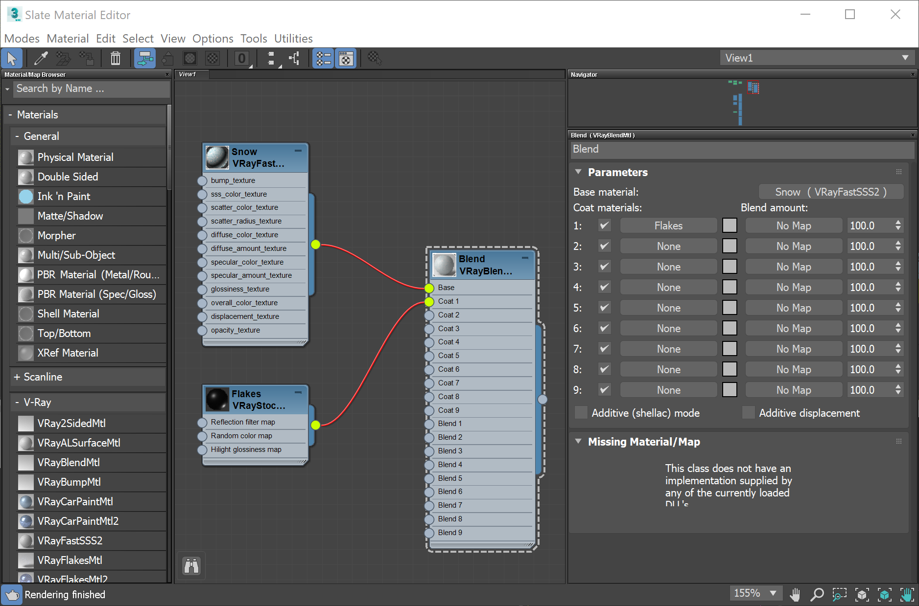

8. Create a VRayStochasticFlakesMtl and name it Flakes.
9. Connect the Flakes material to the Coat 1 slot of the VRayBlendMtl.
