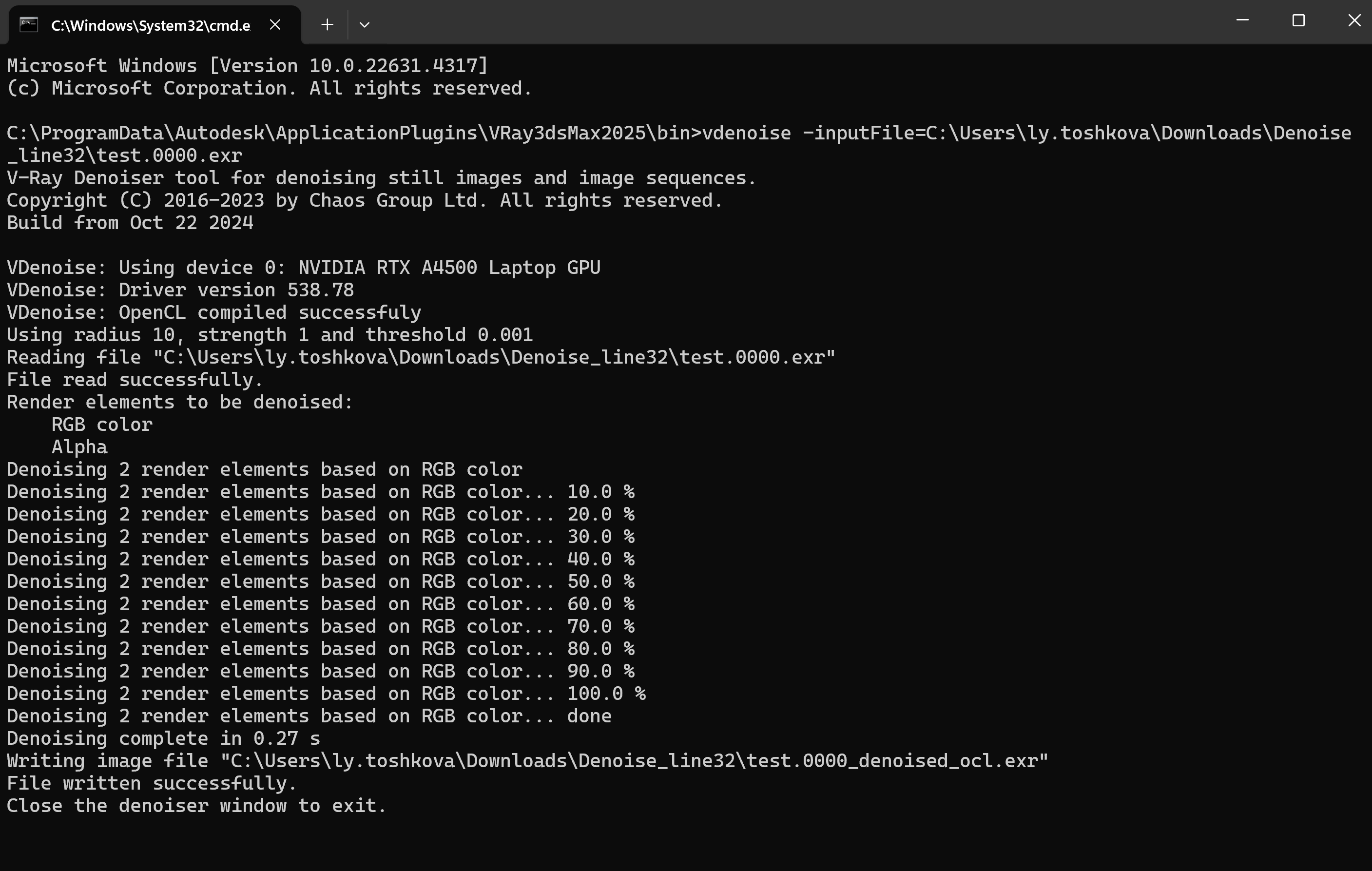

Start the vdenoise executable from:
C:\Program Files\Chaos Group\V-Ray\3ds Max 20xx\bin for V-Ray for 3ds Max 2021 or earlier.
C:\ProgramData\Autodesk\ApplicationPlugins\VRay3dsMax202x\bin for 3ds Max 2022 or later.

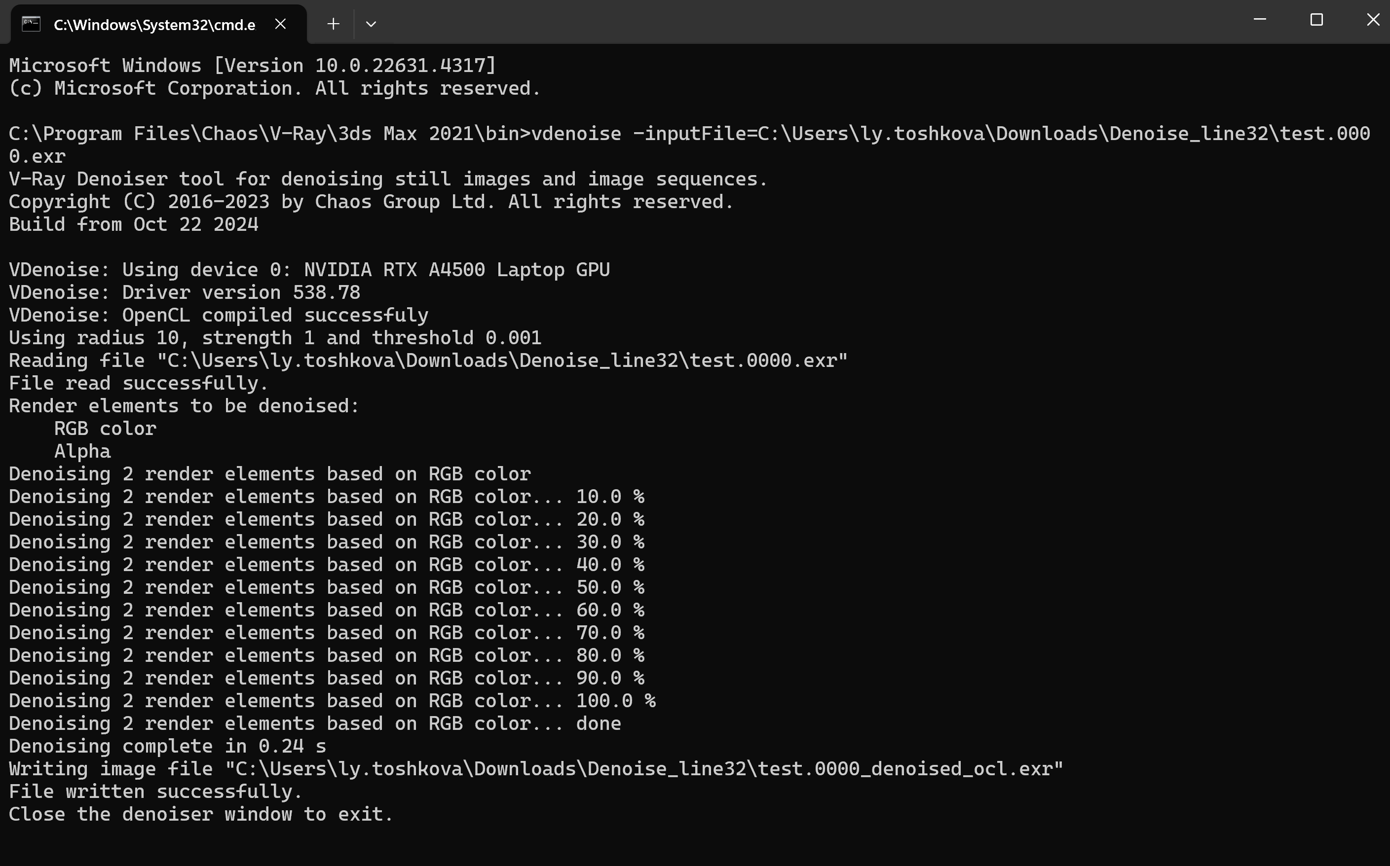

Command Line Usage
The denoiser can also be used as a command-line utility without GUI display. Simply run the executable with one of the following commands to denoise an image or a sequence of images from within your command-line interface. You can also change the settings and behavior of the denoiser through CLI. To do so, please refer to the Denoiser Options tables below for a list of all available options.
Denoising Still Images
To denoise a single .vrimg or .exr image, use the following format for the command:
vdenoise -inputFile="path\to\image.exr"
where path\to\image.ext is the path and file name of the .vrimg or .exr file that you want to denoise.
For example, if the file you want to denoise is called render.exr and is located in the folder c:\renderoutput, the full command will be
vdenoise -inputFile="c:\renderoutput\render.exr"

Output
When the standalone Denoise tool is run, it outputs information about the process, including settings, warnings, progress, and files written in the command prompt window.
