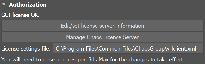

This page provides information on the Authorization rollout under the V-Ray GPU Settings tab.
The Authorization rollout allows you to view and edit your license server information, as well as to manage Chaos License Server. Note that for any change to take effect you need to close and reopen 3ds Max.

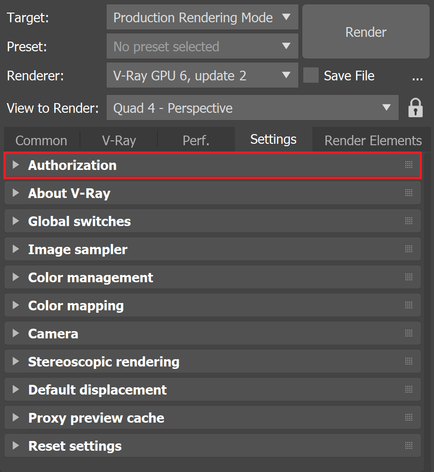

UI Path: ||Render Setup window|| > Settings tab > Authorization rollout (Renderer set to V-Ray GPU)
Edit/set license server information – Opens the Chaos License Settings window where license server information can be viewed and edited.
Manage Chaos License Server – Opens the Chaos License Server where license server settings can be viewed and edited.
