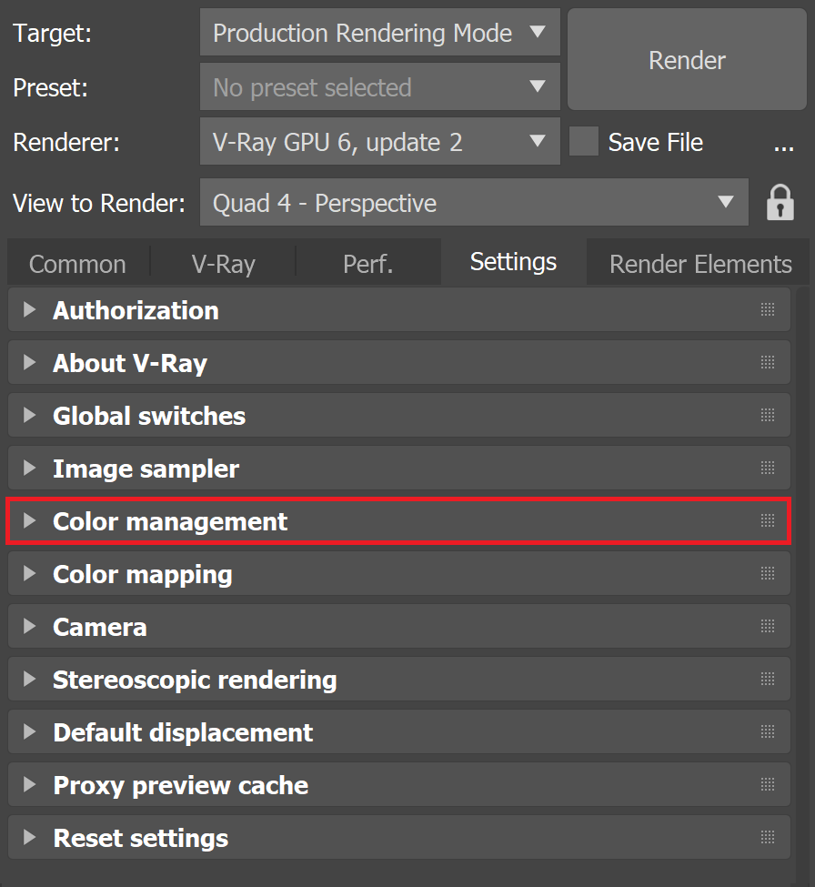

UI Path: ||Render Setup window|| > Settings tab > Color management rollout (Renderer set to V-Ray GPU)

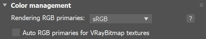

Rendering RGB primaries – Selects a display color space for the rendered image. It is saved as metadata to the vrimg history files and applied in VFB2 when the Display correction of the frame buffer is set to its default sRGB mode.
sRGB – Image is rendered in sRGB color space. This is the color space for most monitors and computer displays.
ACEScg – Image is rendered in ACEScg color space. This color space allows for greater range of color transformations in post. It has a wider gamut of colors than the sRGB linear gamut and should be encoded into a 16 bit floating exr.
Auto RGB primaries for VRayBitmap texturesWhen enabled, automatically sets RGB primaries for the VRayBitmap texture.
