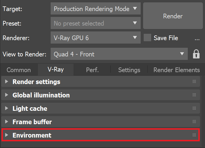

This page provides information on the Environment rollout in the V-Ray tab when V-Ray GPU is used as the production renderer.
The Environment section in V-Ray GPU render is where you can specify a color and a texture map to be used during GI and reflection/refraction calculations. If you don't specify a color/map then the background color and map specified in the 3ds Max Environment dialog will be used by default. The parameters in this rollout override the 3ds Max Environment settings.
UI Path: ||Render Setup window|| > V-Ray tab > Environment rollout (Renderer set to V-Ray GPU)

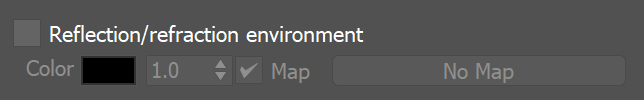

Reflection/Refraction Environment
This group allows you to override the 3ds Max Environment settings when reflections and refractions are calculated. Note that you can also override the reflection/refraction environment on a per material basis (see VRayMtl) or a per map basis. If you do not enable the Refraction override, this group of controls affects both reflections and refractions. If you enable the Refraction override, then this group affects only reflections.
On – When enabled, V-Ray uses the specified Color and Texture during reflection/refraction calculations.
Color – Specifies the environment color for reflections/refractions. The color is ignored if there is an environment texture specified.
Multiplier – A multiplier for the color value. Note that the multiplier does not affect the environment texture (if present). Use an Output map to control the brightness of the environment map, if the map itself does not have brightness controls.
Texture – Allows you to choose an environment texture. Note that if specified, this texture overrides the Color.
