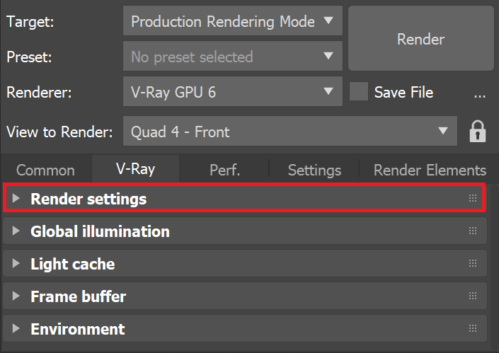

The Render Settings rollout is available under the V-Ray tab when the render engine is V-Ray GPU. It provides options for IPR and Progressive rendering.
UI Path: ||Render Setup window|| > V-Ray tab > Render Settings rollout (Renderer set to V-Ray GPU)

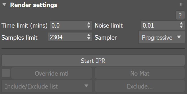

Time limit (mins) – Specifies the maximum time (in minutes) for refining the image.
Noise limit – A threshold that determines when to stop refining a pixel. Higher values allow more noise in the image, while lower values try to reduce the noise. A value of 0.0 traces the entire image unconditionally.
Samples limit – Specifies the maximum samples per pixel for refining the image. V-Ray performs adaptive sampling on the image, trying to put more samples into areas that have more noise.
Sampler – Specifies the image sampler type.
Progressive – Progressively samples the entire image and refines the details over time.
Bucket – Takes a variable number of samples per pixel depending on the difference in the intensity of the pixels.
The Bucket type Sampler is recommended when using multiple (three or more) GPU cards in a setup or when using Distributed Rendering. Note that the Bucket Sampler works only in Production rendering mode, thus if using IPR, it will force the use of the Progressive Sampler.
Start IPR – Starts an interactive GPU render.
Override mtl (enable checkbox) – When enabled, causes all objects in the scene to be rendered with a selected material rather than their assigned materials, but only if an override material is selected. This option does not affect actual material assignments; it only affects the materials as they appear in the GPU rendering.

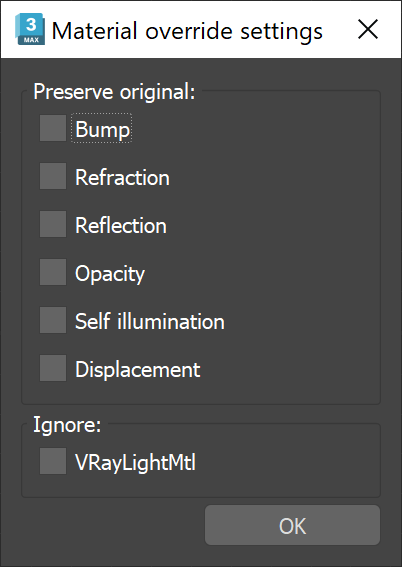

Override mtl – Opens the Override material settings where some materials parameters can be preserved.
Preserve original – Keeps all selected parameters of the VRayMtl(s) in the scene, while overriding everything else.
Ignore VRayLightMtl – Keeps VRayLightMtl(s) in the scene intact.
