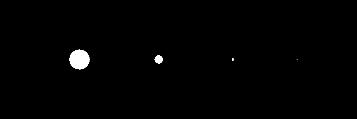

This page provides information on the Lens Effects layer found in the V-Ray Frame Buffer (VFB).

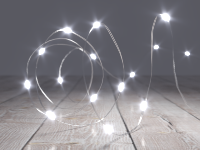

V-Ray Lens Effects simulate real-world camera lens effects such as bloom and glare. The plug-in uses a fast multi-threaded technique to compute the result and provide an immediate update in the VFB. V-Ray Lens Effects are applied in the effectsResult channel together with other post effects executed over the RGB rendered image. Learn more about the V-Ray Lens Effects in the The Lights Touch article.
The V-Ray Lens Effects can also be refined via V-Ray masks. Learn more on the Masks page.
The Lens Effects layer is accessible from the Layers panel in the VFB and becomes active when the lens effects are enabled. It can be blended with the rest of the layers in the VFB.

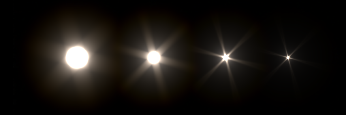

Example: Bloom / Glare
Bloom = 0.0
Streak blur (constant) = 0.20
Bloom = 0.1
Bloom = 0.2
Bloom = 0.3
Bloom = 0.4
Bloom = 0.5
Bloom = 0.6
Bloom = 0.7
Bloom = 0.8
Bloom = 0.9
Bloom = 1.0

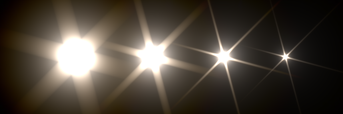

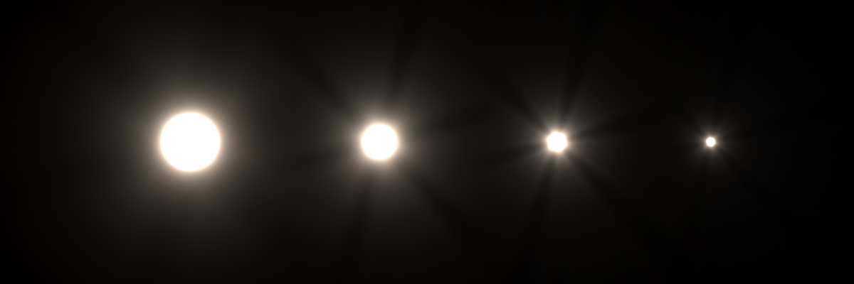

Aperture Shape
Clicking the button displays/hides the parameters of the rollout.

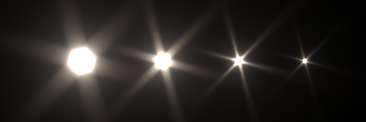

Blades – Enables the Blades effect.
Sides – Sets the custom camera aperture blades number to be considered for the lens effects. This parameter directly controls the number of "rays" of the glare.
Blades rotation  Controls the rotation of the camera aperture and blades.
Streak blur – Determines the width of the angle at which glare rays spread. The larger the value, the wider the spread. If set to 0, rays are directional; if set to 1, glare rays spread out and completely blend together. Observe in the Streak blur example below how values in-between change the glare rays appearance.

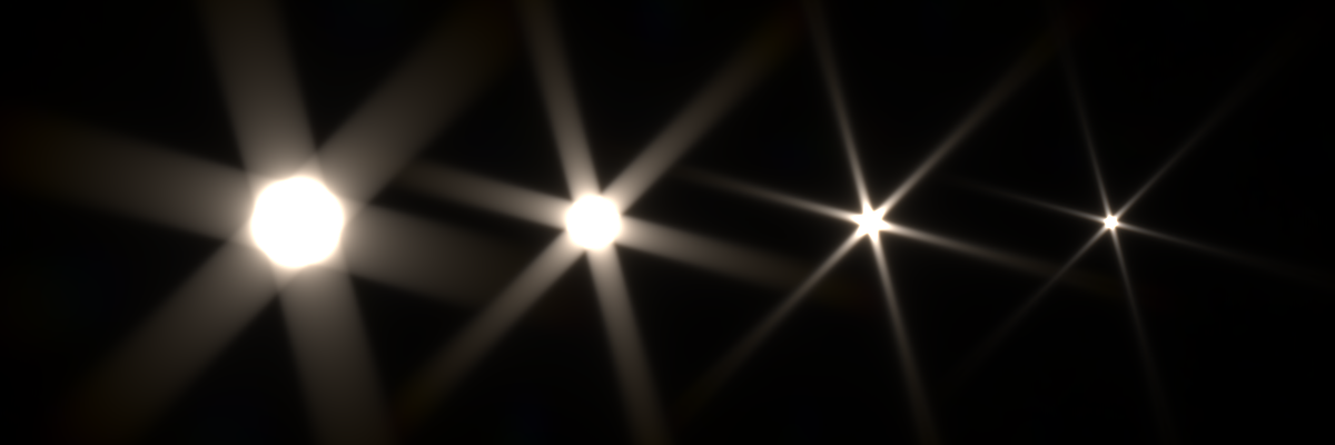

Peripheral grating – Enables grating along the sides of the aperture shape.
Density – Controls the density of the grating effect in percent, where 100 is fully black.
Length – Controls the length of the grate lines.
Zoom – Controls the size of the halo around the lights.
Slope – Controls the direction of the lines.
Strength – Controls the strength of the blades effects.
Occlusion – When enabled, it controls the aperture shape by occluding part of it.
Symmetric – Enables symmetric occlusion of the shape. When disabled, the occlusion appears only on one side of the shape.
Percent – Controls how much of the shape is occluded.
Rotation – Determines the position of the occlusion over the shape by rotation.
Arc – Controls the arc of the occlusion. A value of 0 sets a straight line, while a value of 100 makes an arc.

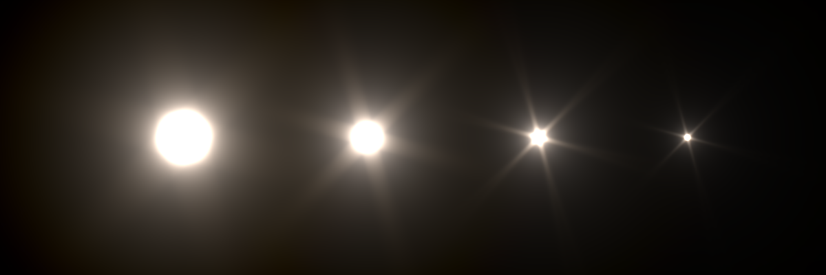

Example: Streak blur
Streak blur = 0.0
Bloom (constant) = 0
Streak blur = 0.1
Streak blur = 0.2
Streak blur = 0.3
Streak blur = 0.4
Streak blur = 0.5
Streak blur = 0.6
Streak blur = 0.7
Streak blur = 0.8
Streak blur = 0.9
Streak blur = 1.0

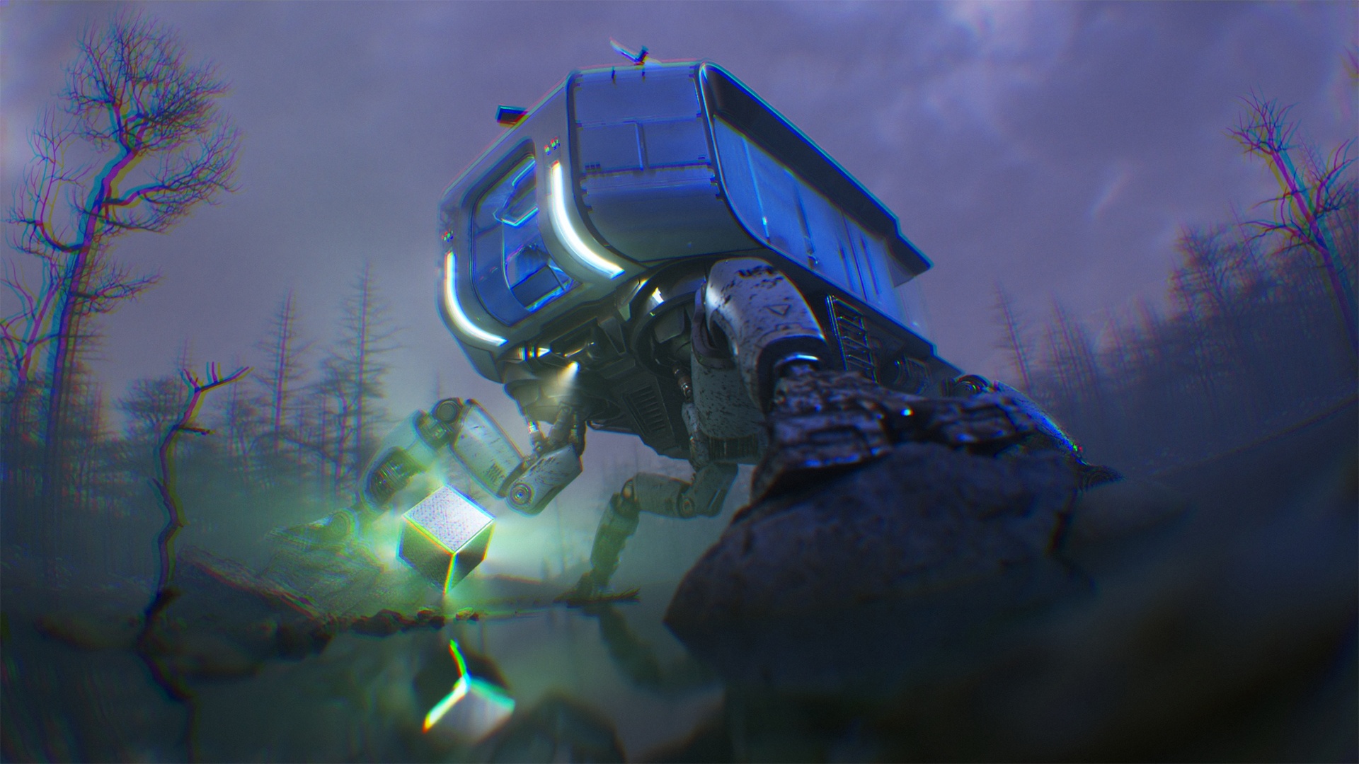

Chromatic Aberration
Chromatic aberration – Enables chromatic aberration, an effect that simulates lens color distortion and gives realism to the render. The chromatic aberration is a phenomenon where the edge of a convex lens splits the white light into different wavelengths onto a sensor of a camera, so the image shows a presence of red and blue light. Mostly visible on the sides of the image.
Strength – Controls the strength of the effect. See the Strength example.
Example: Chromatic Aberration Strength
Depending on the Strength of the chromatic aberration, you can create different looks in your scene. You can imitate the effect of a real camera with subtle aberration, or, if you wish to achieve an artistic effect, consider increasing the Strength parameter, as in the example.
Strength = Off
Strength = 0.25
Strength = 0.5
