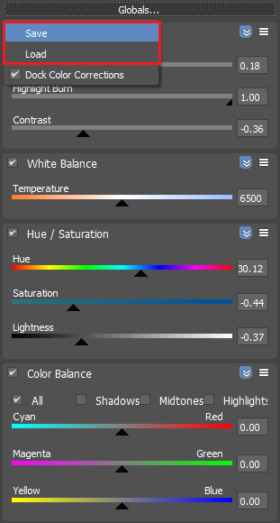

Color corrections can also be saved and applied as a preset. Jobs submitted from 3ds Max will have their color corrections written to the .vrscene file and rendered on the cloud; but if the render output is set to EXR, no color corrections will be written to it since it's a raw image format. In that case it is useful to save your color corrections separately.
Separate color corrections can also be saved and loaded using the
buttons. Once a preset is applied, you can use the Save current channel ( ) button to save the image in the format of your choice.Please note that the VFB has to be opened in 3ds Max at least once in order for the color corrections to be exported and rendered on the cloud.
