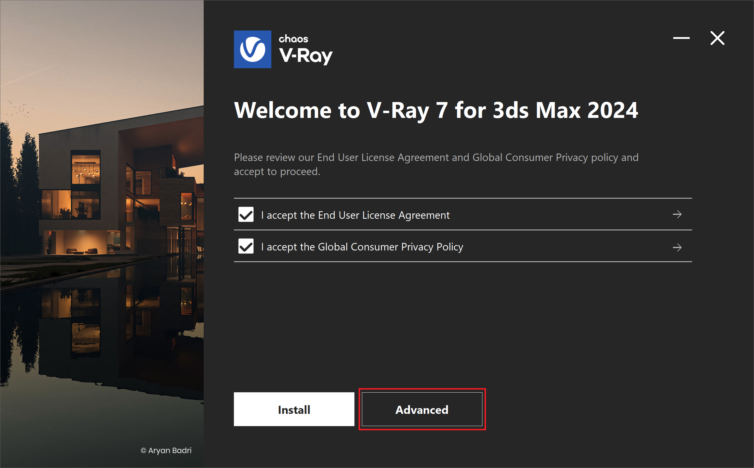

  • Run the V-Ray for 3ds Max installer.
  • Click the Advanced button to access additional options.

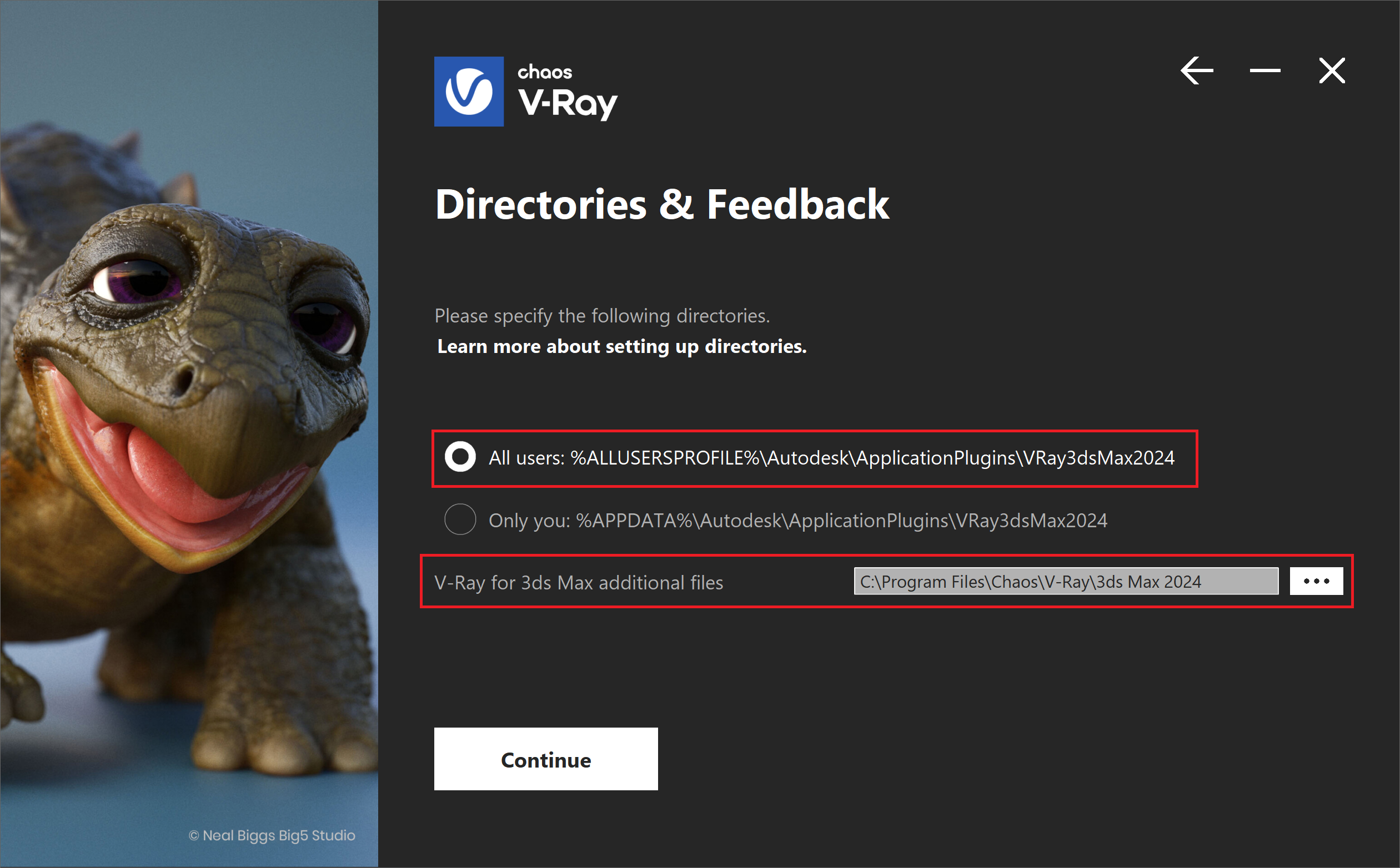

  • At the Directories & Feedback step, select the following options:
  • Complete the installation process. The Autodesk application package of V-Ray for 3ds Max is now installed in a single directory, e.g. if using 3ds Max 2024, the default directory is C:\ProgramData\Autodesk\ApplicationPlugins\VRay3dsMax2024.
