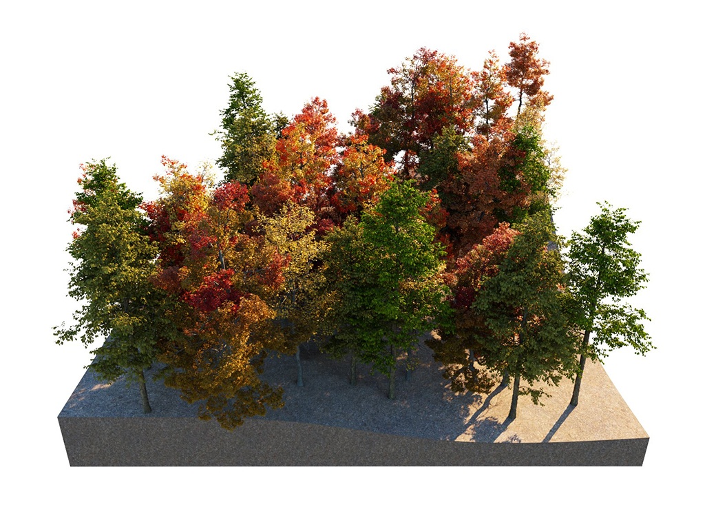

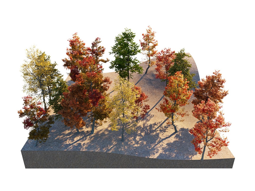

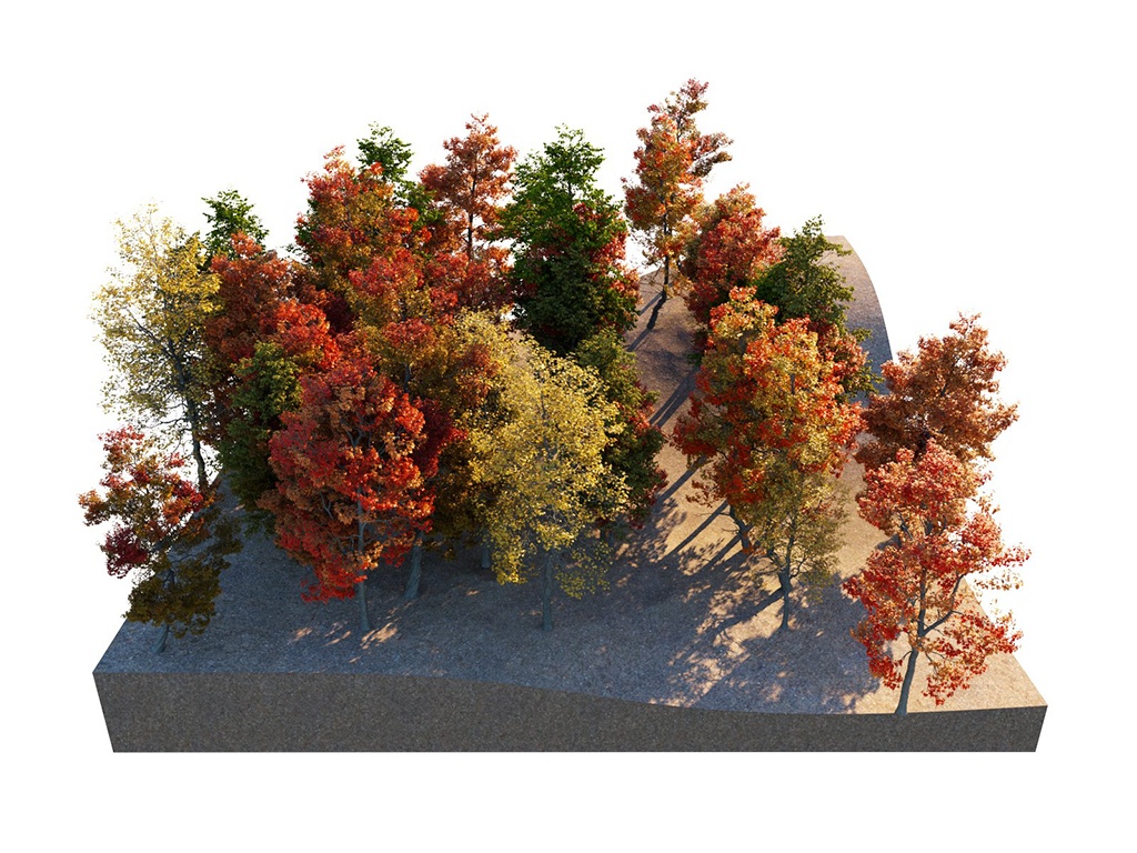

Random seed – Determines the random distribution used. Changing this value causes random permutations of the scattered object(s). When enabled, instances colliding with each other get discarded. See the Random seed example below.

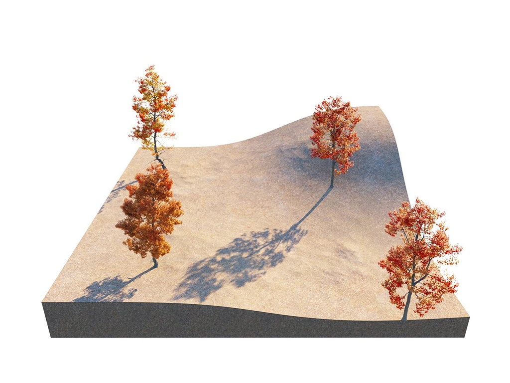

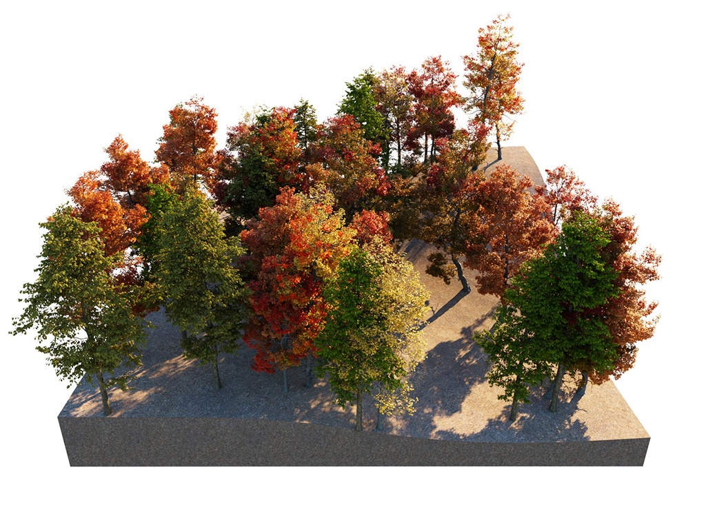

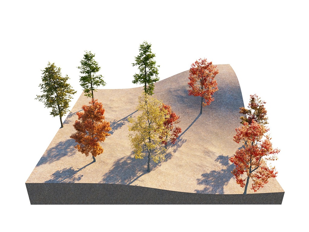

Avoid collisions – When enabled, instances that would collide with each other get discarded. This results in no overlaps between instances. Note that enabling this option might lower the number of instances. When enabled, instances colliding with each other get discarded. See the Avoid collisions example below.
Spacing [%] – Controls the size of the bounding boxes used to detect collisions. Smaller values result in denser instances with some collision, higher values result in larger distances between instances. Values above 100% mean that the distance between objects is larger than their bounding boxes.

Example: Random seed
This example shows the random Scatter seed distribution.
Example: Avoid collisions
This example shows how the Avoid collisions function works. Higher values result in larger distance between instances.
Random seed = 1
Random seed = 2
Random seed = 3
Avoid collisions = Off
Avoid collisions = On; Spacing [%] = 50
Avoid collisions = On; Spacing [%] = 100
