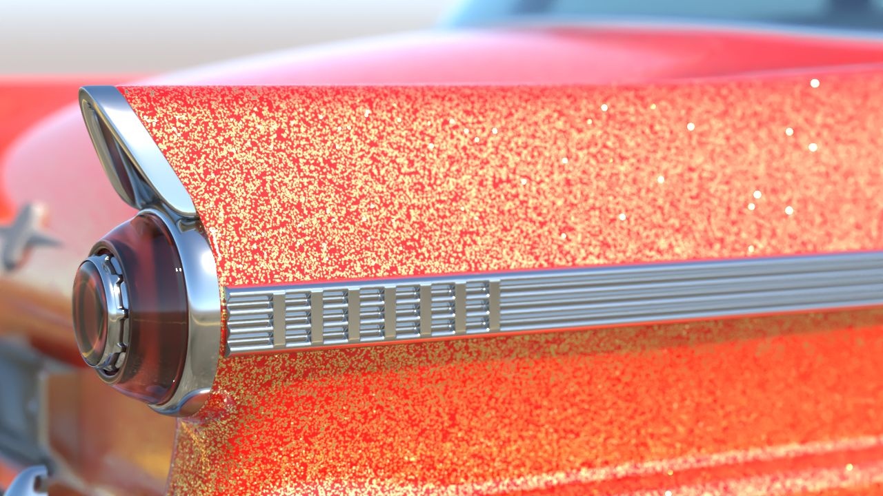

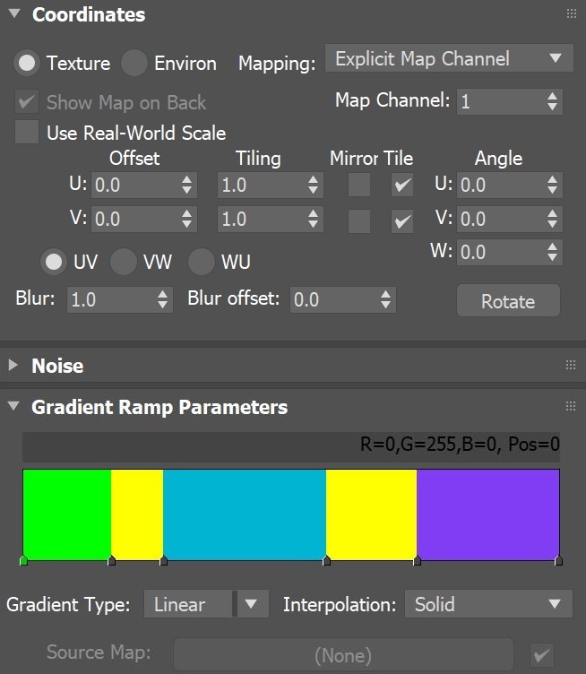

Example: Flake Random Color
This example shows the Flake Random Color parameter used with a Gradient Ramp map with five randomly set colors and Interpolation set to Solid. Flake Density is set to 7; Flake Size is set to 0.5; Flake Scale is set to 0.5; Flake Color is set to white (255,255,255).

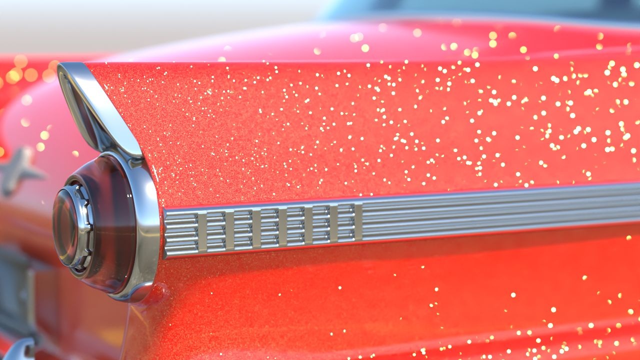

Example: Flake Orientation
This example shows the Flake Orientation parameter. Note how lower values produce flakes more aligned with the surface normal, so that light is reflected more uniformly. Higher values produce more random flakes leading to more variation in the flake illumination. For this example, Flake Scale is set to 0,3cm, Flake Size to 0.5, Flake Density to 3 and Flake Orientation Tail is set to 2.
Flake Orientation = 0
Flake Orientation = 0.05
Flake Orientation = 0.1
Flake Orientation = 0.3
Flake Orientation = 0.5
Flake Orientation = 1

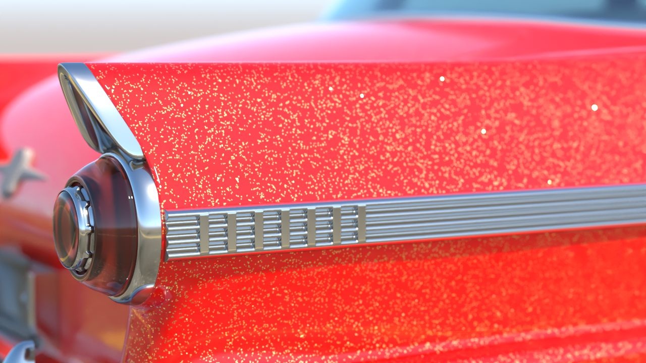

Example: Flake Density
This example shows the effect of the Flake density parameter. Note how larger values produce more flakes, but do not change the flake size. For this example, Flake Scale is set to 0.3cm, Flake Size is set to 0.4 and Flake Orientation is set to 0.1.
Flake Density = 0.5
Flake Density = 1
Flake Density = 3
Flake Density = 5
Flake Density = 7
0.5
7

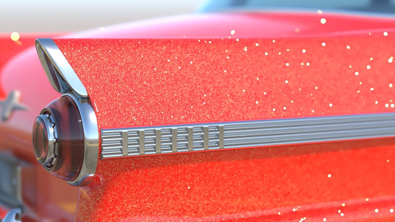

Example: Flake Scale
This example shows the effect of the Flake scale parameter. Note how lower values scale the entire flake structure. For this example, Flake Density is set to 6, Flake Size is set to 0.2 and Flake Orientation is set to 0.1.
Flake Scale = 0.1
Flake Scale = 0.25
Flake Scale = 0.5
Flake Scale = 0.75
Flake Scale = 1
Flake Scale = 1.5
Flake Scale = 2
0.1
2

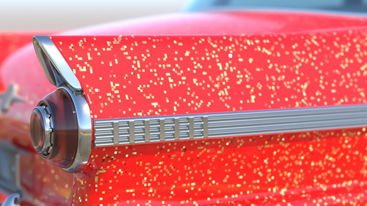

Example: Flake Size
This example shows the effect of the Flake size parameter. Note how larger values make the individual flakes larger, but do not change their count. For this example, Flake Density is set to 3.0, Flake Orientation is set to 0.1 and Flake Scale is set to 1, the default value.
Flake Size = 0.1
Flake Size = 0.25
Flake Size = 0.5
Flake Size = 0.75
0.1
0.75

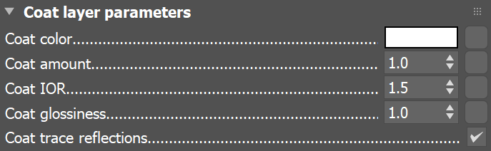

Coat Layer
Coat color – Specifies the color or map of the coat layer.
Coat amount – Specifies the thickness amount of the coat layer. A value of 0 does not add a coat layer, while higher values blend the coat gradually.
Coat ior – Specifies the Index of Refraction for the coat layer.
Coat glossiness – Specifies the glossiness value or map of the coat reflections.
Coat trace reflections – When disabled, the clear coat only produces specular highlights, but no actual reflections.

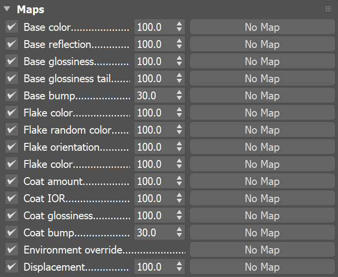

Maps
This rollout provides additional control to the different texture maps for the various parameters of the material. Some maps are only exposed here and are not accessible from the parameters section.
Base bump – Specifies the bump map for the base layer.
Coat bump – Specifies the bump map for the coat layer.
Environment override  Specifies a map for environment override.
Displacement  Specifies a map for displacement.
