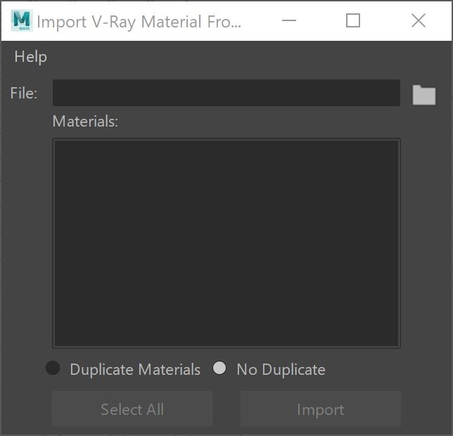

File – Shows the filename and path of the vrscene file selected for import.
(Open/Browse window) – Traditional folder icon button used to select the vrscene file to load into the importer window.
Materials – A list of all V-Ray materials found in the loaded vrscene file that can be imported.
Duplicate Materials – Additional copies of selected materials will be imported into the scene if they already exist.
No Duplicate – If a selected material is already present in the scene, an additional copy will not be imported. Only new materials to the scene will be imported with this option.
Select All button – Highlights all materials listed in the Materials section of the importer window.
Import button – Activates the importing process to bring in selected materials.
